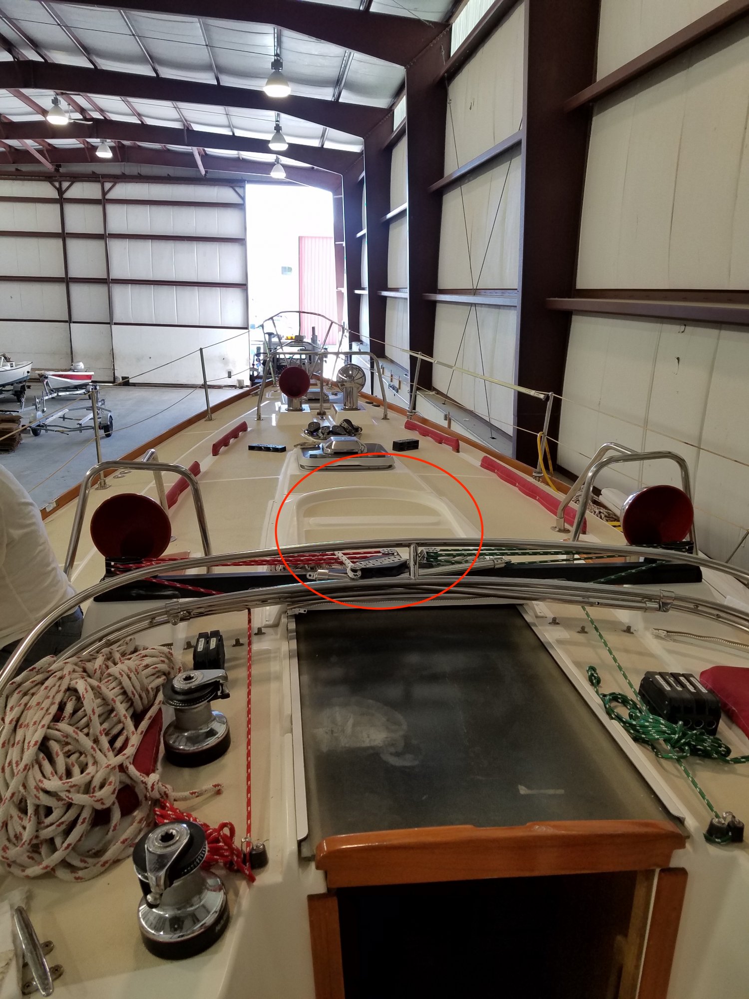

Hey @Sean K are you on your boat during the week? Mine won't launch 'til Friday, and I wish I had measured and recorded the measurements of that feature that's molded into the sea hood, that looks like the place you'd put a life raft capsule. I'd like to put a small solar panel there, just to keep my batts topped up during the week. If you're there during the week could you please measure it for me?

I’d be glad to do so as I hope to sail tomorrow, Wednesday. Please be more specific on which measurement you’d like. I assume it’s the top of the deck. Is it forward of the mast or behind and what type of boom vang do you have - will there be clearance? Maybe approximate the canister size so I can see where it may fit best. Just let me know, and I can figure out how to add a picture to this I’ll do that too.

Or, are you talking about the hard fixed area above the sliding top down to the cabin, on a second read of your post I’m thinking that’s it.

Thanks Sean!
Yes, that's it, the fiberglass cover for the sliding hatch. There's a recess with a rounded portion forward, and rectangular area, and I thought I'd drop a small solar panel in there and even screw it down.
Here's the best pic I have of it. I circled the area in red.

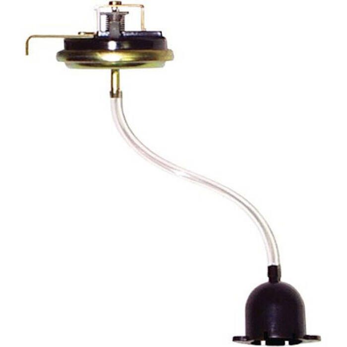

I'm also surprised there is no high-water alarm (to be added).
Did you ever do this?
I have a "new" bilge pump switch that I bought several years ago and haven't installed yet. It's a Groco AS-100, here:
I got it to get as much wire out of the bilge as possible, as I have an electrolysis problem that eats my zincs in less than a year. It works on pressure of the rising water.

Jviss
I’ve taken the measurements of the hard sliding companionway cover you have circled in red. Mine looks identical to yours. The cover is not symetrical and as you know has a rising curved front edge. The Traveller is attached to the rearmost edge.
The outside to outside rear width at the rear (in front of the Traveller) is 27.5”. The total length is 37.5” including the front curved part. From the rear edge to the beginning of the curved part in front is 30” (back to beginning of front curve). As you can see from the pictures there is a raised edge around the entire platform, but it is not symmetrical either. At the rear most edge the raised edge is 2.25” wide and it tapers down to 1.5” wide where the front curve begins. As you also know there are two raised bars within the platform, the rear one is 18” X 3.25” and the forward one is 17 X 3.25”.
So if it was square it would round up to be 27.5 X 37.5 inches total; and the part that excludes the curved front is 27.5 X 30 inches. The raised border is less than 1/2 inch high from the back to the beginning of the front curve. The front curve raises to about 4 inches.

Hi @Sean K , thanks very much for the thorough measuring job. I'm having a little trouble parsing it all. For example, what would be the maximum dimensions of a rectangle that would drop into the recessed part?

OK, For the width Subtract 2.25 from 27.5, for 25.25 inches inside the raised edge and 30 minus 2.25 for the length or 27.75 inches, So 27.75 long and 25.25 wide. This is the inside dimension where I subtract the width of the raised edge from the total width. The length is limited by the front curve which begins 30” from the rear edge (traveler) And has a 7” radius at it’s peak.
Glad to help, let me know if you need more.
This solar panel would be partially covered by the boom and sail bag. If you have A Bimini top you should consider putting a soft solar panel on top of it. Larger panel and less obstruction of the sun. No?
Thanks Sean. Does that inside dimension, 27.75x25.25" exclude the curved portion? (That's what I'm looking for.)
Yes, I know it's sub-optimal as a place for a solar panel, and I have bimini-top panels in mind for the future. But I just want something quick and dirty and inexpensive for this year, and not to live off of, but just keep them topped up during the week.

Yes, the inside dimension without going into the curved front section is 27.25 long and 25.25 wide. Please note that the raised edge is only about 1/2 inch high above the inside and the inside does have two raised bars of the same height, so mounting inside the raised edge would be almost level with the raised perimeter edge, not below it (approximately). I’m not familiar with the dimensions of solar panels so it’s impossible for me to recommend anything.
