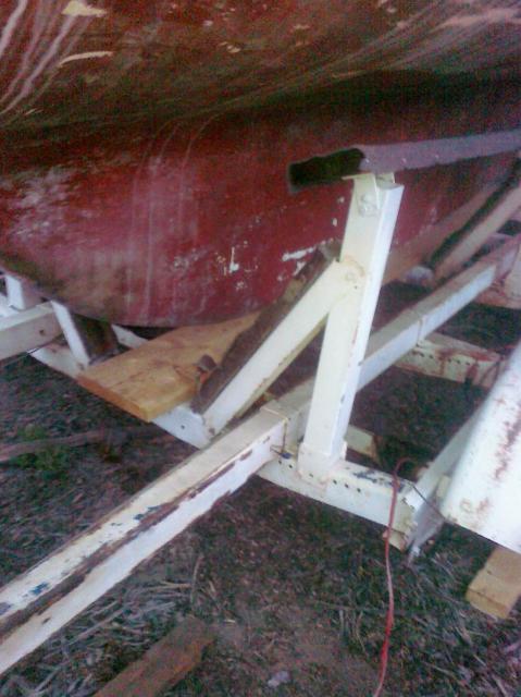

Hiee,
More and more questions. On the other hand I have never had a trailerable sailboat before :confused:.
Firstly. l intend to install a fixed vhf and mast mount the ant. for maximum range. I can see a time when this boat will be crossing the gulf of maine and the florida straights :). I know that there are waterproof electrical connectors?(water resistant maybe) for masthead lights. What I am curious about is if there is a waterproof connector for the vhf ant cable. I will be bringing the mast wiring out beside the mast step and thru a short goose neck and leaving 12'' of wire/ant lead for connection to the feeds coming down from the masthead.
Secondly. This is a trailer boat and likely will NOT be moored during the season. What are the thoughts on using a 2 part expoxy tinted to do the bottom coat? I am thinking of using 2 coats.
The previous owners did a lousy job of maint and just seemed to slap one coat of paint on after another, what a mess. In short I think I will use sandblasting to peel it off. Before anyone freaks let me say that I have sandblasted in the past but not on fibreglass.

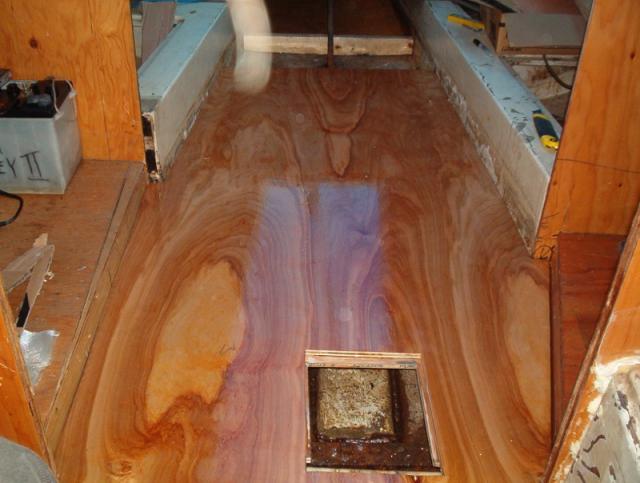

Thirdly. The house bank will consist of 2 100 amphour batteries located at the aft of the cabin sole and right under the cabin hatchway weight about 90 lbs. This places them about 3 feet aft of the external keel box and centered on the keel. I am thinking of installing at least a 10 gallon water tank under the forward v berth weight 100lbs(when filled). This will be about 4 feet forward of the external keel box and again centered on the keel. Does the balancing seem right? and yes I am aware that the batteries are a constant weight and yet the water weight will diminish in time as it is used up.
We are trying to set this boat up for crusing and are not concerned about trying to get top speed out of her, but also we don't wish to degrade her speed to any great deal.
Merry Christmas all and Happy Sailing :)

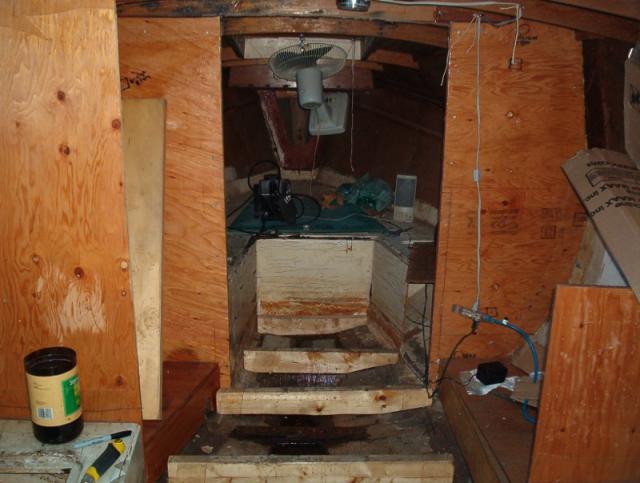

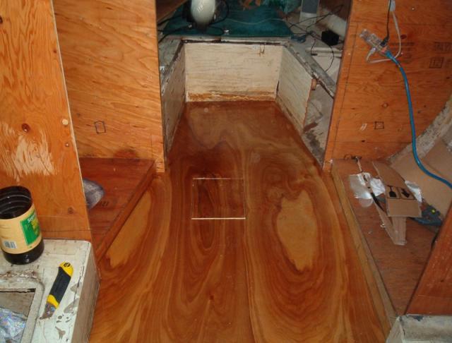

PS in the attatched pics looking aft the batteries will set on the finished sole setting perpendicular to the centerline one on each side of the swingkeel cable tube.
PSS the water tank is to go into the storage directly in front of the forward end of the cabin sole and will be turned so that its length is perpendicular to the centerline.

One last thing. I can't see how the mast forces are carried down to the keel on that boat. There has to be something there structurally to do that and it might just be the beams in the ceiling carrying the load over to the hull sides and down or maybe it is in some of those bulkheads. Where ever it is be sure that you don't compromise that in the changes. There are large loads under the foot of the mast and they have to be taken care of in some manner. I just couldn't tell how from the pictures you've taken.

Your post was informative as always. The forward bulkhead just aft of the v-berth use to consist of 2 compression posts with a 1/4'' ply panel fitted between them and the hull cabin side and deck etc. I have replaced that with 2 - 1/2'' lamenated solid plywood bulkheads as shown the mast step being just fore of the bulkhead. The attachment shows what I am trying to describe. They are glassed in all round as well 6'' cloth tape and 10 oz weight. The forward most bulkhead forming our anchor storage. We have 6' 4'' on each side of the v-berth for length which is OK for me but a bit snug for Sasha. I will be keeping the head to port and aft of the v-berth as it is. I would like to have used a Sealand 975 but the extra height just made it to cramped for the extra holding capacity. So we will go with the smaller unit. In time I will be adding a 'Y' divertor and mercinator (sp) pump with seacock so we can pump out at sea if need be. The galley is mostly opposite the head to starboard at present. This configuration though puts it ahead of the companion way when fully open and therefor only 46'' of head room. I really think that I will move it aft where the starboard quarter berth is and use the old space for .... not really sure at the moment but perhaps the nav station. The propane storage is not a real issue with the thru hull as the platform will be some inches above the water line and of course completely sealed off from the rest of the boat. The tank for the outboard sits to the port side and a 5 gal jerry can of extra gas more or less in the center of that aft most locker behind the cockpit.

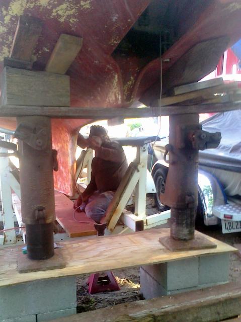

I would strongly urge you to not sandblast. It will very rapidly remove material and in all likelyhood will remove gelcoat material. If there is any barrier coat material it will certainly remove it.
After having done 2 complete bottom paint removal jobs, one 22 foot and one a 38 foot full keel boat, I found an orbital sander my prefered method. Many have used paint strippers with great results and it is faster. My body can't be around stripper chemicals so I sand.
Do not use a belt sander as it will also cut into the gelcoat before you can stop it.

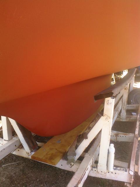

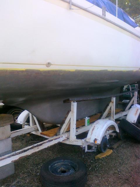

I all likely hood we will use an orbital sander. We have already spent 6 weeks sanding the hull above the water line getting it ready for painting. We still have about 2 feet to go on each side at the bow to have it finished. There were 5 different colors that we had to sand thru. The bottom will be worse due to location lol, even on the cradle we will not be able to stand up underneath and likely will have to lay on our backs to do it. After a long rest over the winter though then I suppose I will be ready to tackle it with a sander once again.
For the most part our boat will be on the trailer and at home when not sailing. A lot of what I have been reading says that anti fouling paints loose their abilities if taken out of the water and so it seems silly to waste the extra money on them. That is why I have been considering a 2 part expoxy as they are quite tough and should be able to handle the rollers on the trailer.

You are probably tired of hearing suggestions from me, but I'll weigh in on the painting deal.
If you are going to paint the bottom why not use a paint that has been developed for that application? Paint companies spend tons of money on developing paint for different situations. If you are assure that you never want to stay in the water for more than a week maybe go with a topside paint, but why limit yourself? I'm not talking about bottom paint to prohibit growth, but something to protect the boat from blistering. A barrier coat that is designed to prevent or lower the chances for blistering like Sea Hawk's Tuff Stuff or one of the Interlux products or Petit's. For less than $150 we were able to put on a barrier coat. If you get blisters then you have a whole lot of work cut out for you in the future.
If you don't have blisters now to deal with and you go sanding the bottom paint off that is on there and get into the gel coat, and you will, then you have opened it and the chances of blistering will go up.
For a bottom paint to protect against growth and slime we used Cukote Biocide Plus....
http://www.bottompaintstore.com/Cukote-Biocide-Plus-Self-Polishing-Bottom-Paint-GL-3500-GL.htm
....that is designed to work on trailered boats. I wondered if it was going to rub off on the bunks on the 2200 mile trip to Florida, especially since I had just painted about a week before the trip. It didn't and looked great....
....and seemed to work great. There are a number of bottom paints that are meant to be used on a trailer boat. Petit's Vivid is one if you want a glossier look.
We took the boat out of the water a week ago and we were in the water just a little under a month and already had barnacles starting to grow on brackets, but none on the bottom.
Like I said the bottom paint is going to be a personal decision, but doing all of the work you are doing why not put on a barrier paint designed for that application?
On stripping the boat. I have to admire you for doing what you have with an orbital sander, but consider doing the rest with something that is a little more aggressive and a lot less work. I did the bottom on our boat...
...in a day with a DA (dual action) sander, but I didn't have to remove paint only sand the whole bottom with 80 grit so that the Tuff Stuff could attach itself with a mechanical bond. Unless you have a good (fairly expensive) air compressor the DA is out but there are alternatives.
If I didn't have the DA I would use a sander/buffer. I have a...
http://compare.ebay.com/like/260497...fc883a9&itemid=260497234958&ff4=263602_304662
.... Makita that isn't cheap, but there are cheap knockoffs out there. What you want is something with a good variable speed so that you can control how fast you are taking material off. There again I just couldn't imagine doing the whole job with an orbital.
If it helps here is a link to when I did the bottom....
http://purplesagetradingpost.com/sumner/macgregor2/outside-39.html
Good luck,
Sum

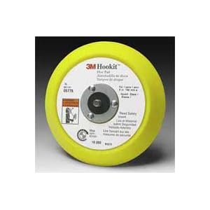

Did you try a foam pad like this....
http://www.amazon.com/Hookit-Foam-Body-Pad-6/dp/B000JTKSQ8
The one above has a tapered edge for contoured surfaces. I use one similar on the air DA with the stick on disks....
