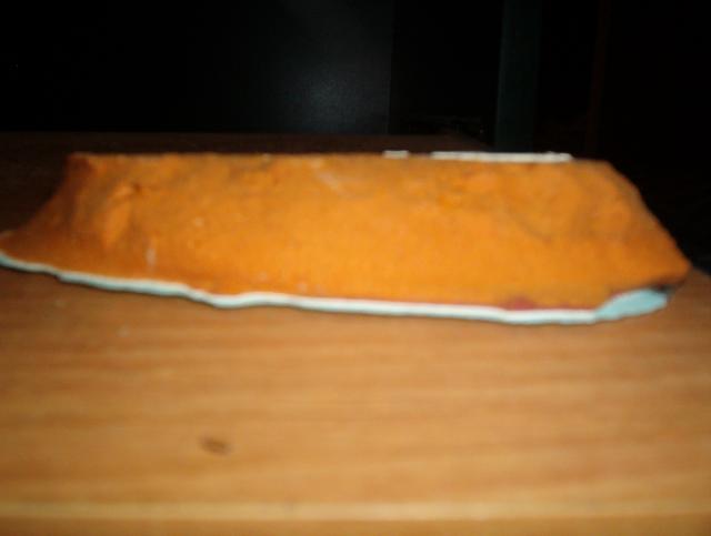

Dec 20, 2010
294
Yankee Condore 21 Halifax
Hiee All,
Firstly thanks again for all the wonderful answers to my many questions. They have helped in so many ways :).
Now for my new question does anyone recognize what this material is in the attachment photo?
The bow of our boat has been covered in it both port and starboard and it seems to run aft from the stem about 2 feet or so and gets thiner as it does. The actual FRP is in tack with nary a sign of any damage ie broken matt etc so I am wondering if it was used to fair out the bow?? It runs from the gunwhale to the waterline also. There were/are cracks on both sides to the bow in this stuff that I need to repair.
The piece in the photo's is about 5/8'' thick. Originally I was going to fill the damaged area with cut strand fibreglas and resin but have been wondering about making my own filler with polyesther resin and microballs. In either case layering the repair gradually. I have no idea as to how the damage occured but suspect the the bow sprit was put into a piling while docking or the boat suddenly lurched forward on the trailer for some unknown reason.
Any how thanks in advance.
