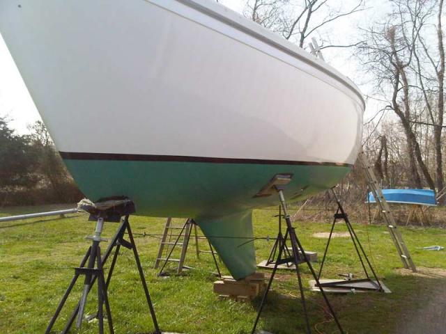

Hey BillyK! Refit is going well. I got the boat in the water finally. She sails great!
Jodtekno - I just did the keel stud as well as new lag bolts. It was a huge pain in the a$$!! Underneath the first layer of glass and wood was a really hard layer of a gray material. It was harder than concrete! I tried just about every tool I had in my arsenal to remove it easily. A hammer and wood chisel was the most effective...but took forever.
To make matters worse, the layers in the keel stud went as follows - glass, wood, gray stuff, wood, gray stuff, glass, lead. I ended up digging down about 4 inches. Not fun!!
