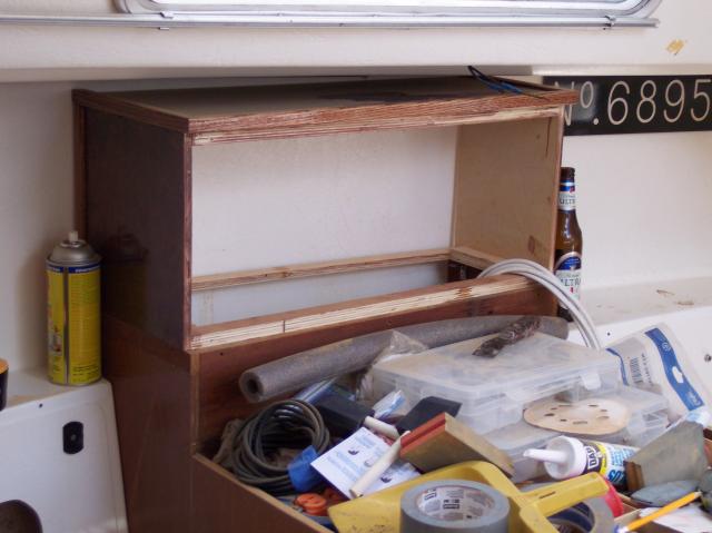

The rewiring project didn't really go through one avenue on the boat.
All of the fore wiring (head lights, fore cabin lights, and AC power outlets ran behind the seats to the nav table. I 5200'd blocks of wood against the hull and fastened the runs on these.
The wiring from the galley lights, overhead lights, LED strips under the shelves, and all of the wiring from the cockpit, mast and running lights ran through the galley, past the gas tank into the nav table.
So the nav table became the new terminal for all the wiring. I built a new panel station that fits above the nav table.
The original table had the flat horizontal lift top. The back had the original fiddles and a little panel that I could lift up. Inside the PO had created a setup that allowed him to place 3 citronella candles in there...strang. I included some before, during and after pics.
I used the Blue Seas AC panel, battery switch and DC panel along with the old auto bilge pump switch and a monitor for the Xantrex battery charger.
Good luck. I'm pretty happy with it so far and we'll see if all my crimps and wiring hold up!

if your boat is like mine - i have a 91 - i put a fiddle at the bottom of the empty space below the nav table and now have a decent size bookhelf.
