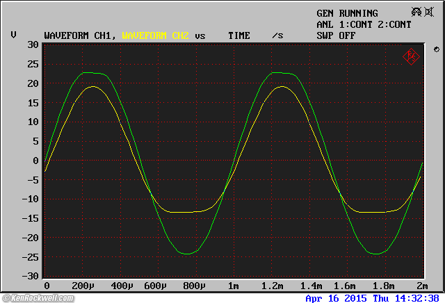

Rounded clipping waveform. Voltage over time. McIntosh MC240 tube amp. Happy?? ;^)

Two things about that.. you could have a solid state amplifier show a waveform like that simply by band limiting. For example, if whatever signal that goes to the speakers is rolled off at just past 20 Khz, you will never see a square pulse - because the harmonics to produce a square pulse essentially go to infinity. Every amplifer setup (tube or solid state) is band limited and there is no reason for them not to be since we cant hear above some range. Also, at that level of clipping (like in that waveform), everyone would be able to hear it and think it sounded awful, not sure it matters.
FYI, the way to generate ODD harmonics ONLY is with a triangle wave. Solid state amps dont distort this way.
