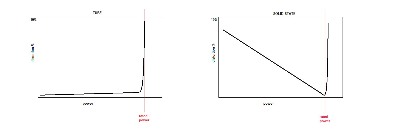

THE DIFFERENCE: DISTORTION
Tube amplifiers have a very different distortion curve when compared with Solid State amps. That is a fact, yet due to the way that the CEA allows manufacturers to publish specs, Solid State amps can publish EXTREMELY low distortion specs; WAY LOWER than Tube.....
Understand the lowest distortion operation of a solid state amplifier is just under full power. That is not where most of us, (me included) listen to music. If you were to set your 50 watt per channel SOLID STATE sound system to a normal (adult, no bourbon) listening level and measured the AC voltage going to the speakers, the math would tell you that you are only using 4 to 7 Watts. Take a look at these two comparison curves, which represent typical distortion curves, shown from zero power to rated power:
I picked 10% arbitrarily, but I don't think I am too far off. So say with the Solid State amp, you are listening somewhere in the left-most 10% of the graph above. What is the distortion? Lots.
Go look at the left curve, for the Tube Amp. Notice the curve in the left-most 10% of the chart is basically zero, or close to it. At normal listening levels a tube amp will deliver much lower distortion when compared with solid state.
The other thing is this. Sold State amps, when taken beyond full power have odd-order harmonics as a component of the distortion. That is like hitting the white E key on a piano and then hitting the white F key right next to it. YUK! A tube amp has even-order harmonics as a function of their distortion. That is like hitting the White C key on a piano and then hitting the E key. You can consider that the distortion from a tube amp is harmonious with the original program material, and therefore the distortion that happens above rated power is less noticeable.

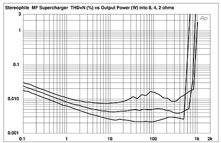

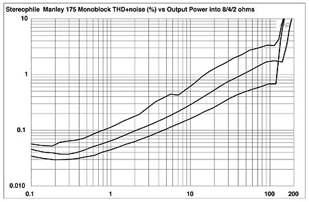

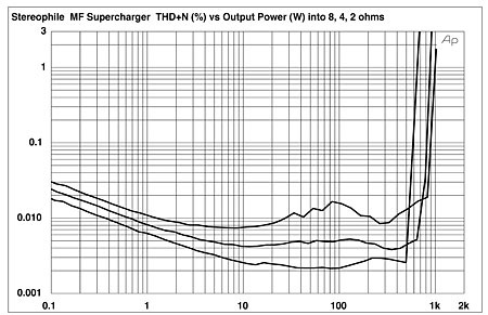

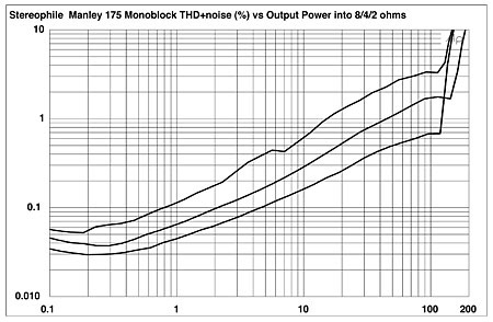

I drew the curves, from memory, representative of easy found published performance curves.
Here is a tube amp THD+noise va power curve from this tube amp test:
http://www.stereophile.com/content/...er-amplifier-measurements#e8ECFOMcDjTKxx4x.97
Here is a similar curve, same source, yet for a solid state amp tested here: http://www.stereophile.com/content/...er-amplifier-measurements#F1YP8oyIPz4PTFDL.97
That looks more like real-world applications.

Yeah, without citing specific brands an models for a direct comparison, the two curves I drew spoke in very general terms. You have to agree though that the comparison based on shape of curves is generally representative...
I'm not sure I do. What you drew is simply not true for consumers and therefore misleading. I'd be interested in seeing a consumer HiFi stereo amp that has a THD/power relationship like the one you drew. My experience says they look like the actual plot you posted later, or like the one below. Basically flat until you hit rated power, then through the roof.
