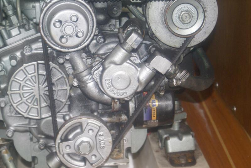

Picture 1 shows the Sherwood on my M-25XPB. If you look directly under the pump you can see the evidence of it leaking.

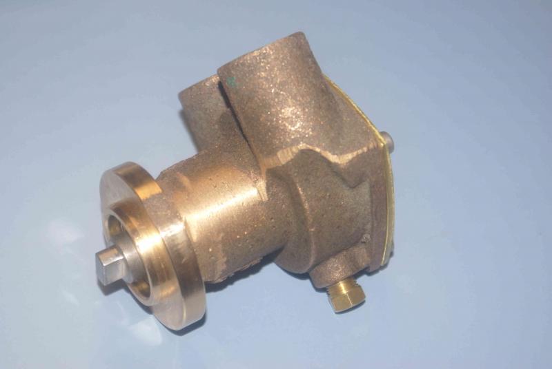

Picture 2 shows my new, just out of the box, Oberdorfer N202M-908. Note the absence of a flange. On the far right is one of the four bolts one extracts to remove the cover plate of the impeller. Easy access!!! Lubricate the impeller before first use. You will be glad you did!

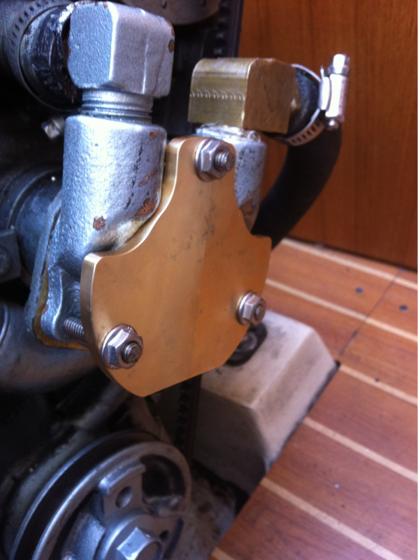

Picture 3 is a close up of one of the clamps holding the Sherwood on my M-25XPB. Note the absence of a flange.

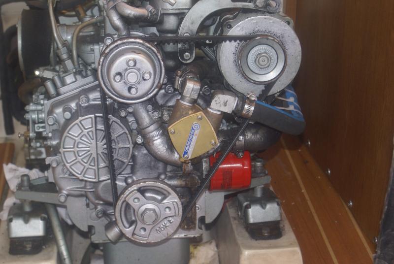

Picture 4 is the installed Oberdorfer.
