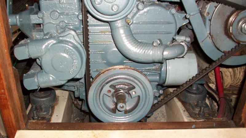

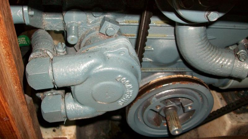

Ok, finally took a couple of pics of the Sherwood pump on my -25XPA. I'm hoping the -16 pump will bolt right up without cutting/hacking/grinding.
Am I correct?
Am I correct?
Good news! That looks great. You should have no trouble with installing an Oberdorfer. Even if you have to grind an edge or match a bolt hole pattern. All the info you need you already have (or it's here on this 'site).
