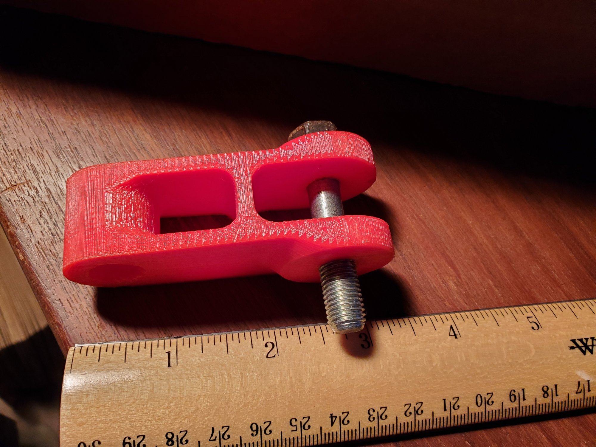

Material properties are always important but you might be surprised by how strong 3D printed parts can be. I was playing around and designed this shackle. Trying to verify my load calculations I printed it in basic PLA. I set up a load tester using a 200 lb load (me) and an 8:1 block and tackle. I could not break the shackle, even bouncing on the rope trying to increase the force. With the dynamic loading I'm fairly certain I applied around 1600 lb even with the friction in the blocks. Doing the math on printed PLA I believe this shackle should be able to take around 2100 lb load before failing.
PLA does not stand up very well to UV so not an ideal material for outdoor applications but something to think about.
BTW, PLA is one of the most common materials for home based 3D printing.

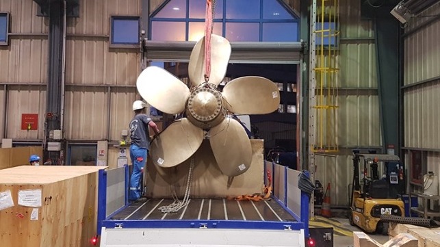

Hi Justin
Re: I think this is key to durability of printed objects. A printer that just pukes out plastic, concrete etc does not have the structural integrity of object done the "old" way. My opinion anyway
This was also my opinion. Then I read of the 3D printed ship's propeller (in my first 3D post).
You are aware of the stresses that apply to a large (5 bladed 2.5 Meter diameter military specified ) propeller.
The article states that this is the "largest "3D prop to date, so it would seem that the latest printed prop has followed a path of engineering evolution. As it has been inspected and and approved by the classification society Bureau Veritas (BV), we can assume that it does have the structural integrity of object done the "old" way. We have gone way past just puking out plastics.
