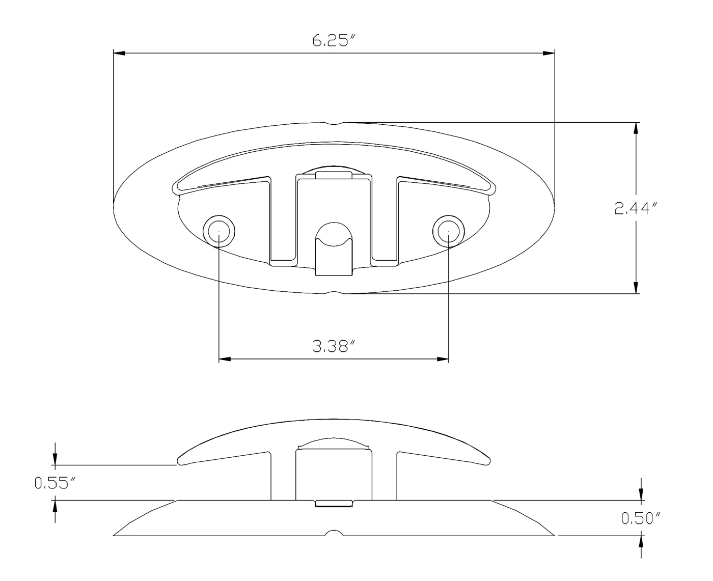

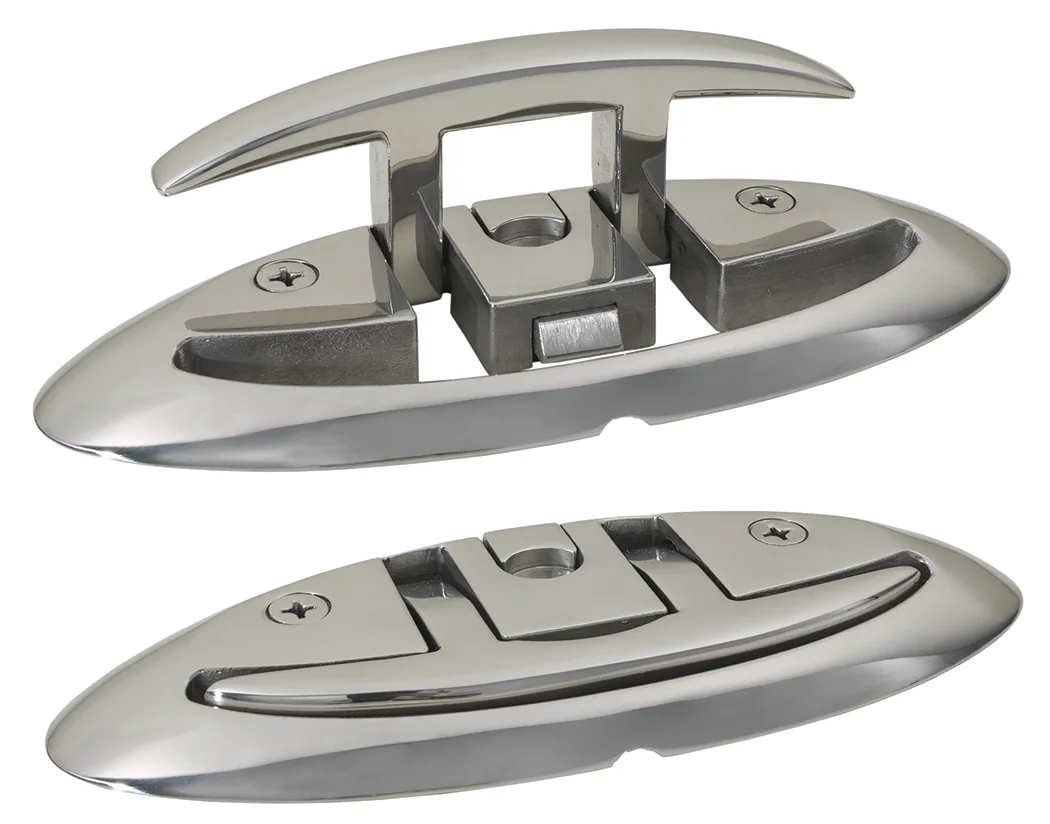

I like midship cleats. Allows me to single hand my docking without any one needing to "Jump" to the dock.
I chose to install a foldable cleat. Uses 1/2" dock line.
ACCON
Thru-Bolt SS Spring-Up Folding Cleat 4-1/2"
Thru-Bolt Folding Cleat - 4-1/2" (1/2" Max Line)
