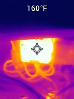

My only recommendation would be against the Orion 12-12/30 in favor of the Orion XS 50A. I have two of the Orion 30A you will find the following shortcomings.
1. Heat. The units will get upward of 165°F even in a roomy and well ventilated area (Which we have).
2. Derate. When hot, my units would only produce 22A. I did add three 40mm fans above the heat sink and this brought the output back to 30A, so there is a workaround here.
3. Efficiency. At 30A out, the input required is just under 40A. I calculated 81% efficiency.
4. Voltage sensing. Although “Smart”, these units do not participate in the ve.smart network, so they cannot use the voltage from the SmartShunt or BMV712. This means they will not correct for voltage drop like the MPPTs.
The Orion XS corrects all these issues. It is 98% efficient, doesn’t produce much heat and doesn’t derate as rapidly. It can also join Bluetooth ve.smart or connect via ve.direct.
Great info. The Orion XS isn't out yet though. Is the efficiency rating a published number? As an aside, I have 2 Kilovault 200AH batteries and have started the diesel quite easily from the house bank on several occasions.

That is the published efficiency. Actually they claim 98.5%. The claimed max efficiency of the 12-12/30 is 87%, but at 155°F I calculated 81%. I believe efficiency decreases with temperature, so if the new XS runs cooler maybe the efficiency will be closer to claimed. I thought they would be shipping in December but apparently they won’t be out til Apri.

It will be interesting to see how close they are to that number. My experience with Victron is with my two IP22 chargers. They claim 94% efficiency and while I have never checked it, those things run very cool. I can fell a little bit of heat off the top but I can hold my hand in the stream, and I never hear the fan come on. That is after several hours running flat out at 30A charge into my LFP batteries.
