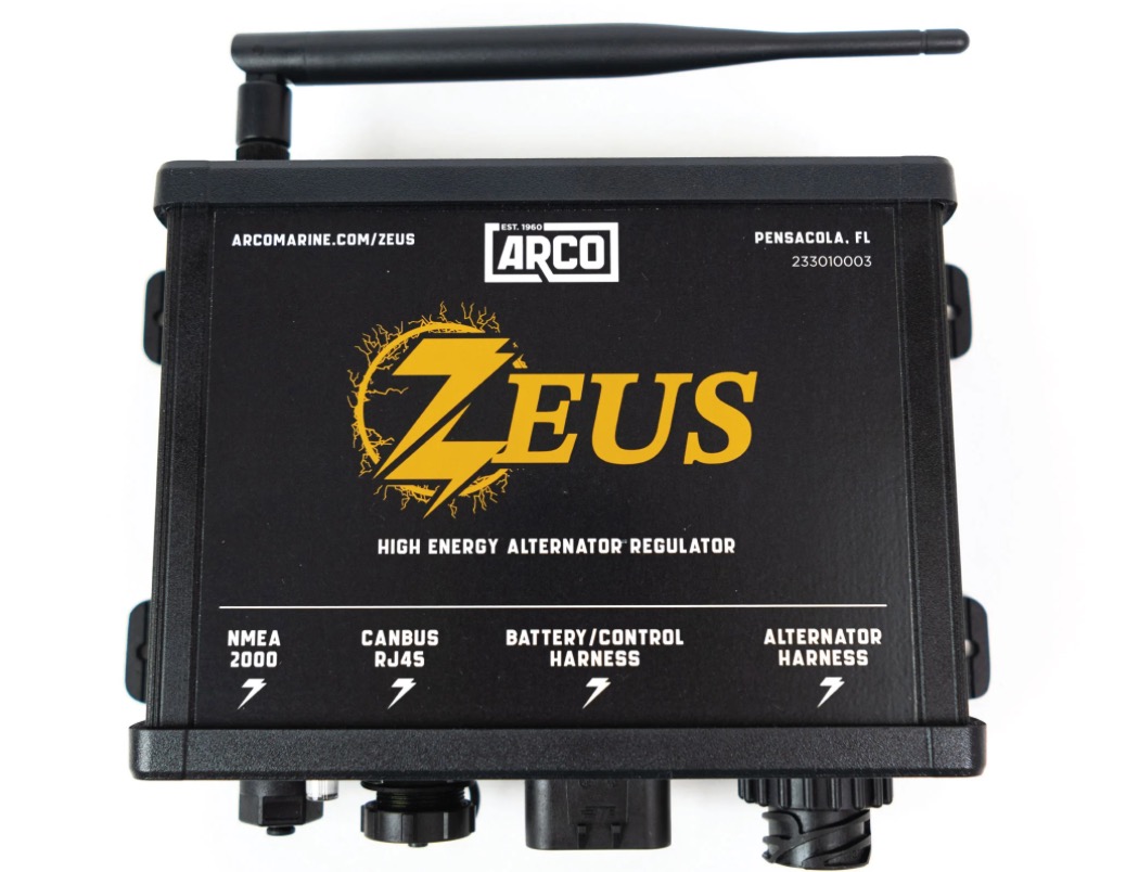

With that thought still on your tongue, I would be looking to the Wakespeed WS500 for a regulator. It is hands down the best on the market. For our little bitty engines, it has one feature that puts it into a different class from the others and that is White Space. You can program it to call for different max power output based on the engine rpms. I am currently working on the design of an alternator that is way too big for my 23-hp engine if I want to actually go anywhere because it with the prop will overload the engine at anything over about 1800-rpm. I will set the regulator to limit to 10% at idle and then ramp up to 100% by 1400rpms which is a good engine speed for charging at anchorage. From there, it will ramp down the output to somewhere around 50% at 2200rpm which is my max cruise revs. I will then ramp down to about 15% at WOT because the only reason I would ever be that that rev would be at a time when I needed all available power for the prop. With this program I am hoping to use an alternator with max output of 200A to 240A. All of those power settings will also be further controlled by the alternator temperature which will reduce the base settings as needed to stay within limits.
If you're going to go for the expense of a Wakespeed then you ought to also consider the Arco Zeus voltage regulator. They developed a very user friendly programming app for it that neither Balmar or Wakespeed offer.
dLj
Mar 23, 2017
4,760
How long have they been making that unit? I don't recall it being available when I was looking, the Wakespeed 500 was "it"....
dj
13,444

There’s a lot to like about it, especially an iOS app to actually program it with.
The FAQs (I hate FAQs) don’t make it very clear when and where the Zeus is compatible.
There are internally regulated… and externally regulated alternators…
Can I use it with my existing alternator? Yes…
Would I need to add the $200 Balmar external conversion kit to get my alternator to work with the Zeus? That would end up being nearly double the price of the Balmar 618 conversion kit with harness and temperature. I could probably find someone with an Android to help me program the Balmar.

The Zeus, Wakespeed, and Balmar 618 all have one thing in common, they only work on externally regulated alternators. Regulators work by varying the field current to control the alternator's output. The alternator can't have 2 different controls trying to control it. In your initial post you said you have a Valeo alternator that is not externally regulated. Thus, in order to use any of these regulators it would be necessary to either to convert your existing regulator to external regulation or acquire a new externally regulated alternator.
It would also be worth considering changing the belt system to a serpentine belt system. The upper limit for a standard v-belt is about 100a of alternator output. Your current alternator is right at that limit. Changing to a serpentine belt will make the alternator more efficient and reduce belt wear due to slippage.
This thread is getting a little long, so it is hard to remember all the details, so I may be redundant. First, there is no cheap way to convert to LFP batteries. On the output side of the system, the conversion is pretty straightforward and simple, connect the battery to a Class T fuse and then to the system. It is the charging side that gets expensive and touchy. There are 2 charging routes, direct to LFP or to a LA battery and then charge the LA from the LA battery.
For direct to LFP battery charging you need:
  • Externally regulated Alternator
  • External regulator programable for LFP batteries and temperature compensation
  • A method for charging the start battery (FET or DC to DC charger)
  • A monitoring system
For LA to LFP charging you need:
  • A DC to DC charger
(Note: there will undoubtedly be some other bits and pieces needed for the install, like new cabling, however, those are very boat specific and depends on what's already installed. Also, this does not include shore power charging.)
On first glance, it would seem the LA to LFP charging path would be simplest and easiest way to go, looks can be deceiving. The LA to LFP system sacrifices one of the biggest advantages of LFP batteries, a high charge acceptance rate, that's important because a high charge acceptance rate reduces engine runtime for battery charging. Consider, a 100ah AGM battery takes around 5.5 hours to reach 100% SOC from 50% SOC, it takes that long to restore just 50 ah of capacity to the battery at a .4C charge rate (40a). Apply that 40 a charging current to a 100ah LFP battery at 50% SOC and the battery will reach 100% in a little over an hour. Compare that to an externally regulated alternator with 100a out put and the battery is recharged in just 30 minutes, saving 5 hours of engine operation.
The apparent economy of the LA to LFP charging route begins to erode when the costs are considered. There are limited choices in DC to DC chargers, essentially Victron, Mastervolt, and Sterling. For any of these products expect to pay around $700-800 to achieve 50a DC to DC charging. It is possible to buy smaller less expensive DC-DC chargers, however, that will increase charging time. Depending on the alternator, it may not be able to supply adequate current for enough time to really justify the cost of a large DC-DC charger. The ~&500 difference between a Victron 18a DC-DC charger (adequate for LFP to LA charging) and a higher capacity charger, that $500 could be better spent on a new regulator and alternator.
There are 2 cases in which the LA to LFP route make some sense. If the boat is frequently at a marina and on shore power or as part of a multi-seaon upgrade plan. In the first case, LFP's benefit of lots of useable capacity in a small light package may be the goal. Weekend cruisers and racers would find this advantageous. In the second case, those of us on more limited budgets may find it easier to finance and to sell the conversion to the family's CFO.

The detour to the Zeus is perfectly appropriate. The regulator is a key part of the system. While I don't doubt that Wakespeed or Zeus are more efficient and better regulators, what I don't know is how much better? Do we get significantly faster charging? Longer life for the batteries, i.e., more cycles? Will alternators last longer? I haven't seen any quantifiable data to show Wakespeed or Zeus yield significantly better performance to justify the additional expense over a Balmar 618. It may be out there, I just haven't seen it.
If it helps, the current batteries should dictate what gets replaced when. If the current batteries have a year or more life left in them, then changing the system parts that are agnostic to battery chemistry might be the first to replace, specifically, the shore power charger, the DC-DC charger, and add the serpentine belts for the alternator and a monitoring system. This will set you back somewhere between $1K to 1.5K.
Two of the major advantages of the Zeus (or WS) are the programmable output curves based on RPM, and the shunt based control. With the programmable output, you can set little charging at low RPM, max charging at mid RPM , and reduced charging at high RPM to prevent overloading the engine. The Zeus has a “Generator mode” designed for when the engine is not being used for propulsion, that will apply full field at the selected RPM.
With the shunt controls, you can limit the maximum charge if required. So if your solar can generate 100A and your alternator 200A, but you want to keep the charge rate under 250A you can do that. It also allows charge termination to be based on current. They can be controlled by a Victron GX device, or some batteries with external comms.
Likes: Hayden Watson
13,444
Those are all great features, however they introduce a whole new level of complexity to a system of which many have only a rudimentary grasp and for the vast majority of us who are weekend sailors with occasional short cruises, they may be overkill. For those who measure their cruising time in weeks and not years how much benefit, i.e., how much money do we save by having the more complex system? I haven't seen any numbers that would convince me to upgrade to a Zeus.
Feb 6, 1998
11,722
The Zeus is amazing and far easier to program than a Wakespeed. It's temp protection for the alt also works really really well. You can make a Balmar work I did for 12 years, but not the way a Wakespeed or Zeus do...I swapped out my Balmar for a Wakespeed and it was a night and day difference...
