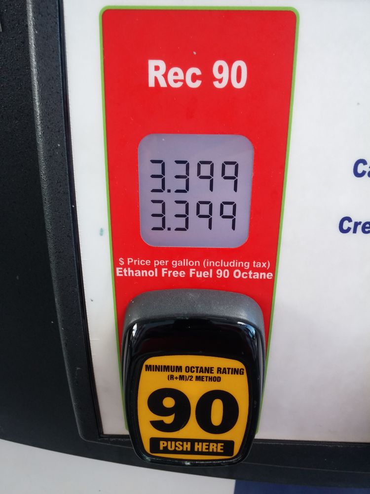

Her in S Florida we have many Gas stations that sell what they call REC 90. These stations tend to be clustered near our local boat ramps. All our local fuel docks sell REC 90
