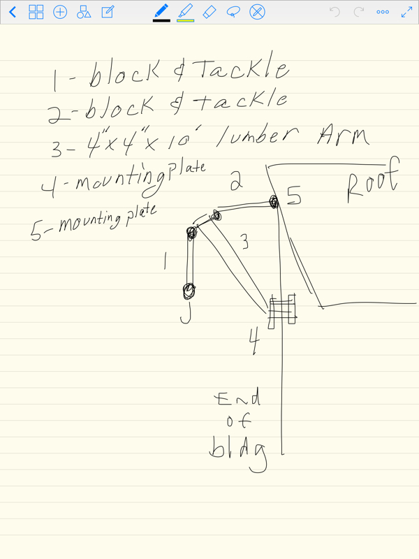

Here is an idea I have for a home crane (yardarm) for stepping my 272 mast. I want to be able to fully rig the boat before taking it to the marina for launching, and I just have 1 extra person to help, and she is trepidacious about having this mast fall. Especially so since it kind of landed hard when my mast A-frame broke due to unequal loading and twist on the mast as we lowered it to bring the boat home. It only came down hard about 2ft, but it was scary!
So... Tell me what you think, and why doesn't anyone sell these on the internet?
Yardarm: View attachment 74616
Measurements: View attachment 74617
Dimensions: View attachment 74618
Considering the relatively light weight of the mast, I think I could overbuild this with just 1 1/2 - 2" square, mild steel tube. Any ideas, caveats? Oh, the plan says, "4x4 lumber," but I am thinking steel considering the length. Also, the length of the arm can be shortened by a few feet by moving the mounting point up the wall, but then the mounting point and angle of the upper block and tackle changes has less leverage(?).
Thanks, Andrew

Looks like a workable concept to me however not dissimilar to the A frame but just not mounted on the boat. You don't show the weight of the mast or its length. Using a break wench to raise and lower should prevent dropping while a block and tackle requires constant attention or tie off when paused. The set up you're proposing is the same as farmers have been loading barns forever, go to a feed store for parts and ideas.

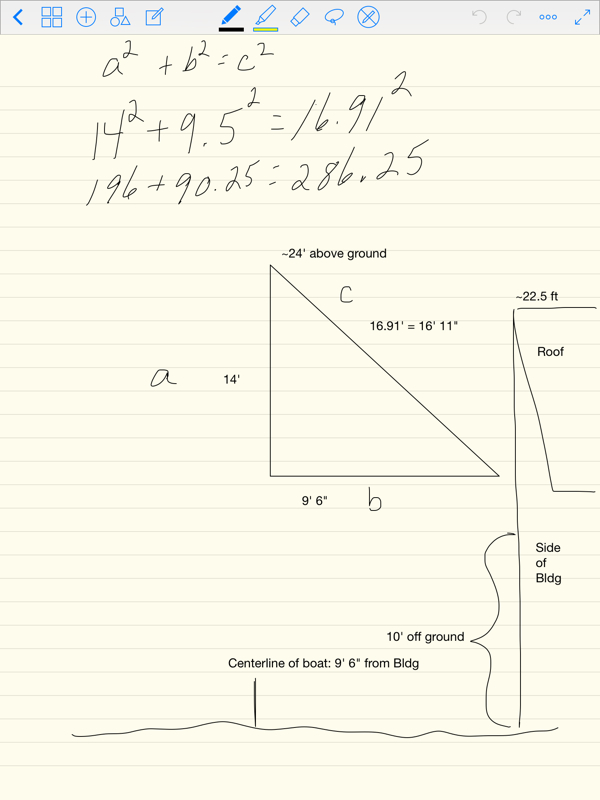

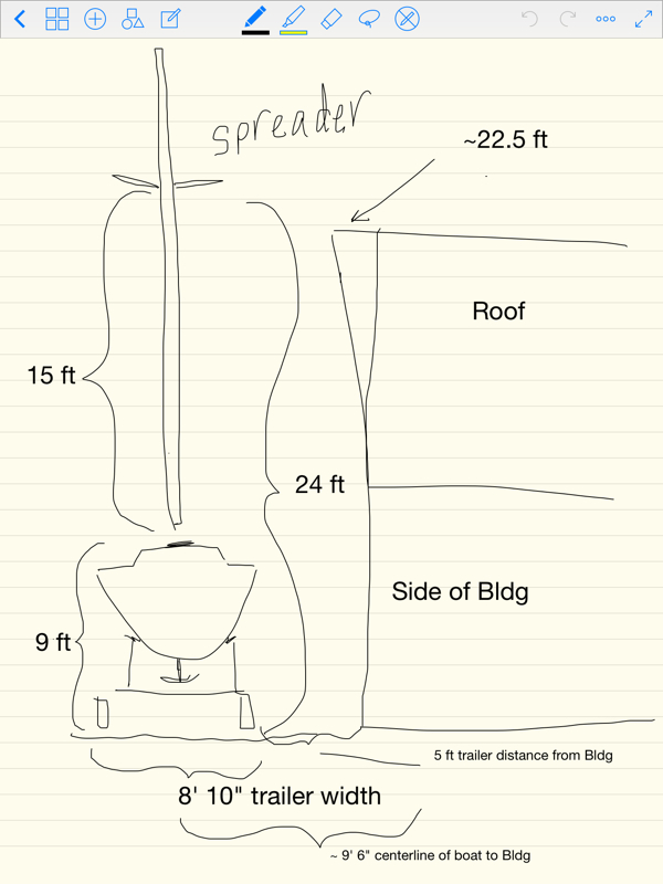

Concept looks ok, but not sure if crane is high enough from deck in the hand sketch. I suspect you need to place lifting strap on mast at a point that makes the mast slightly bottom heavy. Assuming the mast is heavier at the bottom and the strap is placed at mid-point on a 30' mast, you will need to get the strap point to around 15' above the deck. So using your measurements, that puts the strap point at about 25' above ground. Looks like you may run out of lifting range before mast is high enough, unless you use several people on lines attached to mast to pull (tilt) it up the rest of the way after getting the mast on the tabernacle.
Aug 3, 2012
2,542
Yes, the spreaders are 15' above deck, and the deck is 9' above ground. The spreaders are slightly above midpoint on the mast, so getting the spreaders 24' above ground should get the mast vertical on the deck. I can increase the lifting distance by raising the arm and getting the boat closer to the building. I have 5' of clearance between the edge of the trailer and the building, so I have some leeway. However, I may still have to give it a shove forward after I connect the backstay in order to connect the forestay.
The brake winch is a good idea!
