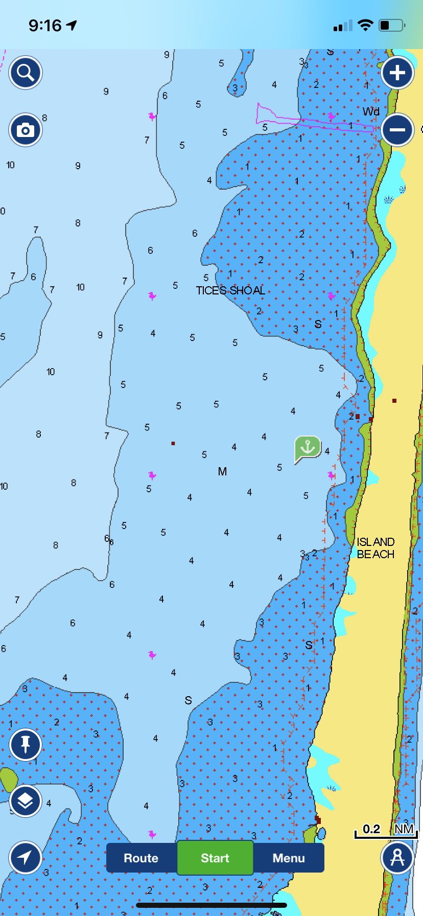

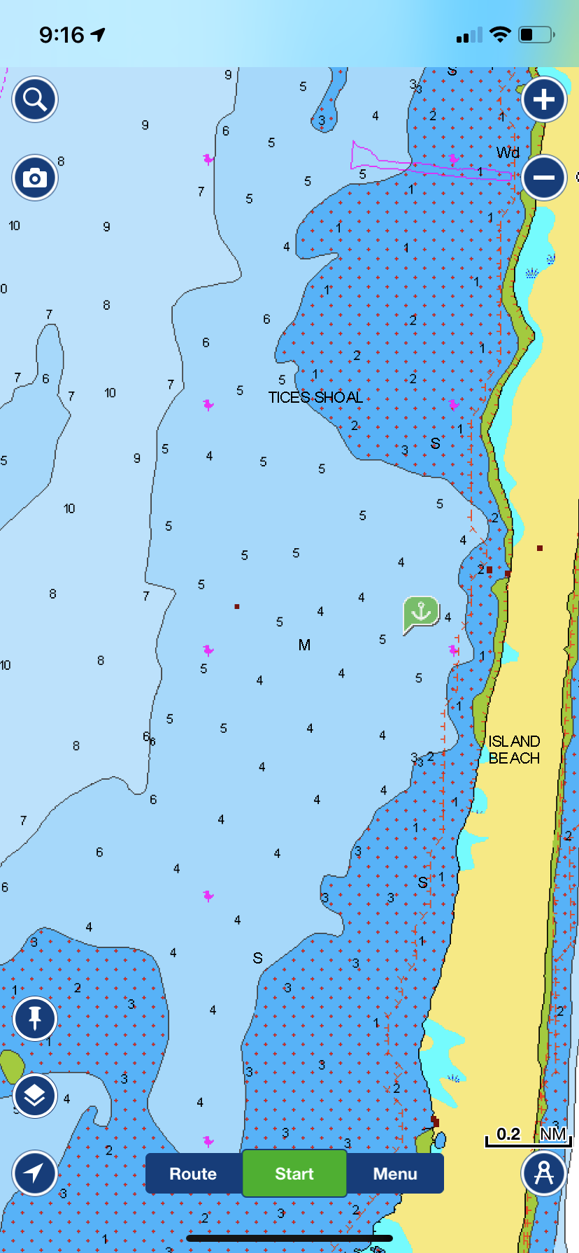

The OP has a 25’ boat in New Jersey. Here’s a chart of an example New Jersey anchorage:
Those depths are in feet, and the typical tide is about 1’. At 3’ freeboard the OP might never even see the 100’ mark on the rode.
Those are waters that I'd never drop the hook in...the 10 depths have surrounding shoals that the swing would most likely take you into...
May 17, 2004
6,223
Hard to capture the scale from a screenshot, but the anchorage (where the depth shows as 4-7 feet) is about a mile north/south and 2/3rd mile east/west. Most of the 4’ sections are really about 5.5” until you get closer to shore. On a busy summer weekend there are a couple hundred boats anchored there, which thins to about 40 overnight. The only places on the bay that are 10+ feet are far from any land and have no protection.

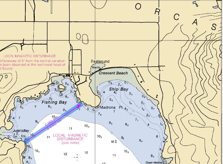

Anchoring space, depth, and boat specifications are so dependent on the waters you cruise.
With some areas around the PacificNW 50 feet is near shore.
Here is an example East Sound- Orcas Isand in the San Juan Archipelago.
The depths are in Fathoms. 5-9 fathoms 30-54 ft at Mean Lower Low Water.
Granted there can be a 10 ft tidal change, but great spot to hide from Northerlies.
Yep, I use a quieter anchorage in the southern part of the bay, Conklin's Island. With my freeboard and 6-7' depth I use 70' for 7-1 scope. The bay is shallow enough and depths are gradual enough swinging into water less than my draft is not an issue.
My rhode is marked with purchased 30' markers. The 90' marker has never been wet.
I sailed 15 miles north and then back south on the bay today. Only depth I noticed over 10 or 12' was at the channel leading to the inlet. It can get plenty deep in that channel. I've seen spots 20' deep.
