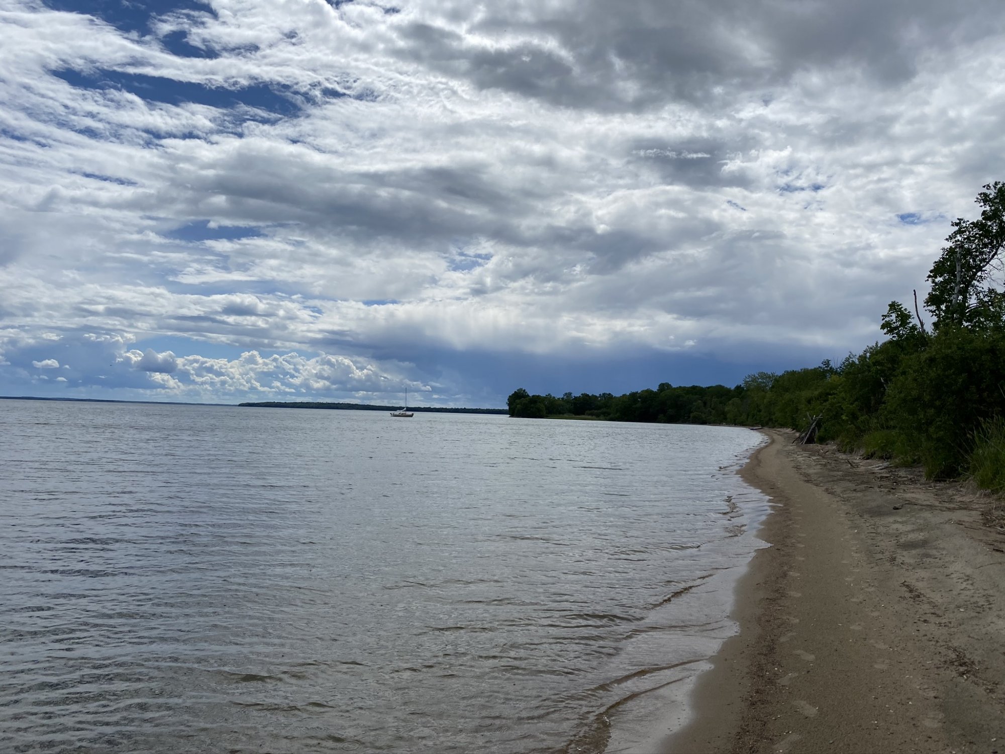

Anchored for overnight stay in 3.5 feet of water on a sand shoal which stretched for 3/4 or a mile or more. Depth was constant until about 10 yards from shore. We were not closer due to bugs from the shore and we could see the bottom the whole way. Stepped off the boarding ladder into waist deep water. My marks start at 30 feet (total length) as I cary 22 feet of chain which depending on the expected weather and storms I may not count in setting the hook.
