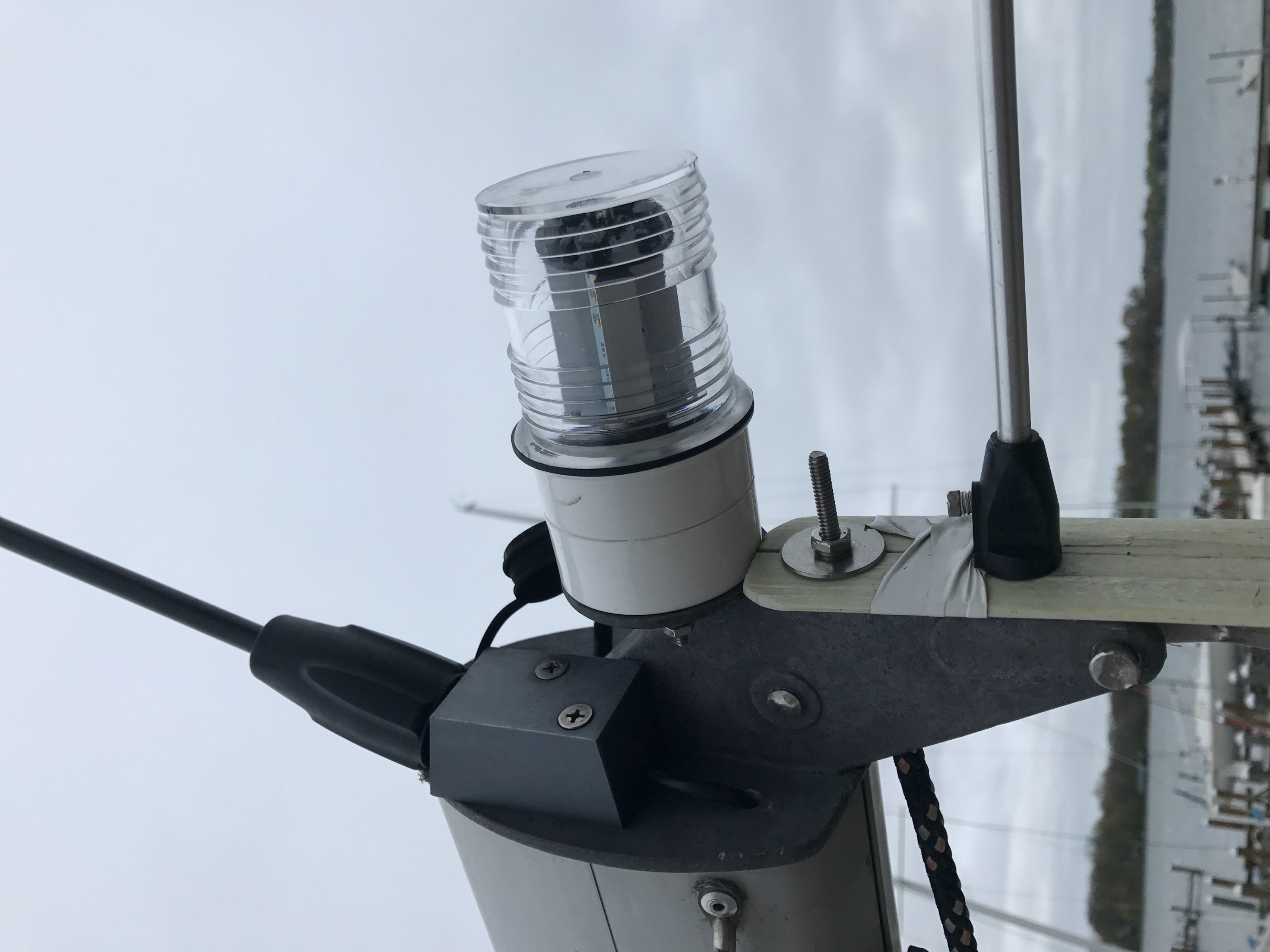

As expected, the marinebean housing fit PERFECTLY onto the light platform on my US-spars Z265 masthead.
The 120 degree holes in the platform lined up perfectly with the three holes in the base. Only weirdness, when one of the base holes is facing perfectly forward, the adjustable base of the bulb CANNOT be made to align. One of the three screws interferes with the slot gap. So I used just two, tighten down hard.
But the fixture looks great!

Looking good ... May it give you many years of safe anchoring.
I'd be concerned with "... tighten down hard ..." due to the cracking of the ring I experienced. I'm adding two 48-55 mm O-Rings to my setup to allow for thermal changes between the screws and the PVC ring. I don't know if it is me, but this is one of the most challenging engineering project I've done to retrofit something that was supposed to be turnkey.

I hear you. I was gentle on the fixture. I was talking about the set screws on the bulb that control the rotating base. That is metal to metal.

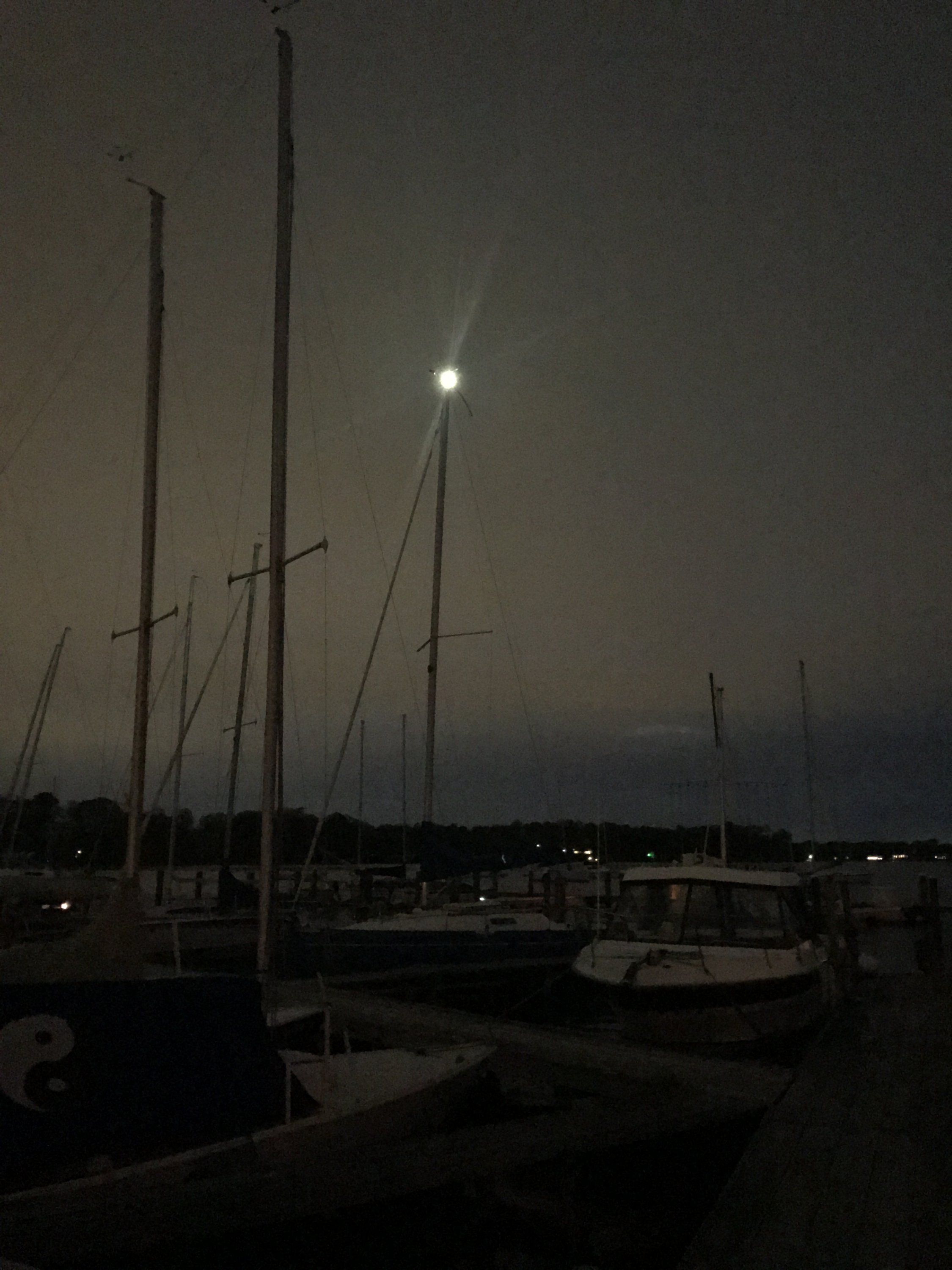

One more follow-up. Both the Nav lights and the anchor light are madly, stupidly bright. This shot does not do it justice. It really pops.
Nope. That's Venus. Venus is always that bright.
But seriously, @dgreen1991 has an anchor light that flashes. He says it's more eye-catching and is Coast Guard approved. The flashing helps distinguish it from stars/planets.

Yikes, that is one bright light! I hope it doesn't disturb the anchorage. There should be no problem finding your boat in a crowded anchorage after a night-time shore excursion. Maybe a dimmer should be included? Comparing the size of this light to the one I replaced, I can see that there will be a significant difference. Let's see a photo with the tri-color.

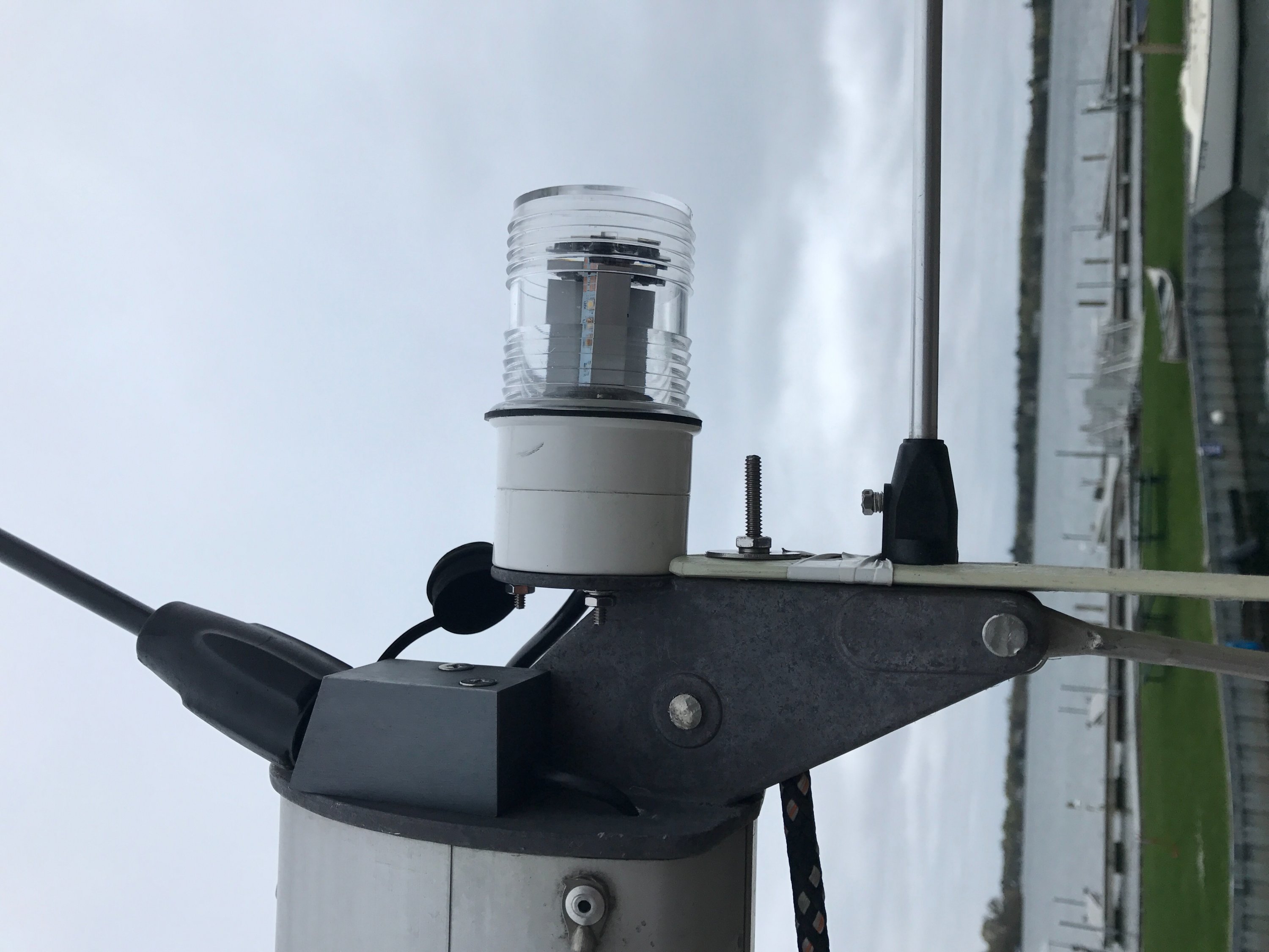

Last update ... good and bad. I gave up on the white plastic fixture as the entire bottom of it shattered when I tried to replace the ring. I called Marinebeam, who were more than generous. They offered to give me a full refund, or to send a different light fixture out to use with the tri-light bulb. I really liked the bulb design, but was concerned because I was five days before launch. They not only sent me a new fixture (looks very much like an Aqua Signal 40), but sent it express mail so I could install it over the weekend. These people are great at customer service! The new fixture went on very smoothly, and is now 50+ feet over Saginaw Bay! BTW, as Jackdaw showed, the thing is bright.

Anchor lights CANNOT flash. No regular navigation light can, either in the USA or internationally.
