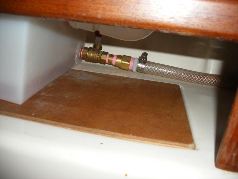

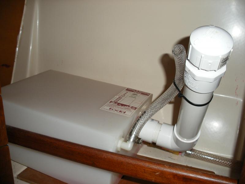

I eliminated the overboard discharge and raw water intake when I installed a new holding tank in my H34.
Attached are pix of the small Todd tank I put into the starboard v-berth cubby to feed the head. The PVC pipe is the tank fill. The vent hose is zip-tied to it. It's easy to dump a gallon jug or two of freshwater into it and you don't get the "biological" decay odor from using raw water.
Also, get yourself a "Nozall" fitting for your pumpout deck fitting for a safe way to "offload" the holding tank contents.
