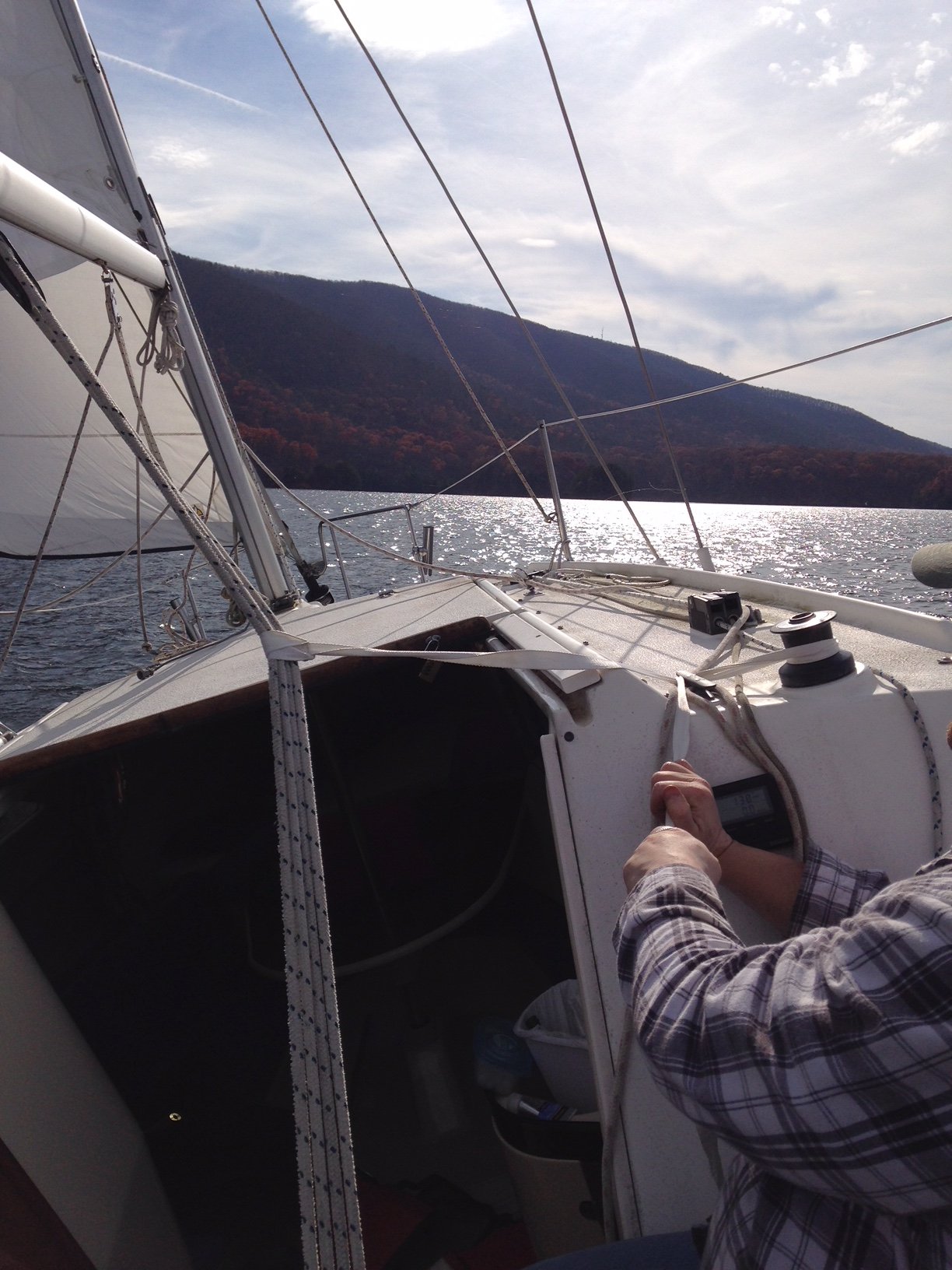

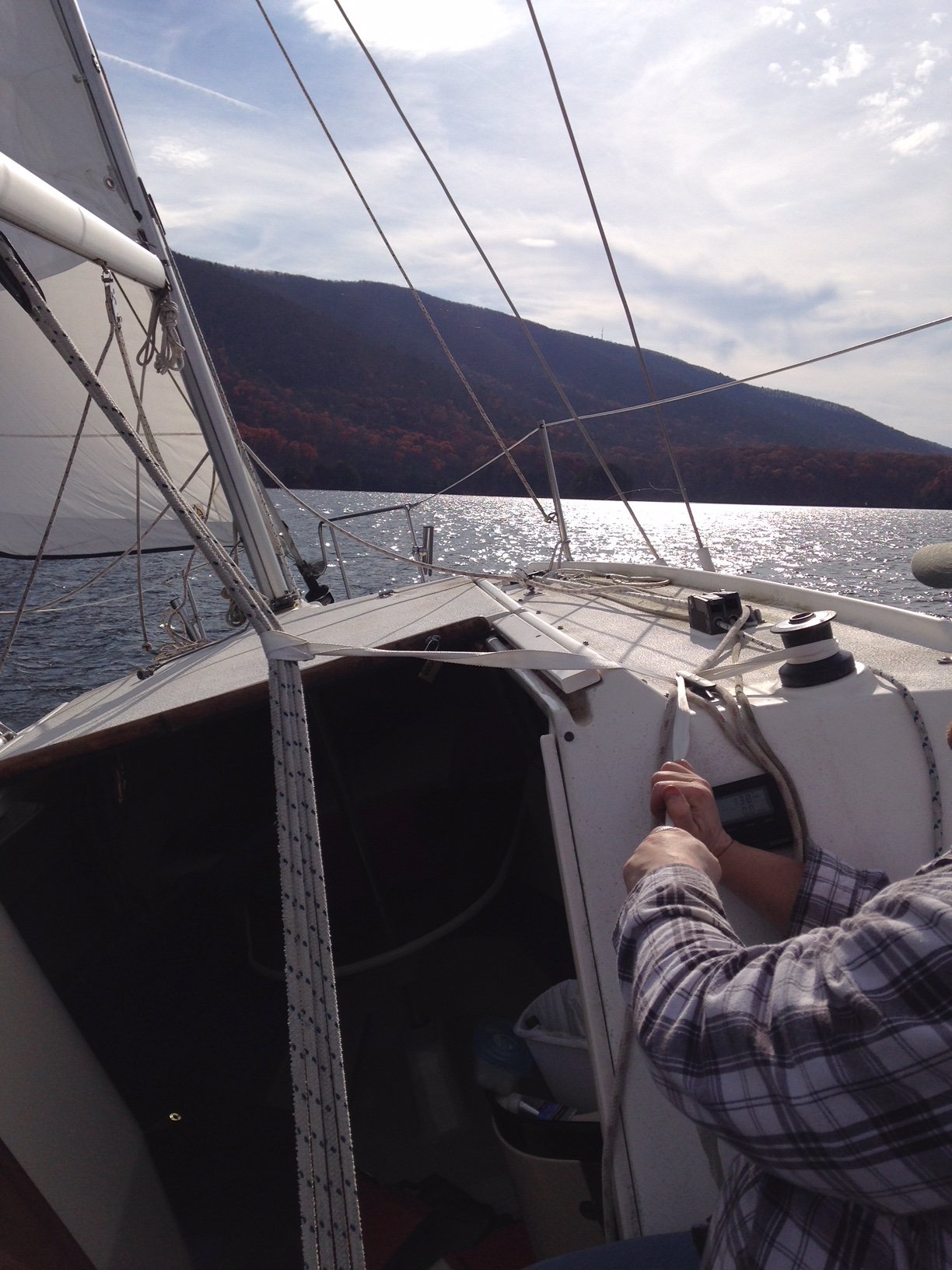

One other thing... If you want to get a sense of how much of a difference a traveler will make... you can fake one this way...
My avatar picture was taken with the boom pulled over in this manner. You can see the draft where it should be.
