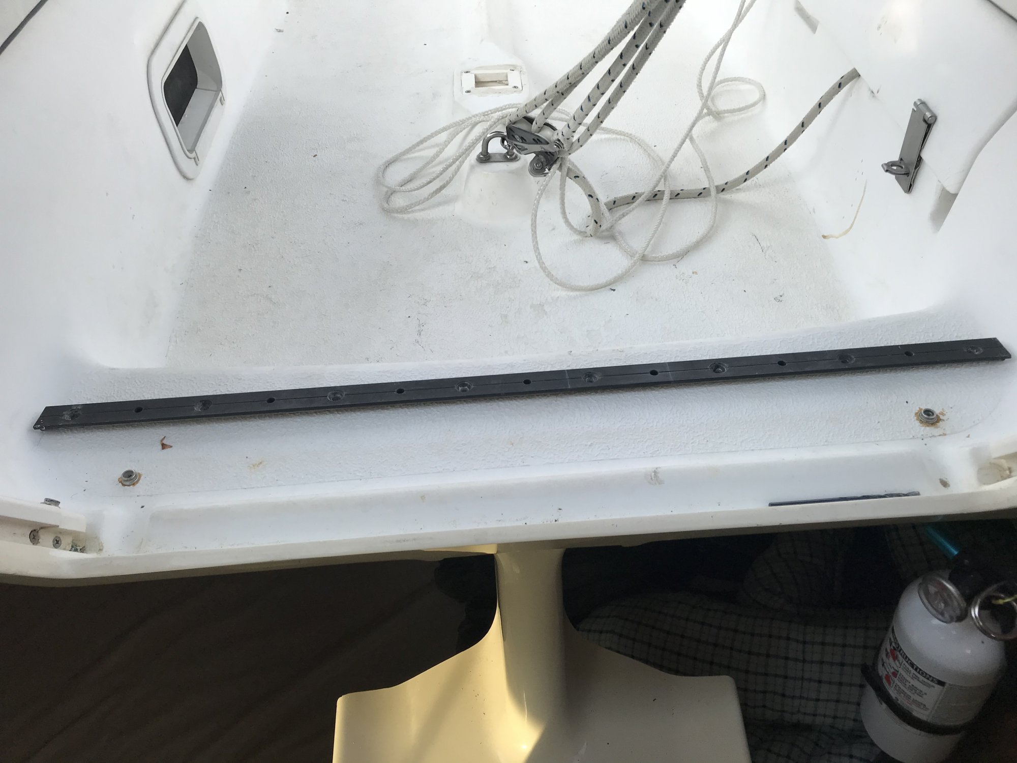

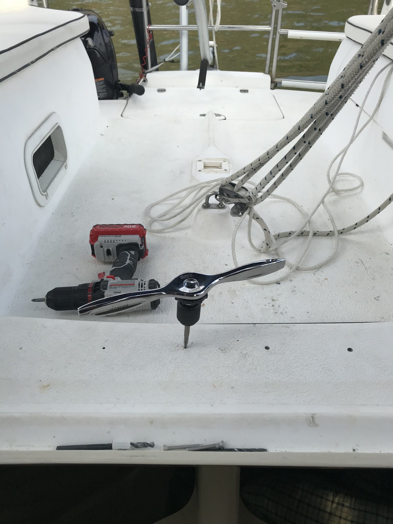

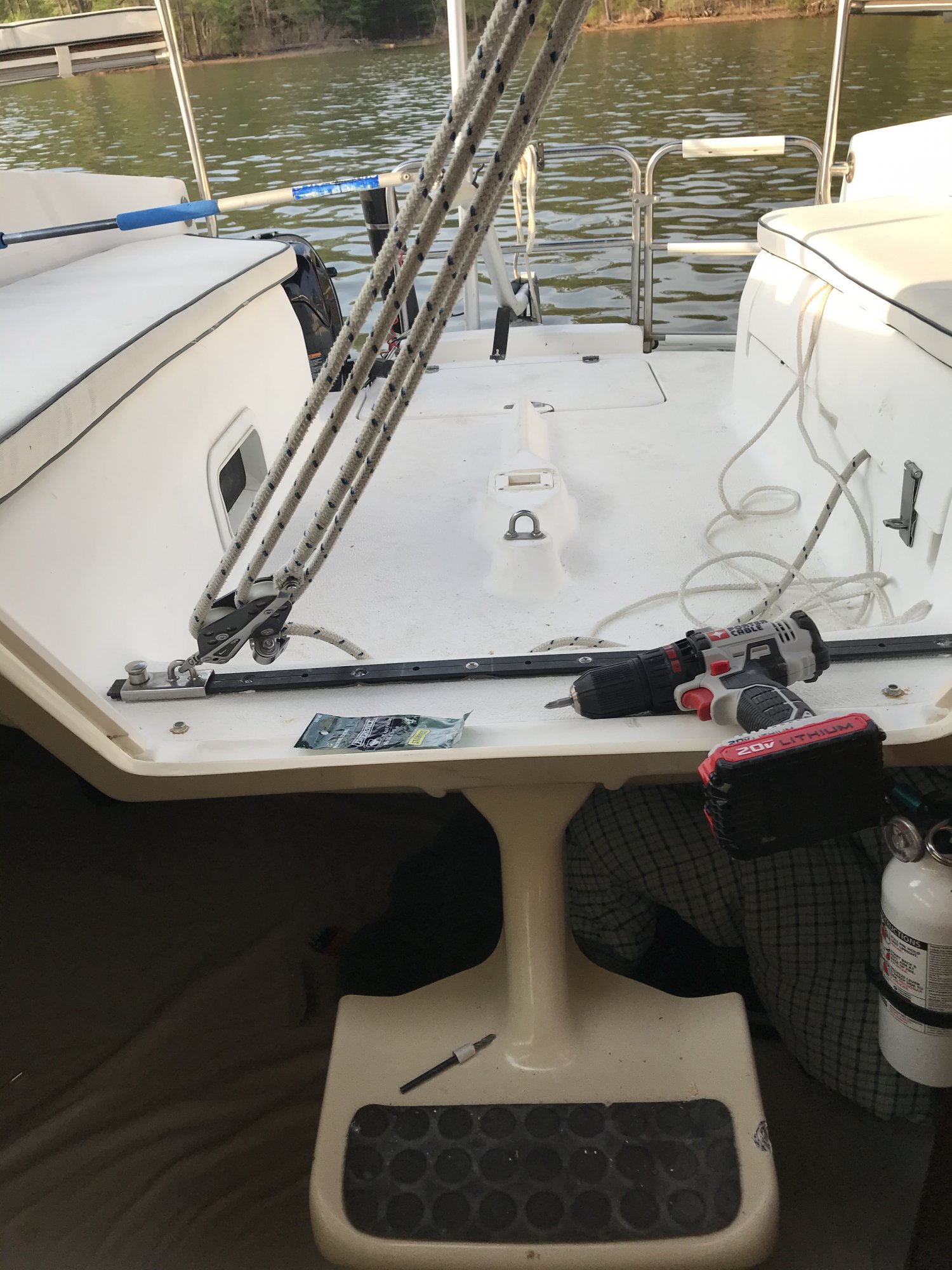

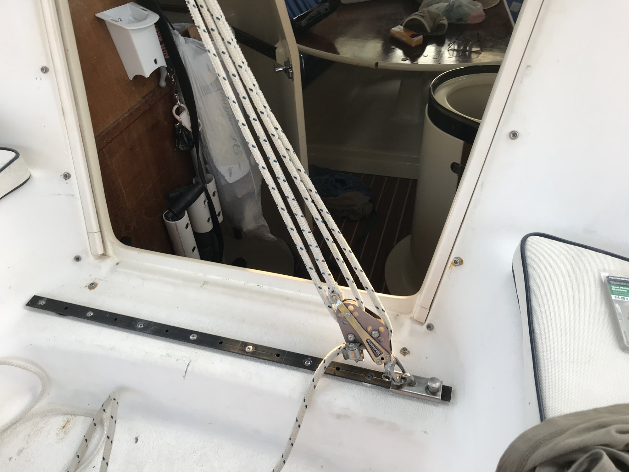

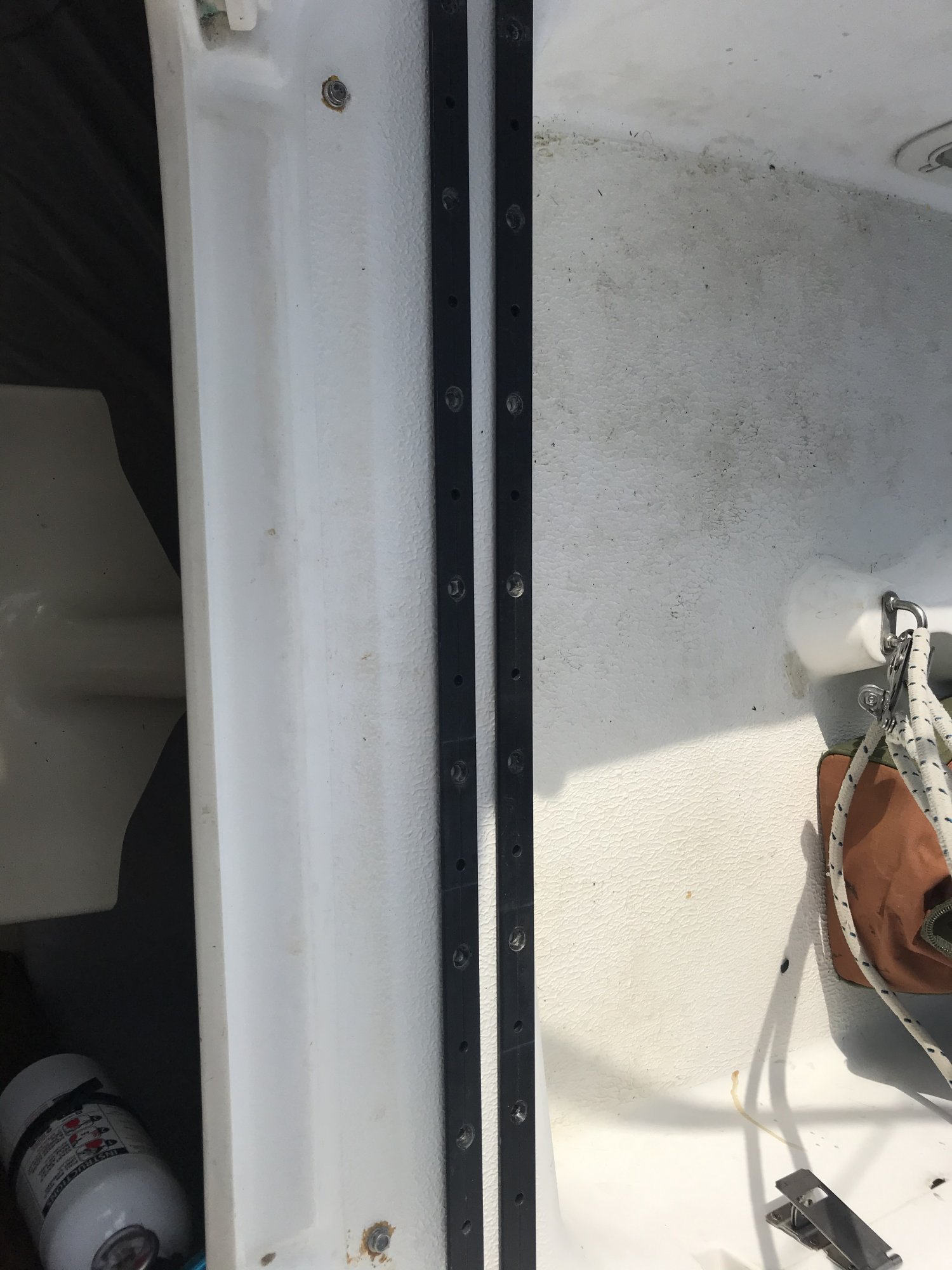

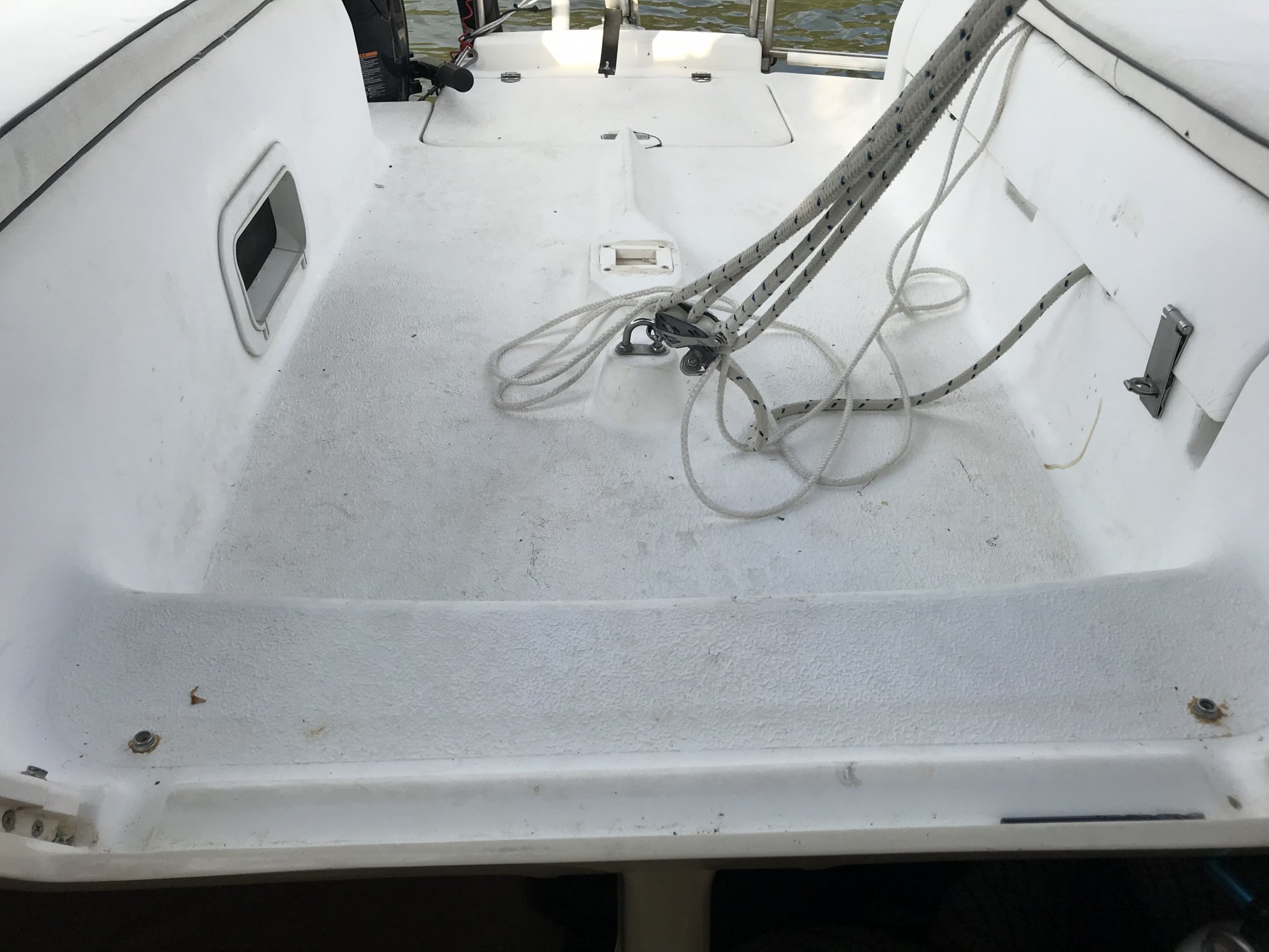

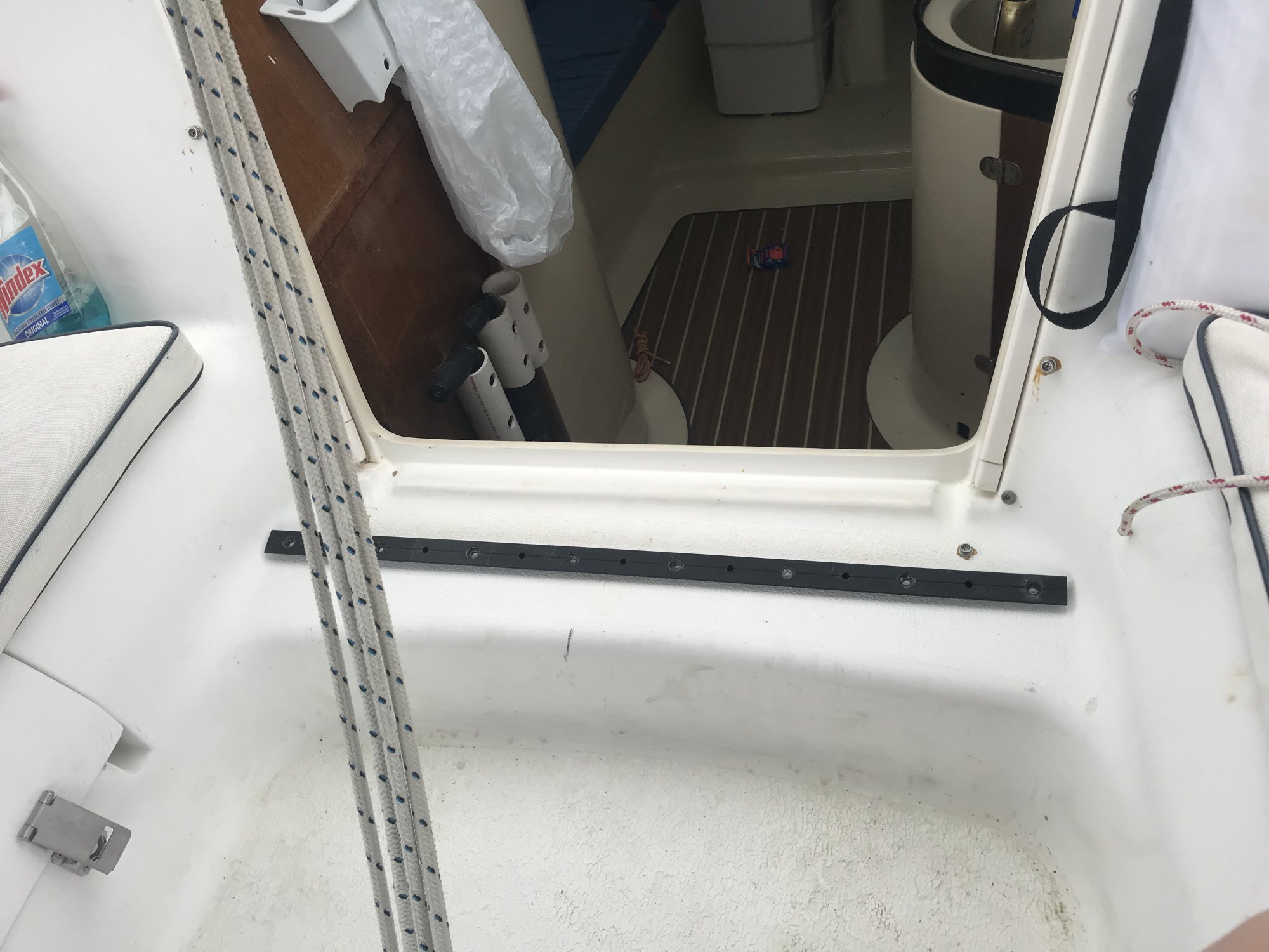

some of you may recall that I posted a plan to build a Barton-style removable travelled. I’ve determined that the cockpit locker will prevent clearance. I’m now looking at a permanent install on the bridge deck. @Crazy Dave Condon has said in the past that you need really good backing here. So I’m thinking of using a second piece of track as the backing plate.
I need to figure something out first and I need some knowledge I don’t have.
1) is there an embedded aluminum plate in the bridge deck?
See pics
The companionway stairs bolt up and into the bridge deck just behind the the bracket seen in the first pic. When I knock along the bridge deck there is a definite change in tone.
if there is an embedded aluminum plate. I’ll need to bring a tap and dye set out to the boat to thread the plate for the middle two fasteners of the T-track.
thanks in advance:)

I can’t answer your question. But I can tell you for sure if you put the traveler on the floor you will have a tough time cleaning between the companionway and the traveler. Mine had it that way. The bolts went all the way through to the ceiling under the cockpit. It didn’t seem particularly strong but I never had any lack-strength problems.

13,054
Here it is
the middle two bolts are threaded into an embedded aluminum plate
the rest are through bolted
when drilling the pilot holes for the tap go one size down. The aluminum plate is very easy to thread.

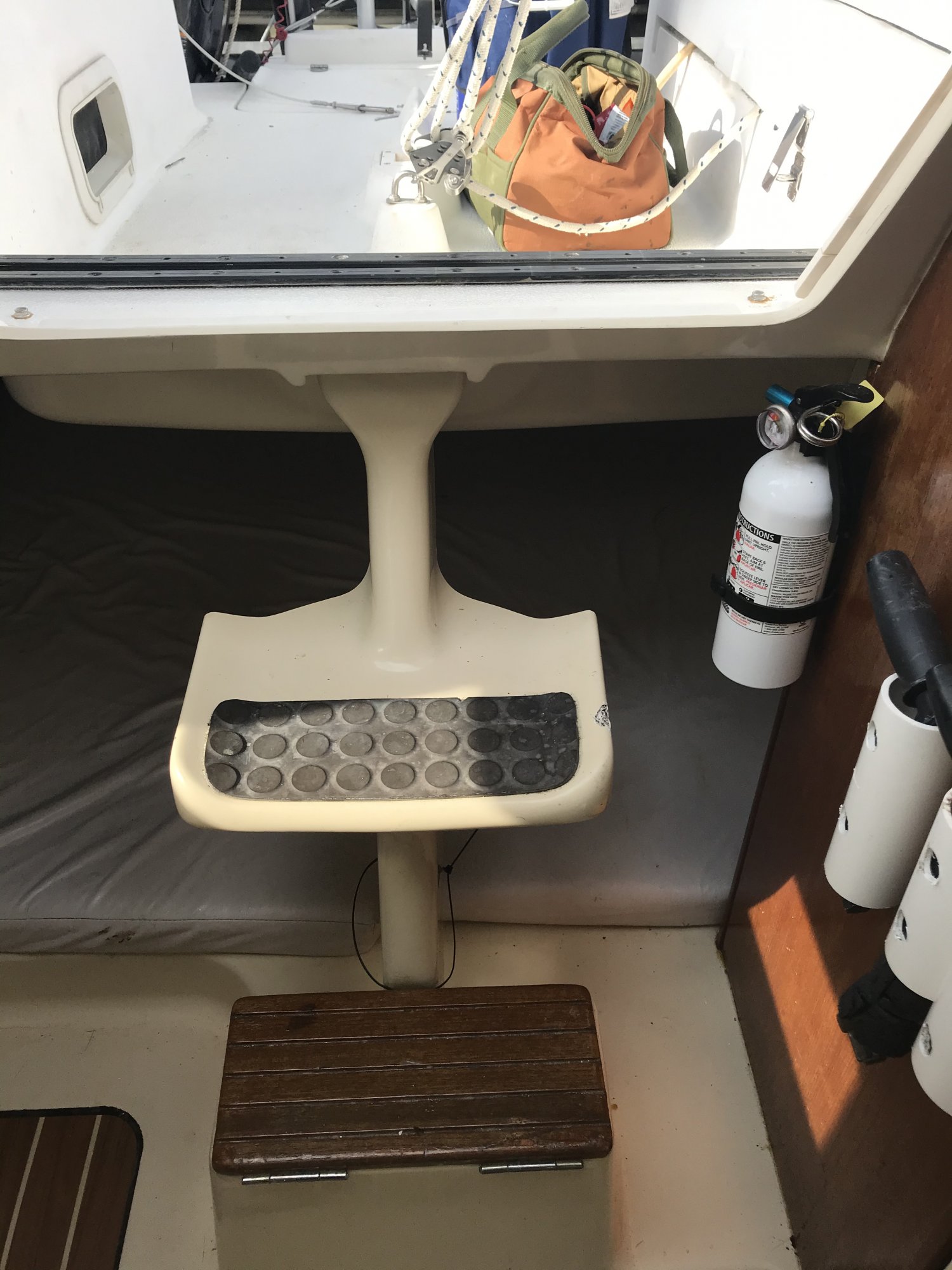

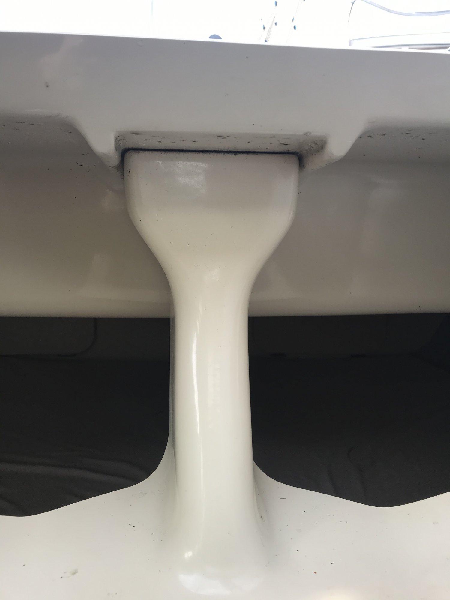

Can you post a picture of the underside ?
also what t-track is this ? manufacture, what size etc....

You have to remember there are steps going into the cabin that are secured to an aluminum plate in the ceiling/deck area just for that. To the sides generally no. If you drill thu the deck easily and then a dead air space and then thru the ceiling, then you will need to thru bolt to the deck pan, not the ceiling liner as the ceiling liner is not structural, only the deck pan
