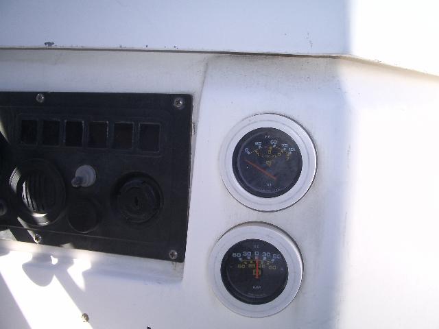

For electrical experts.... I'm doing this mod today: http://www.pbase.com/mainecruising/universal_wiring_harness_upgrade I'm wondering if I jump the alt as described but leave the orange wire connected, will the amp meter still register, yet without the big charging load going through the old circuit. Also, seems that this mod would decrease the load on the alt(?)
