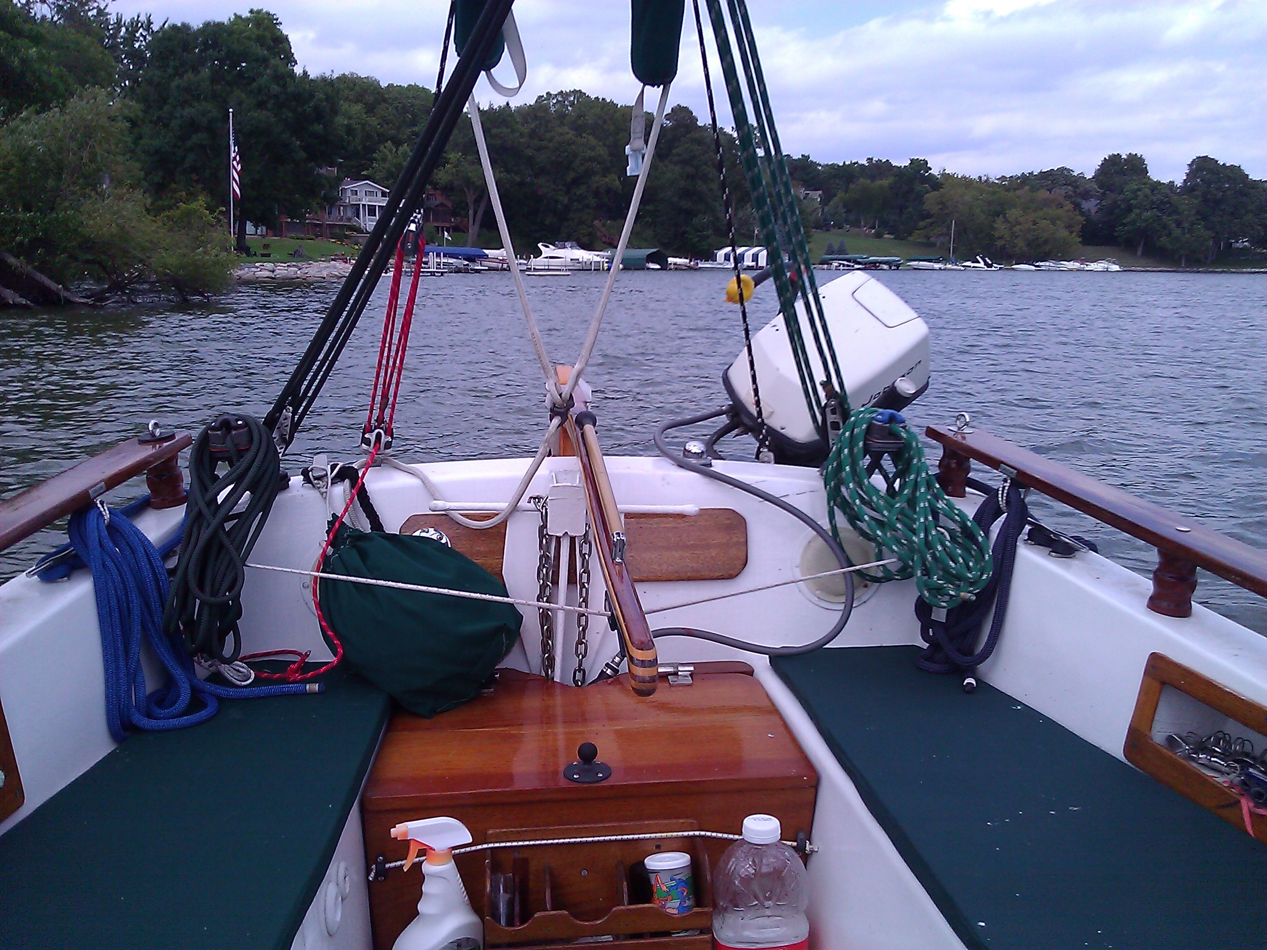

Montgomery 17, Venture of Newport, Mirror sailing dinghy, El Toro sailing dinghy Mound, MN -- Lake Minnetonka
My apologies if I have missed any reference to this arrangement in previous posts. I would like to get your comments on another way to rig the main without the inconveniences of a traveler: Dual Mainsheets. This has worked well for me for the last dozen or so years on my 1974 23' Venture of Newport cutter. Like many 70s trailer sailors, my boat came with end boom sheeting and the notoriously inefficient Crosby rig. I wanted the performance advantages of a traveler but could find no convenient/acceptable place to mount one, at least not one that was affordable for me. The dual main sheet arrangement lets me position the boom in virtually any position. It adds just one additional line to the main sheet arrangement as opposed to two for a conventional traveler. Yes, I do have a powerful vang; in fact, I bent the boom with it and had to decrease its power somewhat.
I did not originate the attached drawing; I borrowed it from another forum a long time ago. This is where I got the idea and decided to try the dual main sheets. So far, so good.
Comments please?
12,377
Sure... why not. I can see the utility of something like that. From your personal experience, did it improve the performance of your rig?
198
Absolutely! I think.
I generally don't race and so do not have any long term results to verify. I did trailer the boat from Minneapolis down to the Havasu Pocket Cruisers Convention in Arizona several winters ago. I didn't win but came in about 46th out of a fleet of around 150 boats. Not too shabby for the first formal race I have ever participated in in over 40 years of sailing. The second race I entered was a "Manufacturers' Cup" and I sailed against only other Macgregor/Ventures: 22, 25, 26d, 26s, 26x, 26m and (wait for it)
