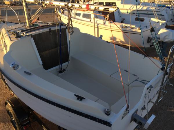

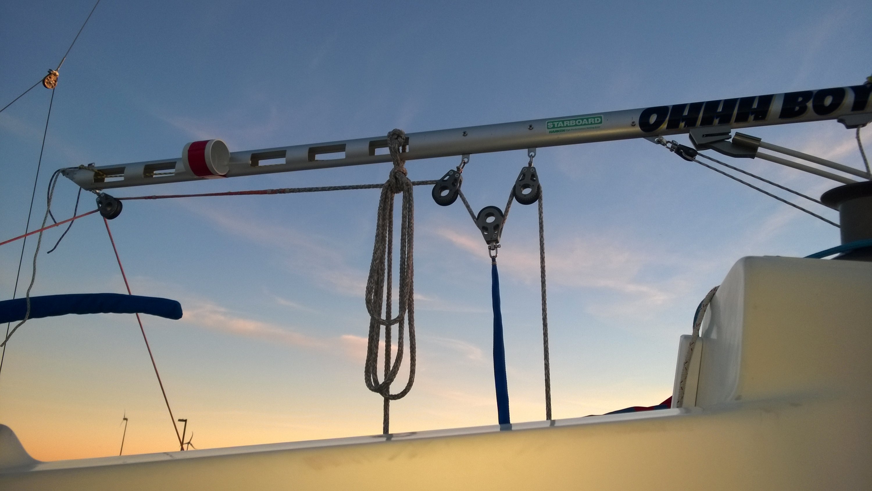

If I understand your rig correctly there is a world of difference between your arrangement and the Crosby rig. Here are a couple of pictures of a Montgomery 17 rigged similarly to your boat as I understand it. The two legs of the bridle are spliced into a single main sheet that runs forward along the boom. The 3 single blocks near the middle of the boom are to increase the purchase to 4:1. The strap connecting the middle block to the cockpit sole is just to minimize the amount of line that has to be pulled in when coming off a run or reach.
When the main sheet is hardened up the windward leg of the bridle carries the load while the leeward leg is slack. This allows the boom to be pulled up to the centerline without pulling it down too much and taking the twist out of the sail.
The effect of tightening the main sheet on the Crosby rig, however, is just the (unwanted) opposite. Because the windward legs of the bridle are connected to the leeward legs through the double block on the boom, the forces are equalized. The leeward side does not go slack; it carries the same tension as the windward side. The result is that there is as much or more force pulling down on the boom as there is pulling it in, destroying sail shape. I'm no expert on sail trim by any measure but I do know that there are times you do want twist in the main and there are times you don't. With the Crosby rig you have no choice.
Notoriously inefficient, yes! The Crosby rig, that is, not yours.

ANY mainsheeet system with a true boom end attachment will be vastly less efficient if the lines leading from the boom end do not lead straight down. Most high performance boats will have rigs (and therefor the boom) that span the whole boat. In that second pic the boom ends well before the transom, and creates that very inefficient angle for the sheet.
I do have to say however, that that is by far the most tricked out M17 I have ever seen.
