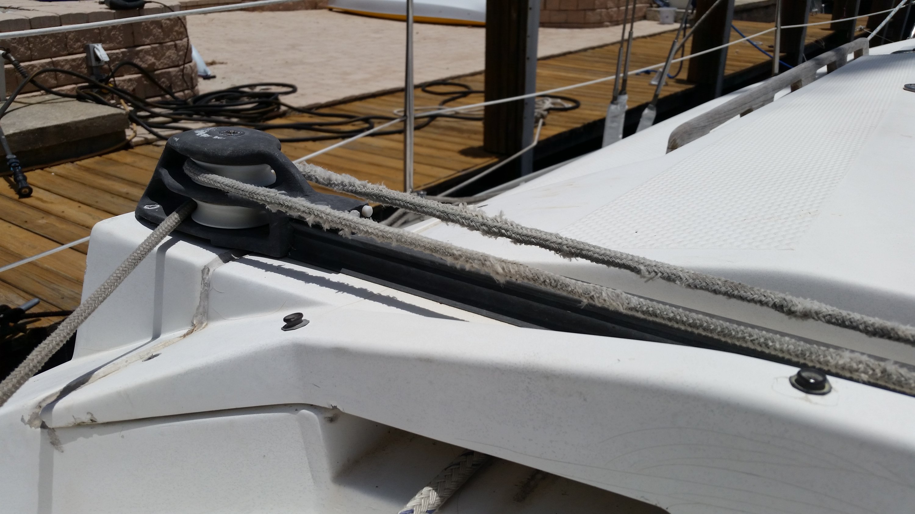

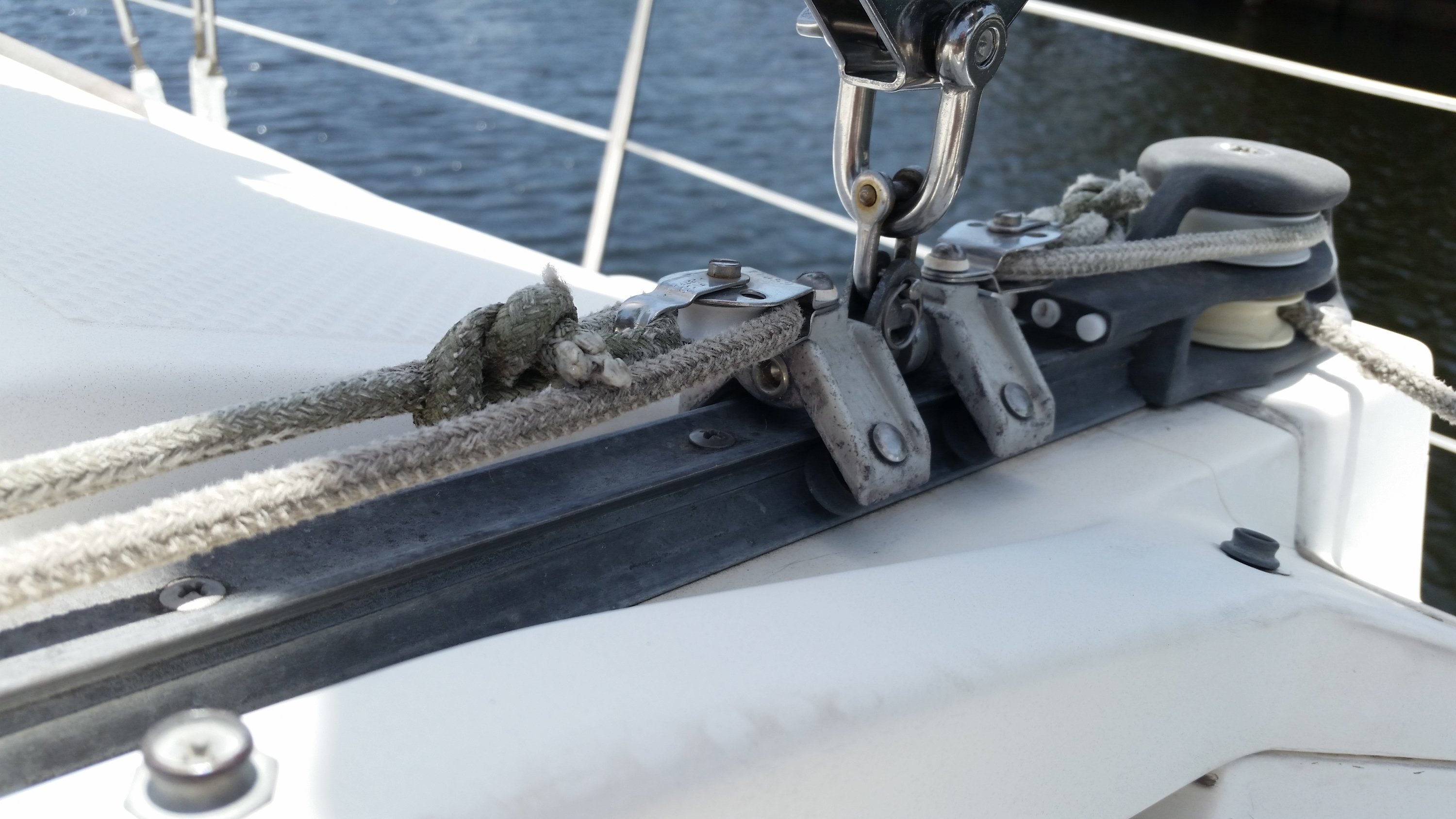

You see that slot below the lower roller? That is where a plate was attached and the cam cleat goes there.
So, it looks like I need to get some aluminum plates cut, and move my cam cleats. The original location by the traveler blocks looks much better, and easier to use. Also would move my traveler lines away from the lines run to the winches.

Mine is a little different. Is that the factory traveler?
This is mine
I have replaced the line since this picture was taken. Now I need to replace the sheaves.
My PO put cam cleats on either side of the boat near the exit from the traveler's blocks. It originally had a continuous line, but it was long, and I kept tripping over it in the cockpit. so I split the line and cut off the excess.
Rather than replace the sheaves, I may switch to larger blocks on the car like yours. My traveler is stiff and sluggish.
