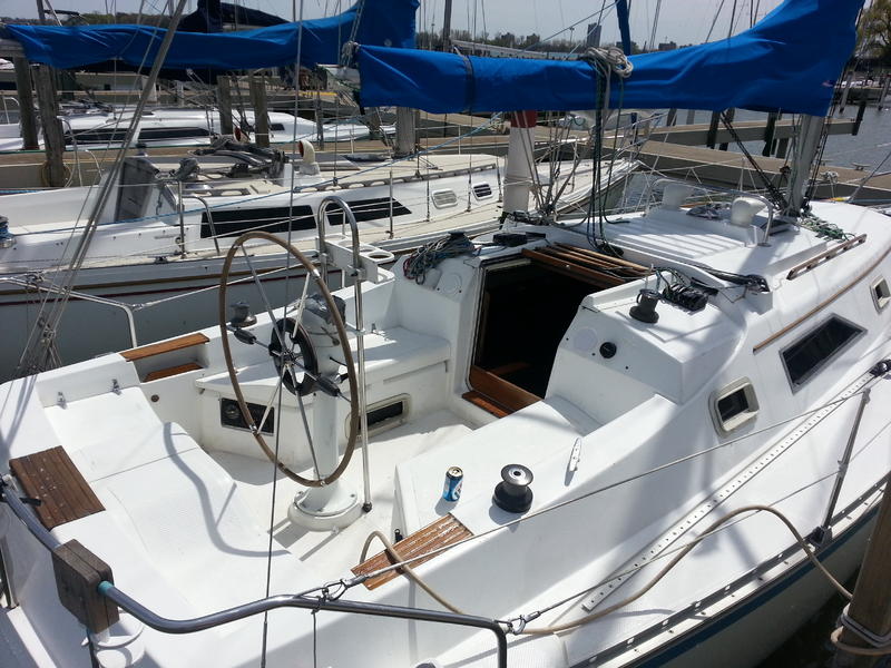

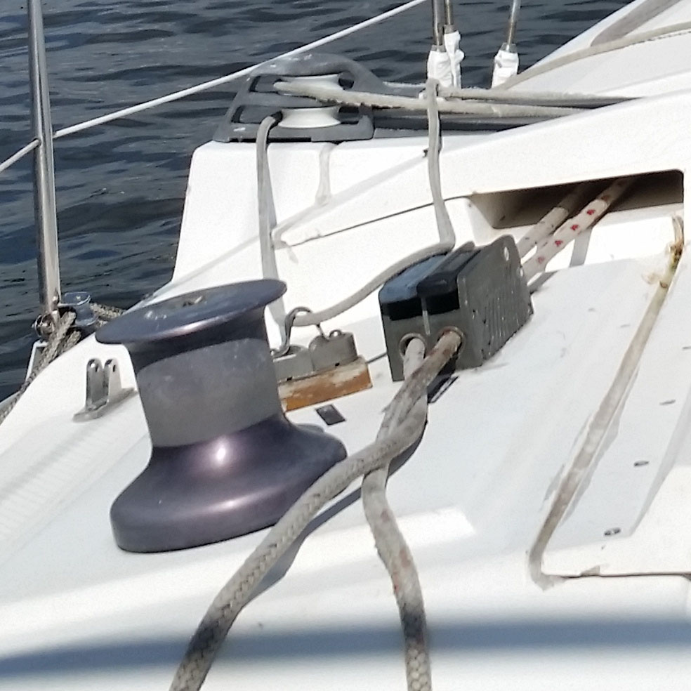

You see that slot below the lower roller? That is where a plate was attached and the cam cleat goes there.
So, it looks like I need to get some aluminum plates cut, and move my cam cleats. The original location by the traveler blocks looks much better, and easier to use. Also would move my traveler lines away from the lines run to the winches.

My traveler lines come straight back to the cabintop. I switched last year from V-cleats to Spinlock PXR Cam Cleats at the same location. Big improvement. The 1/4” black starboard bases cover unused screw holes from the old cleats.
  • Helpful
24,938
As long as you have the vertical room to operate this cleat it is a great unit. I have seen them used on dinghy racers. Ideal for lines that you need to adjust quickly. I have my eye on a line that can use one on SV Hadley.
Oct 6, 2007
1,184
Hunter H30 1982 Chicago IL
No problem with vertical clearance in this case. I can operate them from the helm. With the old V-cleats, I could in theory, but found I often had to go forward and push the line down further into the cleat or risk having it let go on tacks.
