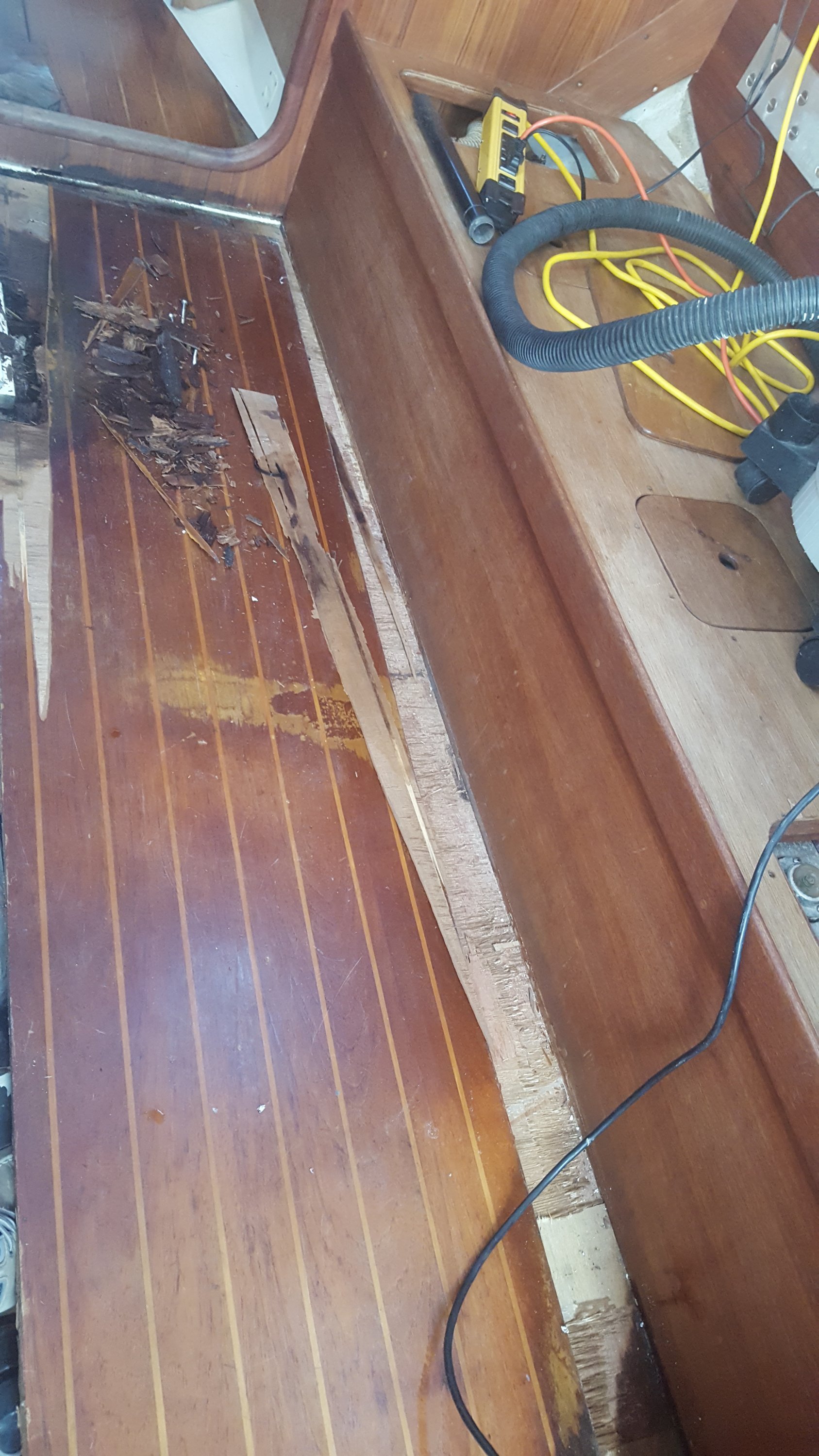

Year 3, this year, she is getting a new sole in the main salon. This boat has obviously been plagued with severe leaks for years. The sole had been patched in some places, replaced in the galley and was still rotting around the mast. This got real bad, real fast! Well, in ripping out the old sole, which was made up of a 1/2 inch plywood subfloor, screwed to the structure and a 1/2 inch teak & holly plywood glued down to the subfloor with epoxy, I realized that the 30 something year old, aluminum water tanks were leaking. So, Now I decided to take those out too. I also figured, while I'm at it, I'll take the settees apart and clean everything up and put everything back together fresh!

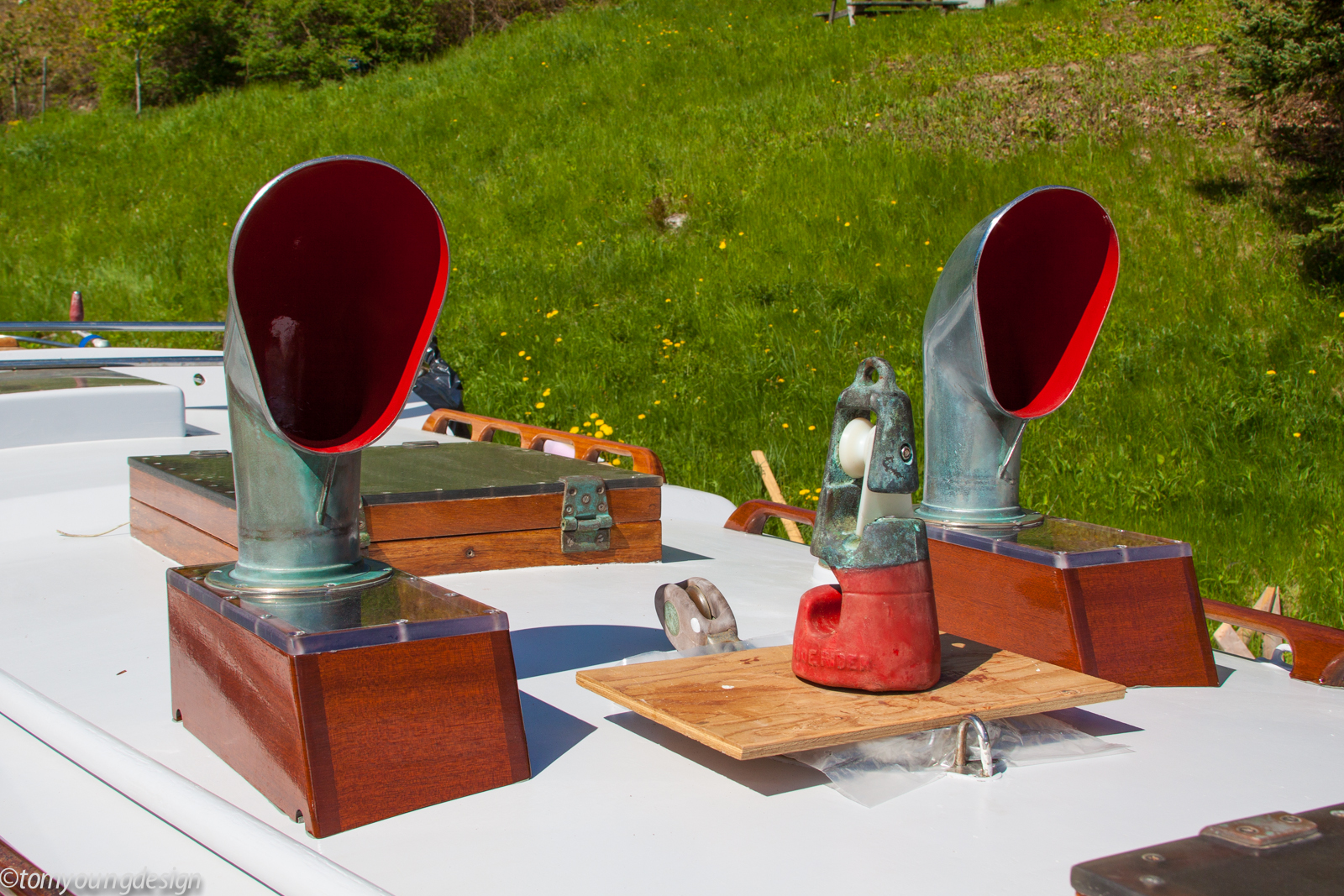

If you have dorade boxes with cowl vents (some Tartan 40's do), you could add (if it isn't done already) plexi to the tops of the dorade boxes. When I built new dorade boxes, I used Lexan for the tops of the boxes.

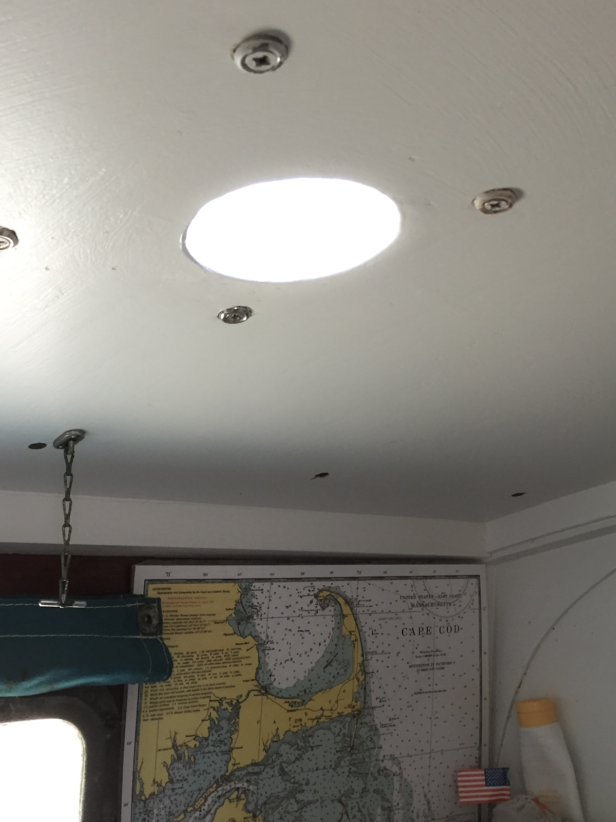

These added light in the head and passageway to the vee berth, the only places that that needed some daylight. Below, they now provide a nice beam of daylight through the stand pipe hole into the overhead.

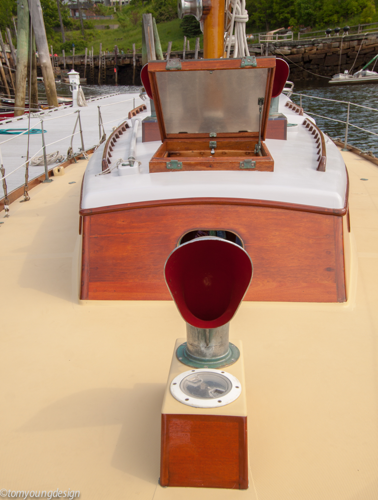

We have a third dorade box over the forepeak. The forepeak was a black hole until this was added. Instead of plexi, I mounted a 4" clear deck plate(same effect). I use the deck plate to stow the anchor chain deck wash. It adds another beam of daylight into a dark spot. Deck prisms used to be common in old boats to achieve the same effect.

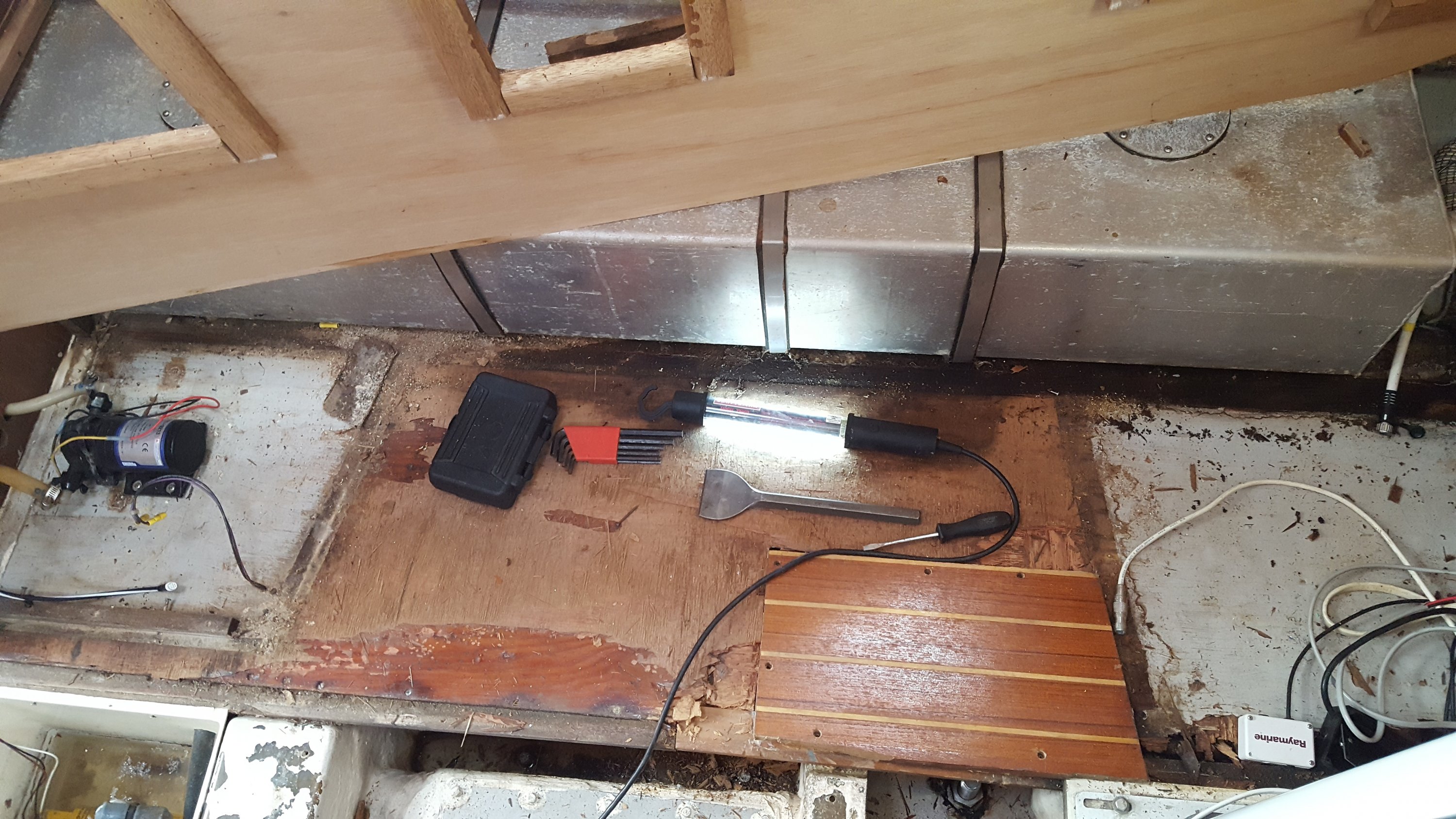

Well, things are moving along. Slower than I'd like but I'm pretty pleased with the results so far. Here are the new sole parts with 2 coats of epoxy. Next is to start the varnishing. I'm planning on 3 coats of clear and 2 coats of matt.
