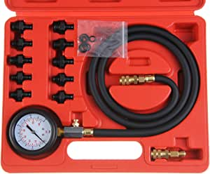

Hi Ralph. I agree with your comment completely.
"fitting a pressure gauge on to your oil system can be a bugger if the threads are not compatible with an NPT gauge."
BUT.
Click the link on the oil pressure gauge that I posted.
I was really surprised to find it.
It comes with 10 different fittings with quick connecting couplings for $30. A killer!
The flexible hose means you can rig it up and leave it on for a while with out the gauge rattling itself apart.
gary
Just goes to show what you can find if you dig deep enough. I had to tap into my Yanmar 2GM20F to install an electric pressure transmitter. I removed the threaded plug from the oil passage and finally gave up trying to match it to an NPT, NPS, or any other threaded fitting in the 3 mm range. Finally re-threaded the hole with a 1/8" NPT tap while slowly wiping, cleaning, and polishing the inside as I cut into the old hole. Finally wiped it out with half a dozen Q tips coated in heavy grease and didn't get any metal cuttings. The image of OCD :eek:.
For the OP's problem, yes, this is the ultimate solution as it's not too inexpensive, easy install and answers the problem once and for all.
