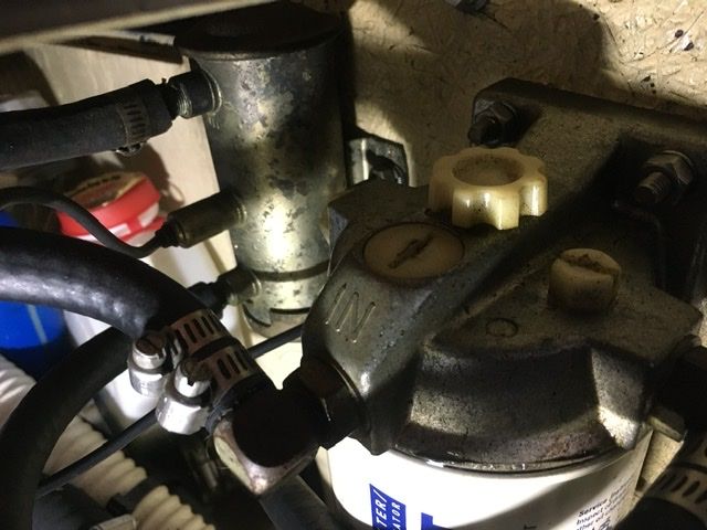

Here’s my pump. It’s definitely hooked up: Tank>Filter>Pump>filter.
20,884
Yes, that's a Facet (or Facet type) pump. Look carefully at the bottom: has a hexagonal bump at the bottom with tabs that keep the bottom section onto the body. Quarter turn oughta pop it off.
Tank>Filter>Pump>engine filter
So, am I just checking the strainer on it? And cleaning it out and see what happens?

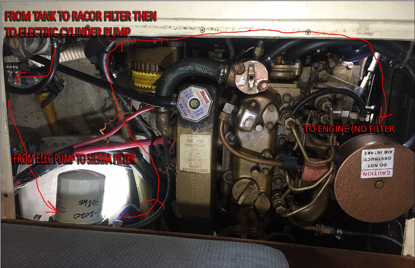

Nope... What I said... Tank>Filter>Pump>Filter>Engine
I do not have a filter on the engine. I have a second remote filter. This is how my boat came to me 5 years ago and it has ran perfect until now.
Here's an image I hope explains it.

Haven't you been working on this for a month now?
Check the $%&# fuel pump already!
FYI The thumb screw on top of your Racor fuel filter head is a primer pump.
