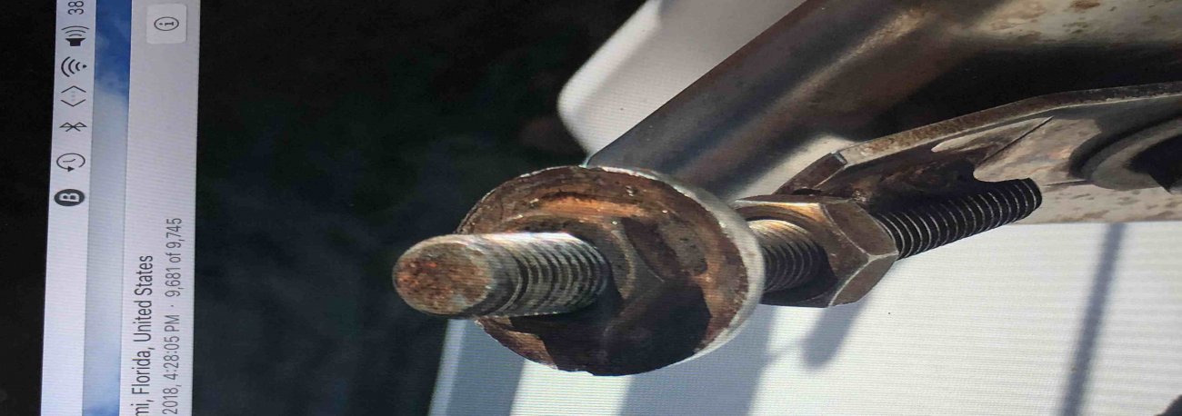

We believe, or the insurance company believes, that the starboard strut was partially to blame for the mast to fall. the other issue was that, I did not know, that we were in the process of replacing one of the shrouds and were waiting for receipt of parts and the return of the rigger from vacation when the storm came through. The insurance company, so far has been very receptive, since we have documentation of order, and emails to and from the rigger. Our boat is moored right next to the channel and there is a lot of current in the area. Other sailboats that were unprotected also suffered some kind of damage. hopefully now Wednesday will be D Day for the insurance to let us know how much they will cover. Keep you posted

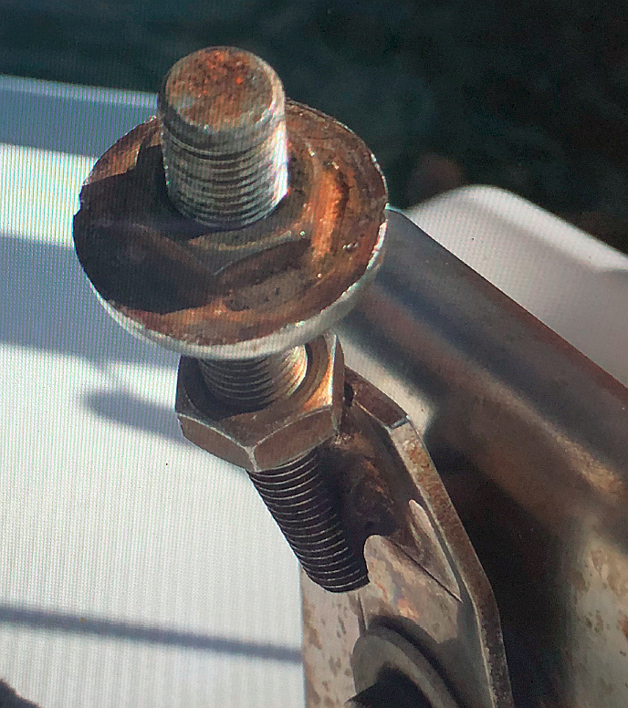

That picture shows a piece of SS threaded rod stock tack-welded to a chainplate. Someone please tell me that is not that way the boat comes from the factory.

Sure doesn't look original to me. I cleaned the pic up a bit and rotated.
10,536
-na -NA Anywhere USA
That was a top for one of the struts that came off. The strut primary purpose is to stabilize the mast in raising and lowering. @rosypar1 this had nothing to do with the failure.

While you are in experience gaining mode, I'll offer a little tidbit of information that you may not have gotten yet. The amount of rust stains in that last picture suggest to me that your stainless may not have been passivated recently. Periodically polishing with a passivating paste, like Wichinox, will help to keep your stainless more rust free & also help to keep structurally compromising crevasse-corrosion at bay. This makes your stainless parts last much longer in a salt water environment. Often, properly passivated 304 will hold up better than untreated 316, even though 316 is considered to be a more corrosion resistant alloy.
