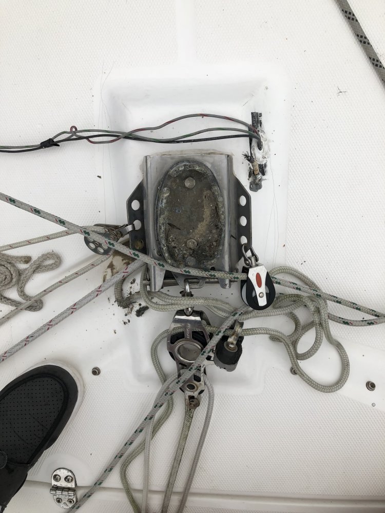

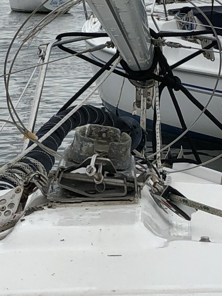

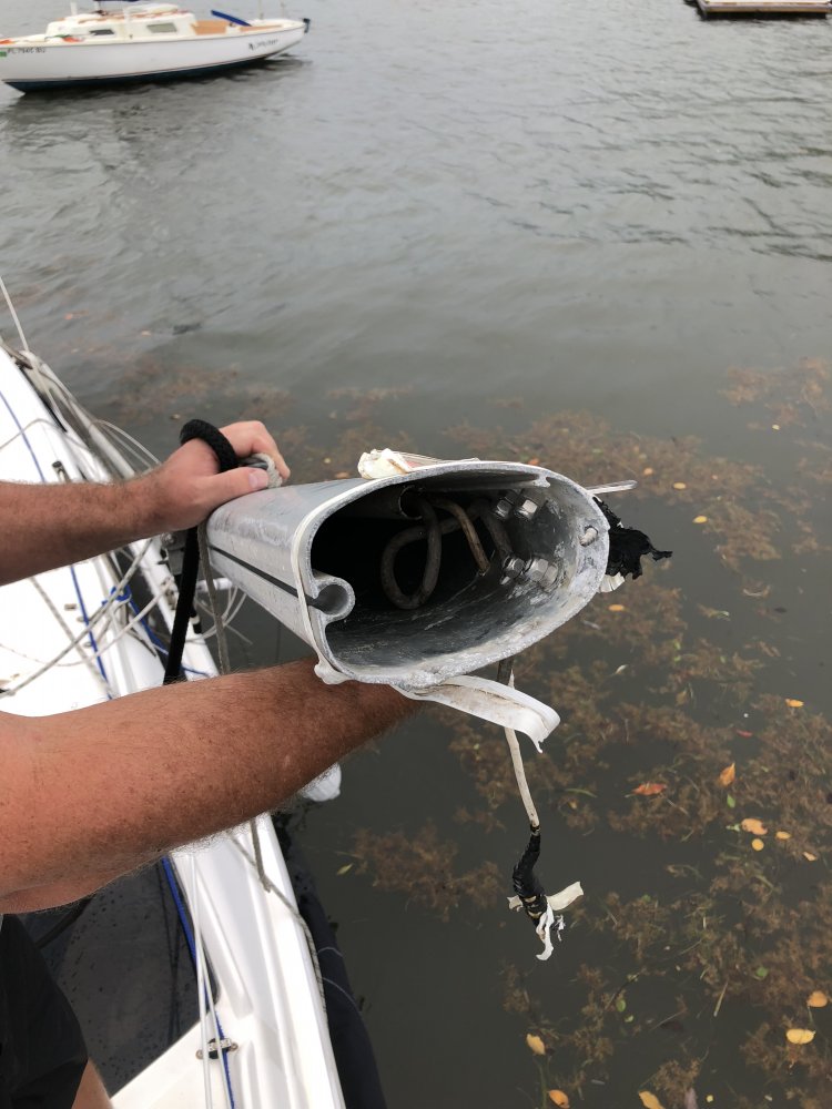

Mast seems good. Managed to pull out of water Picture attached of base plate. Struts bent and and one if the spreaders is bent also. Anyone know someone on Miami that can put this thing back together for us. Adjuster coming in 2 days. Thank you. Boom ok also. Took everything apart

Do you know what part failed during the storm, allowing the mast to fall?
Almost impossible for it to be anything other than lack of preventive maintaince. Masts don’t just blow over.
