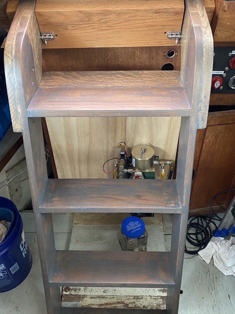

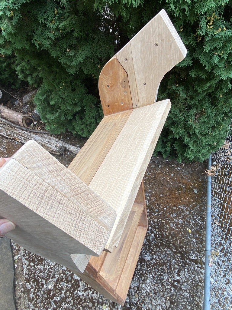

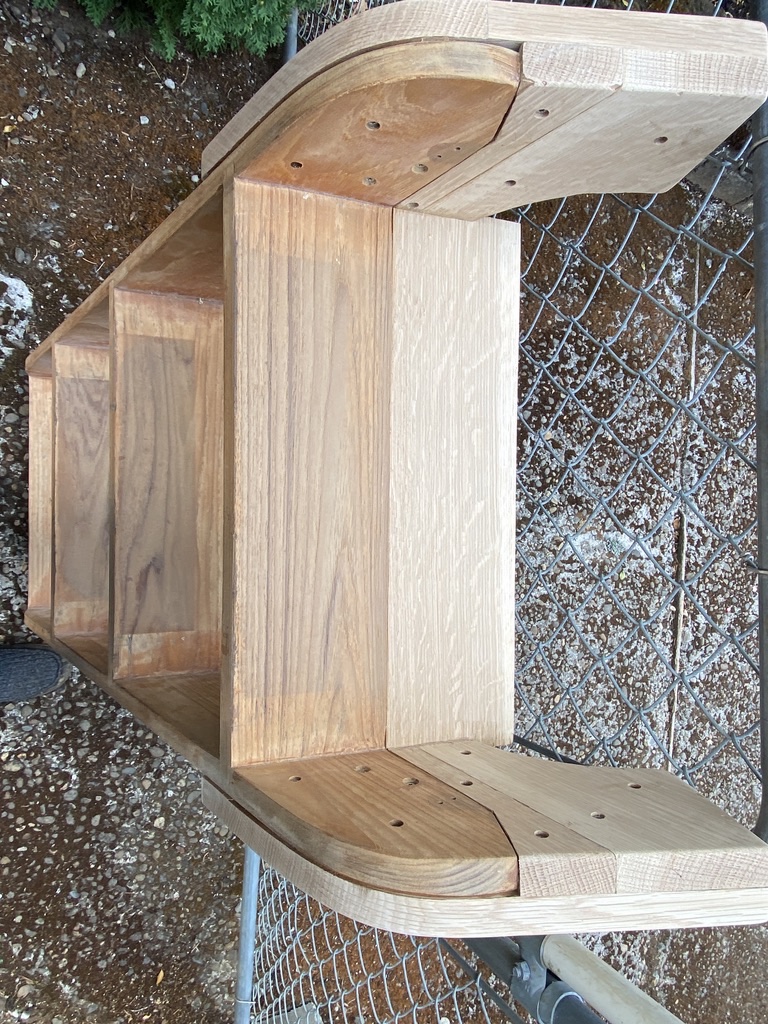

After 7 years of cruising, the last 30 months of solving the repower problem gave me time to consider the companion way steps and define the critical functional requirements.
  1. They must feel solid when in place.
  2. When stepping into the cabin, the stairs must be ahead of my body, not behind my center of mass.
  3. They need to be spaced to accommodate the majority of the crew. Not too tight, yet not too long.
  4. The angle needs to be such that you can step down while holding on to something attached to your boat.
The first step of the original ladder was almost hidden behind the companionway opening, making it dangerous to enter or exit the cabin. As you can see, I extended the first step about 8 inches, which was a terrific improvement. The original stair attachment to the boat was a couple of ladder hooks. Now, the ladder is set into a piece of oak and locked in place—there is no movement. The feel of stepping down on the solid first step is a big change.
Interestingly, the first step has a new function. I can sit on it and see out the front cabin windows. On a chilly morning, I can keep a watch and stay warm out of the wind—an unexpected benefit.
The reddish wood in the image is the original ladder. The new wood is oak. This has made the ladder a little heavier but much more stable.
Here is the finished product.
The ladder reflects the new internal color scheme I will implement over the remainder of this year.

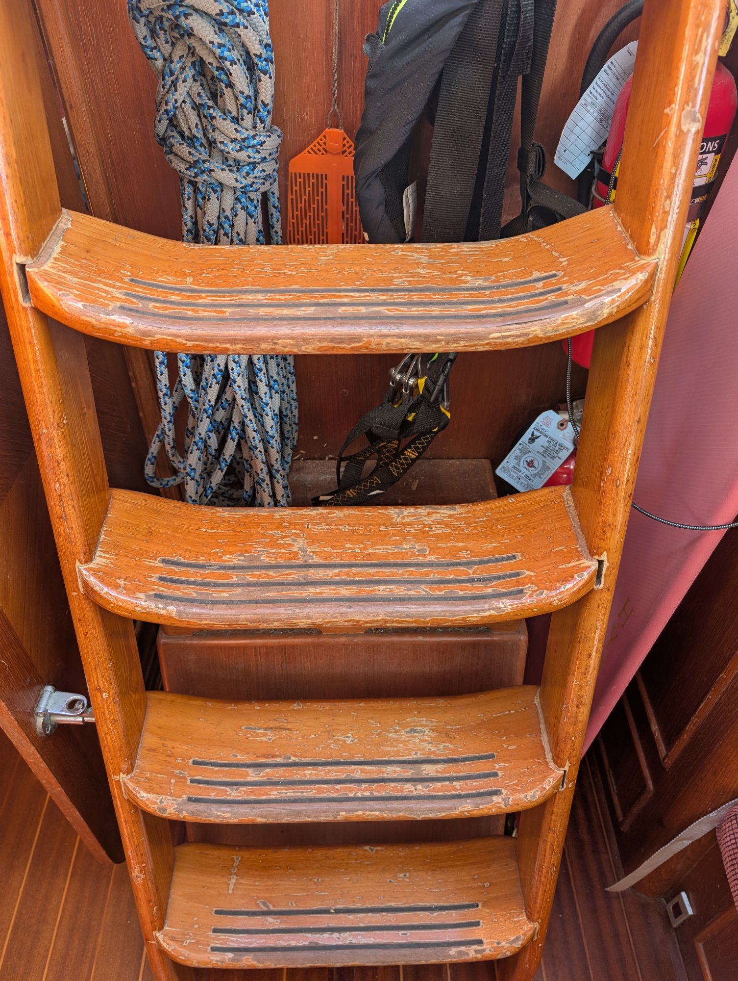

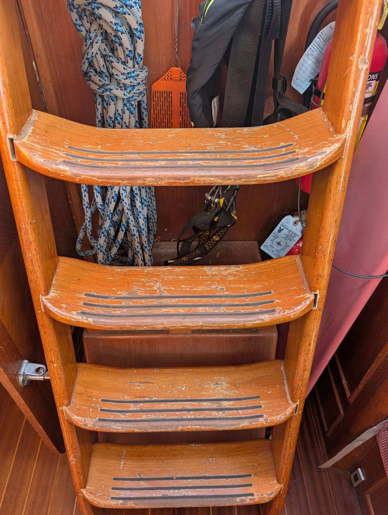

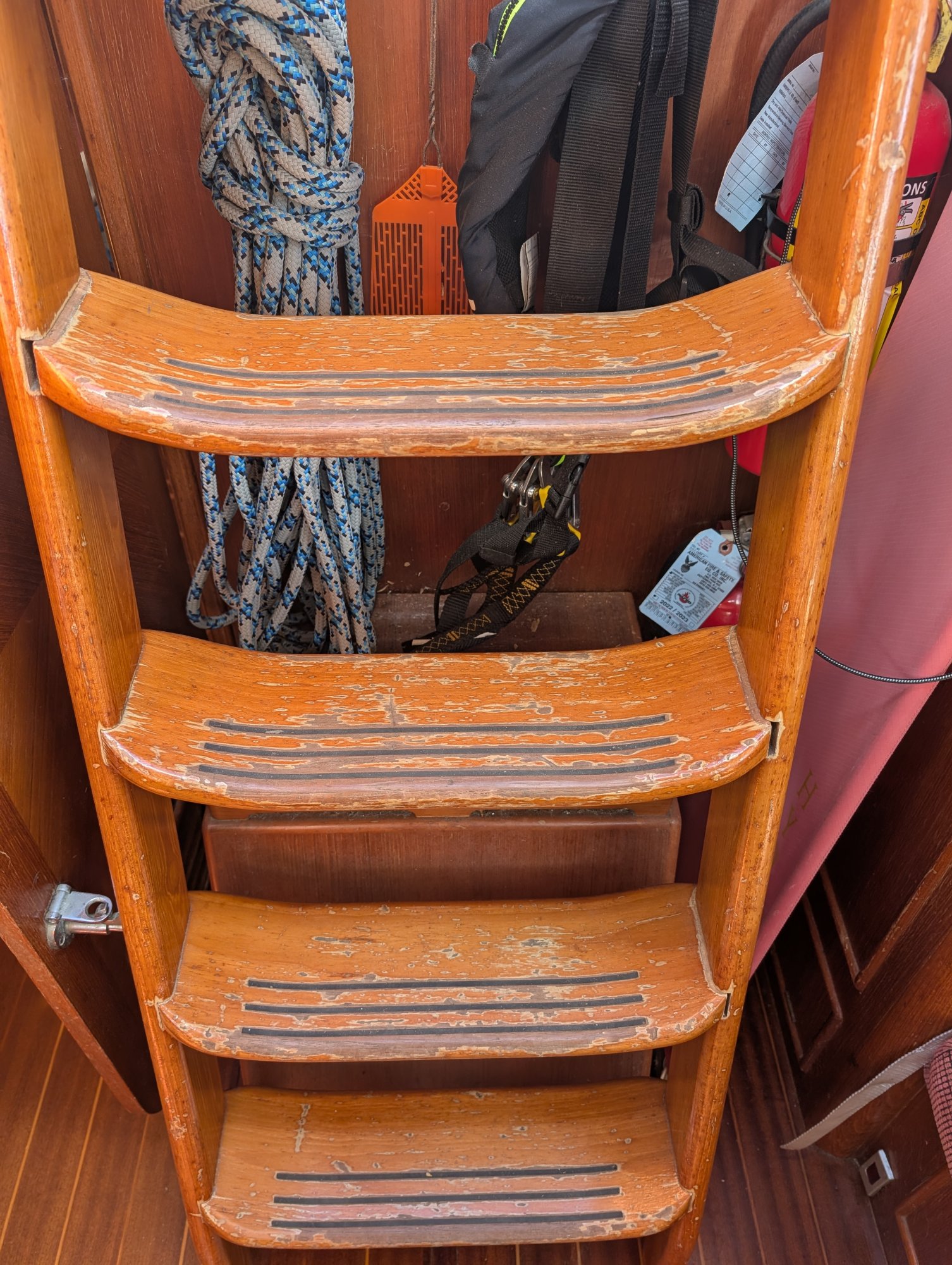

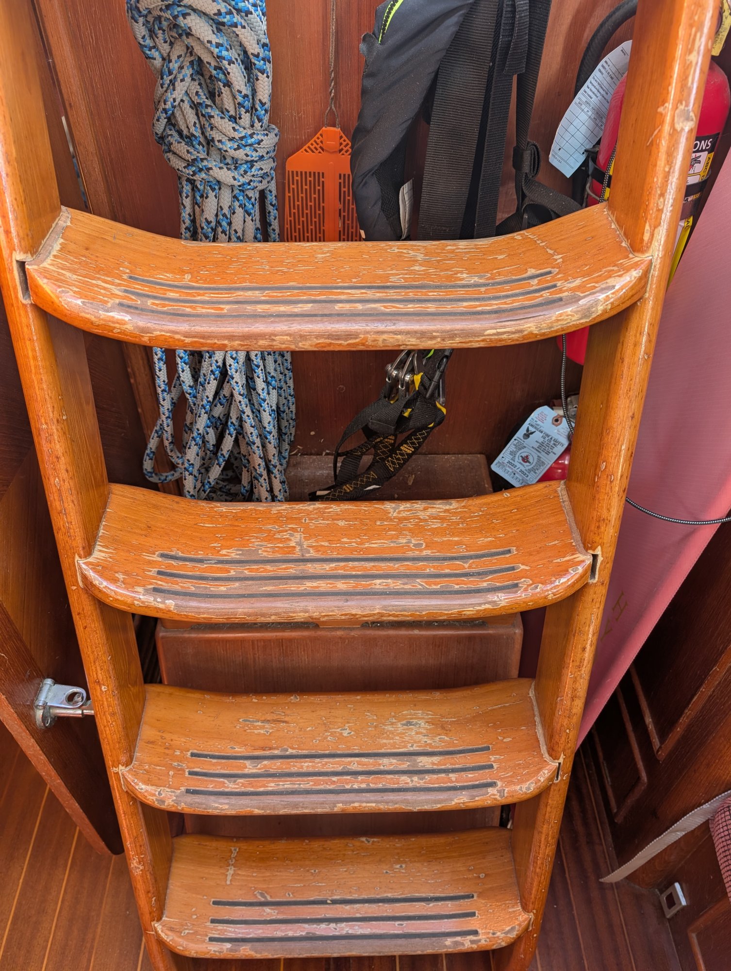

Here's a photo of part of my stairs. Note the curve up on both sides. It's very nice when sailing and the boat is healed..that curve gives a secure comfortable foot placement. Second, note the black non-skid lines across each step.. I like having some sort of non-skid on each step, especially if they get wet, and they will... Yes, I need to refinish my entry steps...PXL_20250502_150527933.jpg

Here's a photo of part of my stairs. Note the curve up on both sides. It's very nice when sailing and the boat is healed.. Yes, I need to refinish my entry steps...
Nice design! Interesting that steps are detaching from dado joints in risers; that's a hazard. Perhaps you can clamp, drill for dowels, and reglue with dowels to prevent separation in future. And yes, time to refinish! What do you use to finish?
Oh yeah - this year stair rebuild is in order. Believe it or not, as far as I can tell the side pieces were nailed, not screwed, into the steps. Hard to know for sure until I pull them apart, but from what I can see that's sure what it looks like.
The finish I use is a floor finish that does not get slippery when wet. I'll have to get back to you on what exactly it is - I used it on the floors in my main saloon - works really well. But I don't recall off the top of head what it is called. The black anti slip looks like the same material used when caulking the teak decks. But I'm going to research options when I get into the rebuild. There are shallow grooves in the stair tread to give texture.
When I rebuild, I'll screw and epoxy the entire structure together. I also will likely put in a cross rod or maybe three towards the back of the treads so they aren't so visible such the the sides will be bolted together. I probably don't really need to do that - these have lasted 40 years... But... Ya know how that goes... See a design flaw - prefer to fix for as long into the future as possible - and that would be simple....
