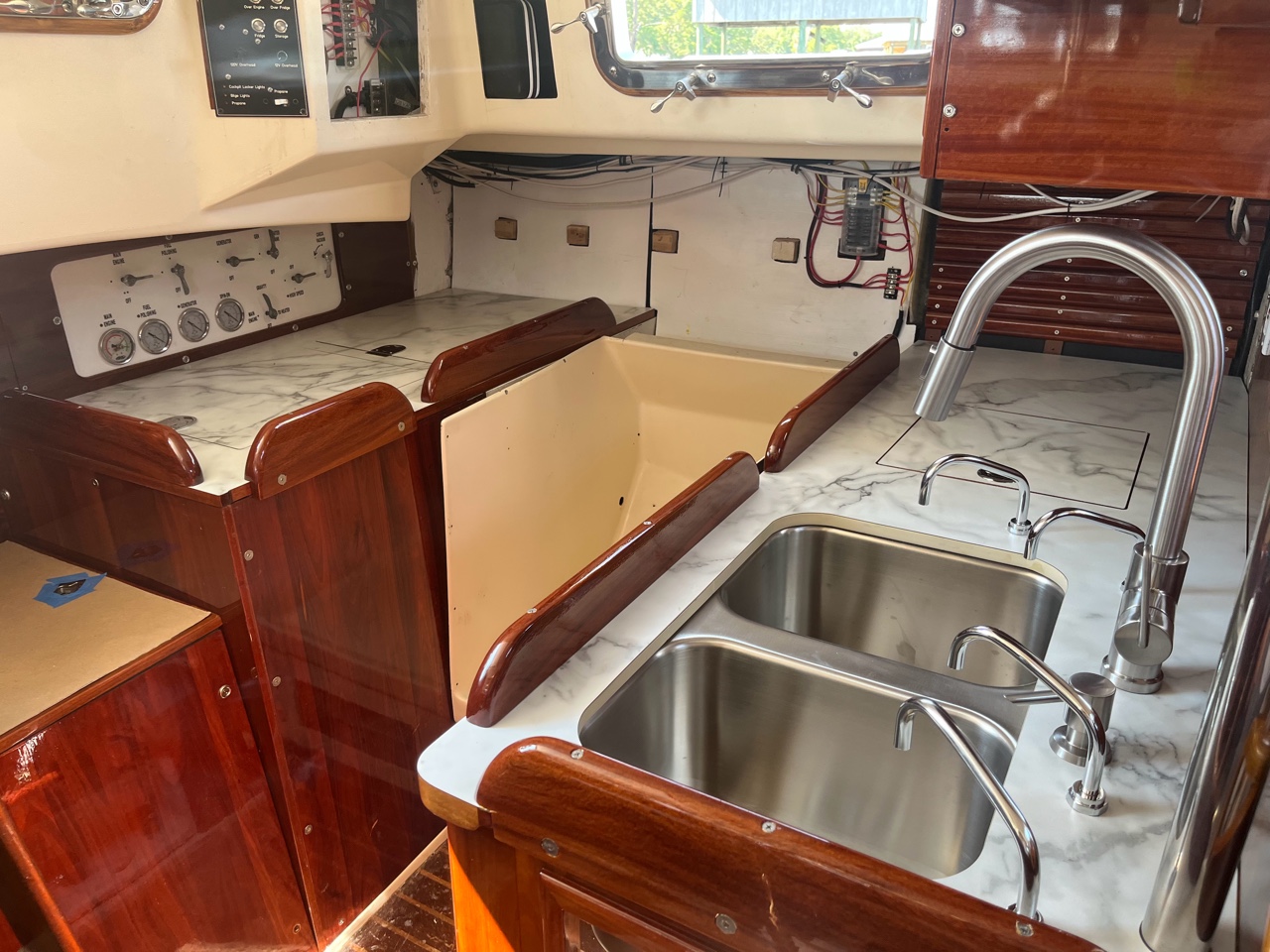

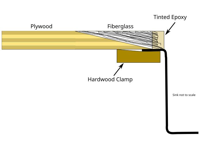

I remodeled the galley and tried to get corian, but couldn't get anyone to do the job and couldn't source the raw material, so I did it myself. I initially shunned formica because I don't like the look of the formica "end grain" visible on the edge and wanted an undermount sink. I came up with a way to conceal the formica end grain and waterproof the plywood end grain for an undermount sink.
Plywood is 3/4" marine, the edges were banded with hardwood to seal off the plywood end grain and provide solid substrate for fastening the fiddles. The storage hatch was banded with hardwood. The opening around the sink was cut 2" oversized on all four sides, then cut back at a 5:1 taper with an angle grinder and 36 grit sanding disc. The taper was backfilled with with fiberglass and epoxy to within 1/2" of final opening size. I made a rough cardboard dam to represent the final opening size, then poured tinted, thickened epoxy into the void between the rough edge of the fiberglass taper and the cardboard mold. This formed the visible edge the one sees instead of end grain plywood. Sanded everything smooth, then glued the formica. I did not want to band the sink opening with hardwood because of moisture issues.
The corner is banded with teak and routed/filled/sanded round. the formica end grain is not noticeable around sink and almost invisible on the teak corner
All faucet penetrations were drilled oversized, backfilled with epoxy, then redrilled to correct size.

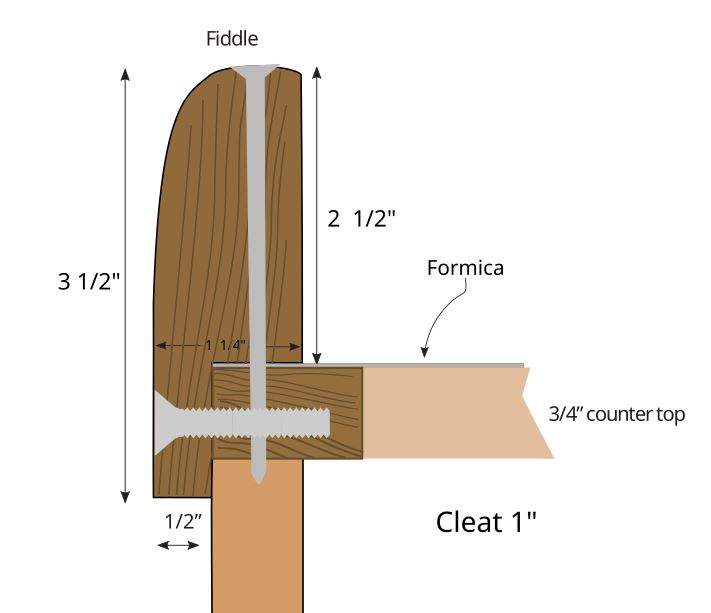

The fiddles are 2.5" tall on the formica side, and about 3.5" tall on the other side. Long #10 machine screws hold the fiddle down and 5/16" machine screws hold it horizontal. Both are tapped into the hardwood banding around edge of plywood. I didn't other with plugging the screw heads; that was too tedious for the marginal benefit in appearance. I used flathead machine screws, but should have used bugle head machine screws for the #10s. Flatheads for the 5/16" machine screws is ok for that application.
Hardwood for banding and cabinet bodies is eucalyptus. Vendor was not certain of the species, but I think it is Jarrah (Eucalyptus marginata). Only teak I used was the exposed corner. The eucalyptus is hard enough to tap and holds threads well.

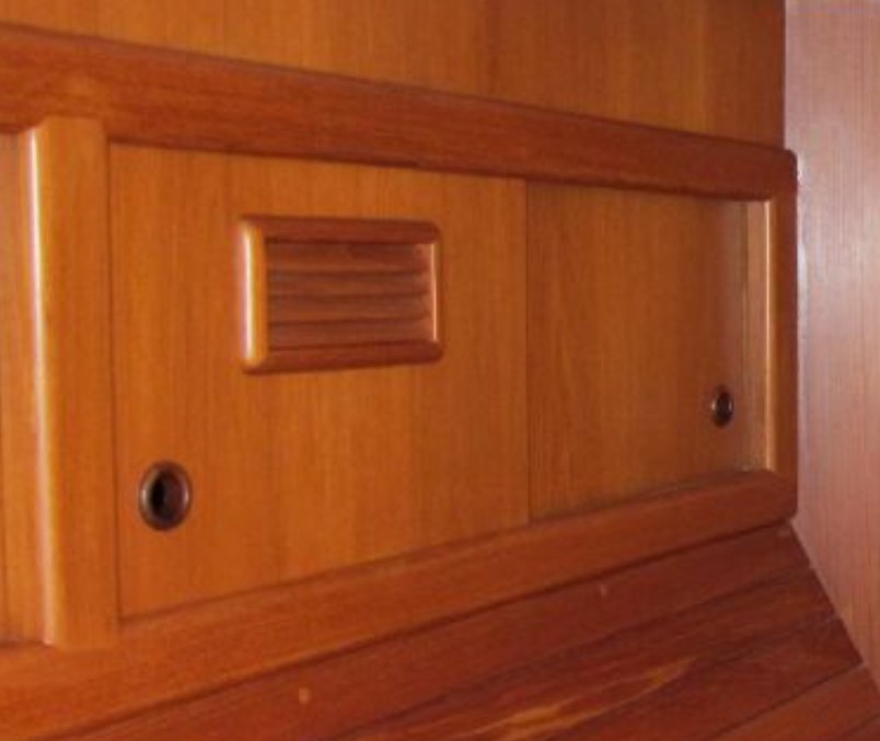

I don't particularly like sliding plexiglass, they are pretty flexible and have seen them pop out when things get feisty. They also get scratched over time. But if you like seeing what's inside the cabinet, they can work. I prefer thin plywood - lots of way to make them attractive, in my mind anyway. Here's a photo of a cabinet in my boat with two sliding doors.
But it all depends upon the look you want to create and the amount of work you want to get into..

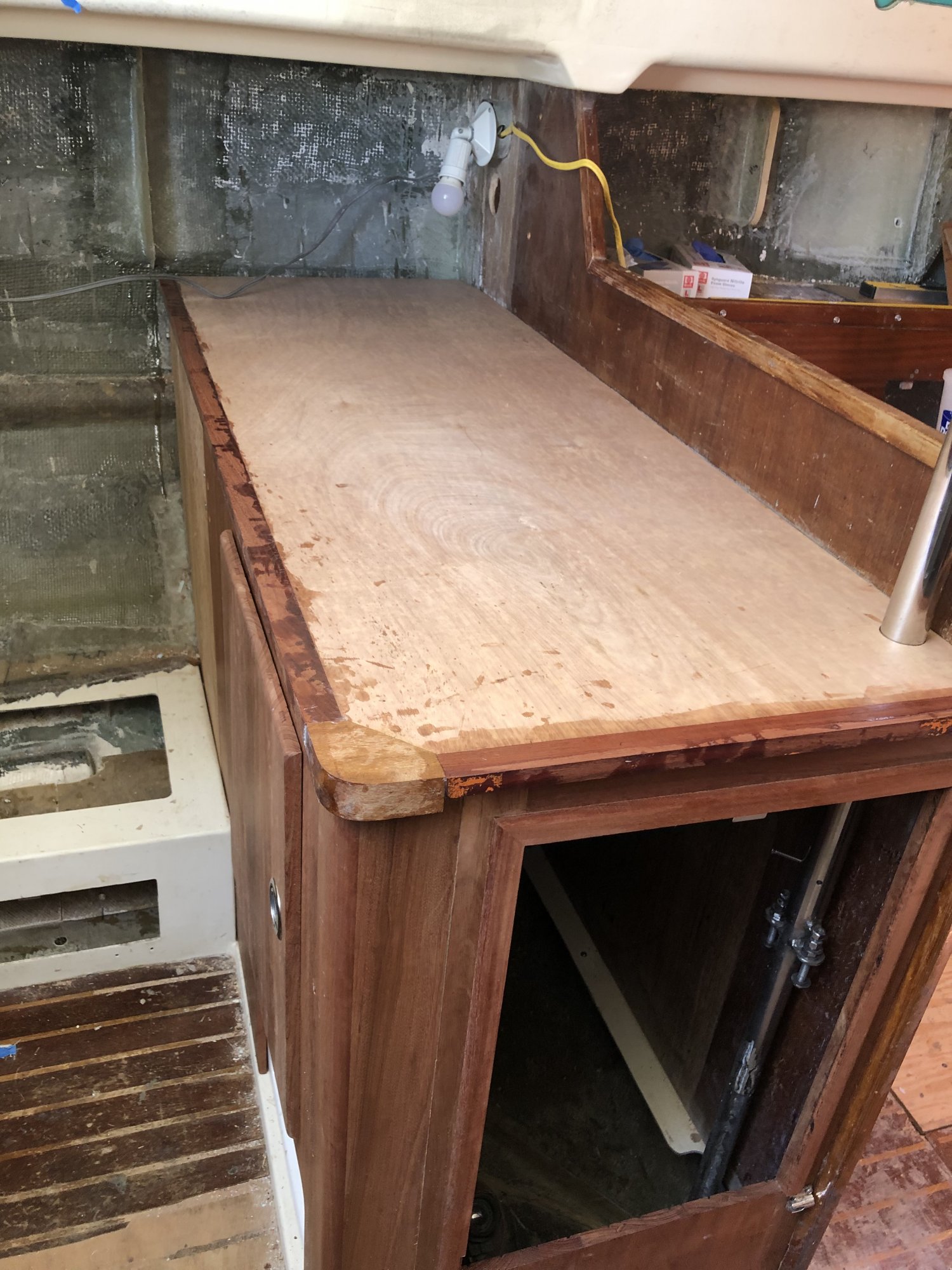

Yesterday was a very busy day on the boat
We removed the galley counter top, found a lot of water damage, I will remove and rebed 2 starboard stanchions, one on which I need to scrape the wood and fill with thickened epoxy to reinforce, the deck is a little soft according to the survey I just got done.
After the stanchion issues is filled we will install a new plywood and make new cabinets over the counter, we are still redesigning the cabinets.
while doing the demolition, we decided to remove the stairs/engine access panel; we will be making a new stair panel which will be angled with 3 steps like the previous panel.
what a difference removing the stairs makes, we can actually see and work on the engine.
The new stairs will be hinged to optimise access
here are a few pictures of our work so far
