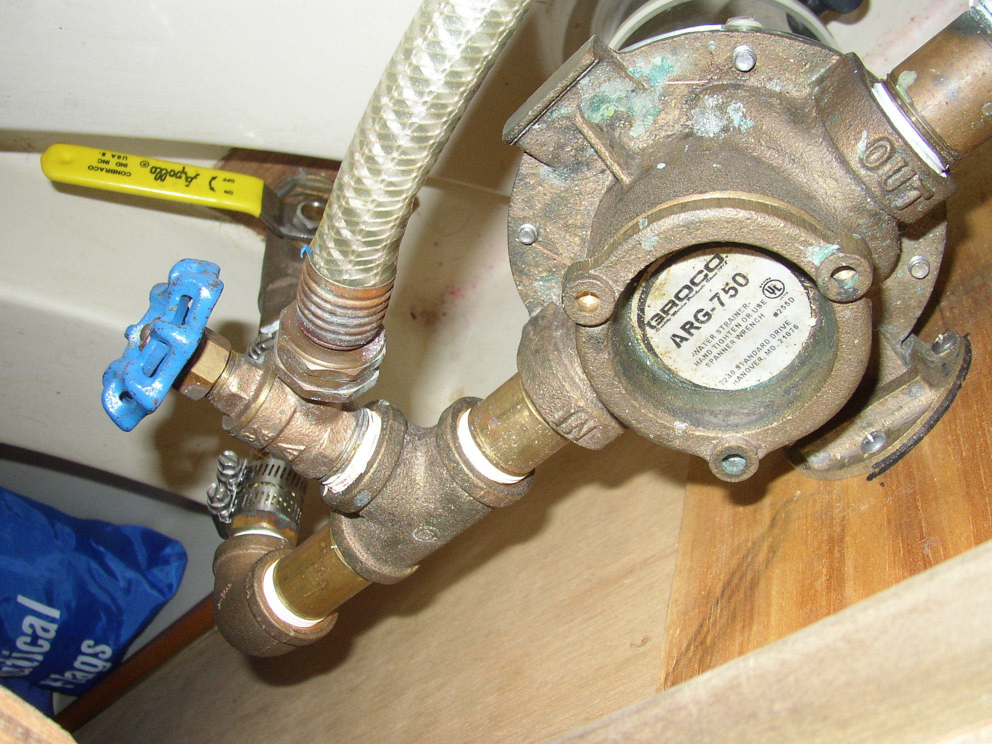

Probably less of an issue in fresh water but still should be gone. Groco makes a flush kit for these type of connections.

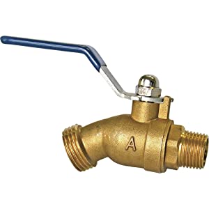

This has possibilities. Ball valve with hose bibb

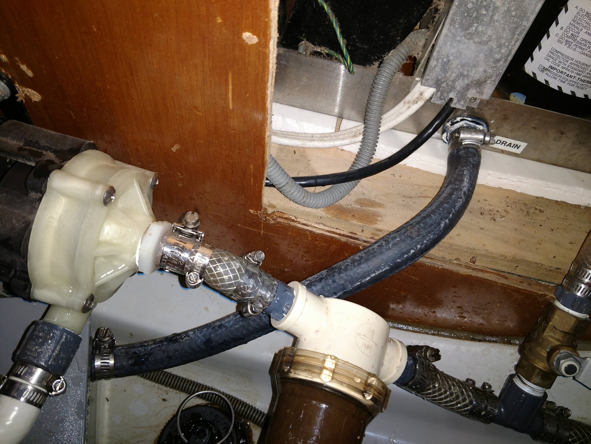

That is similar to what I have. But, no hose connection. Mine just has the hose clamped on the input end. I just stick a funnel in the end of the hose, turn on the AC compressor so the pump runs and pour in the pink stuff until it pumps out the AC outlet on the side of the boat. Best photo I have handy. Bottom right is the valve.
