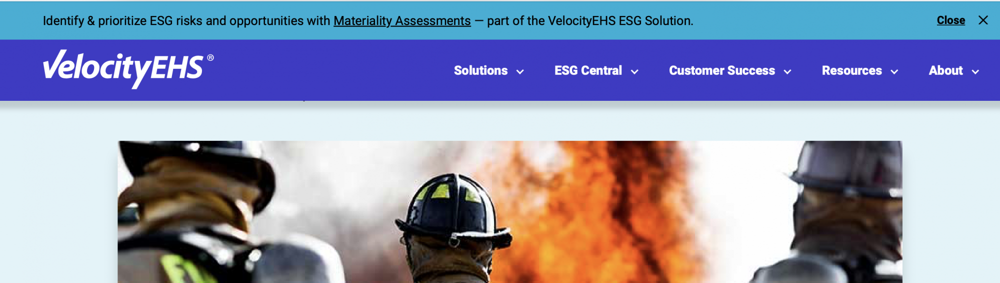

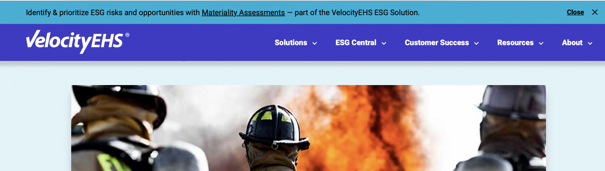

The article about the lithium battery fire that went on for two weeks is simply irrelevant to a discussion about LFP batteries on boats. While the cause of the fire was not reported, it was reported lithium ion batteries were involved. Some lithium battery chemistries present a greater fire risk than LFP batteries which appear to have little to no risk of spontaneous fire. The source of this article should also be considered. It appears to part of a marketing effort and not legitimate journalism. (See the image of the page header below.) Clearly they are motivated to raise anxiety in order to sell their services.

Mike your perspective from a fire services professional is appreciated. We both know there are risks with almost all of the components of our boats should they catch fire, those risks need to be understood and managed. And first responders need to know to what they are responding. I criticized the warehouse fire article because it offered little that was relevant to a discussion about installing LFP batteries on a boat. The main points were lithium ion battery fires (not LFP batteries) are difficult to put out and the fire company didn't know those batteries were stored in that building, oh and by the way, our company provides those management services.
