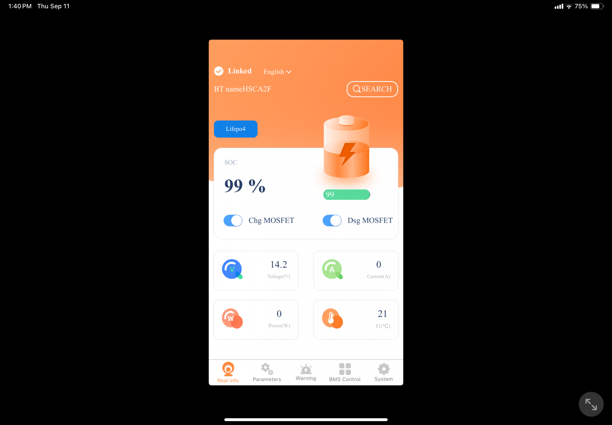

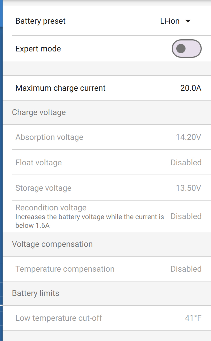

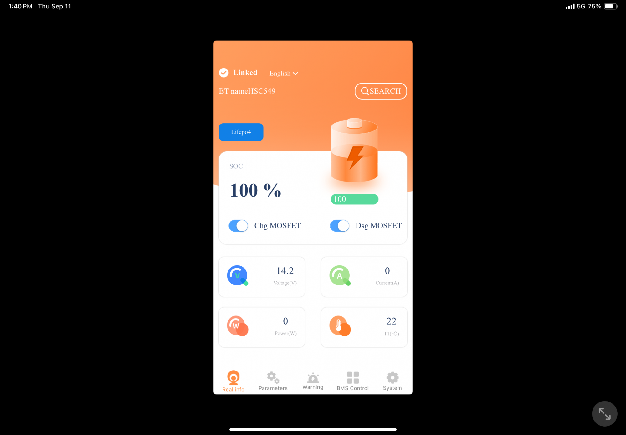

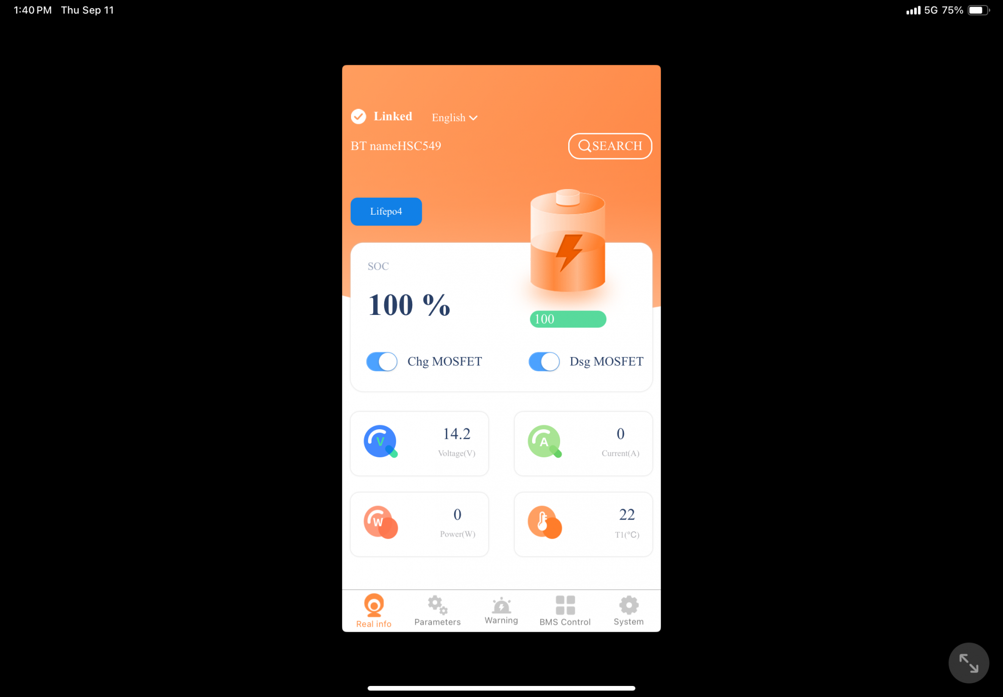

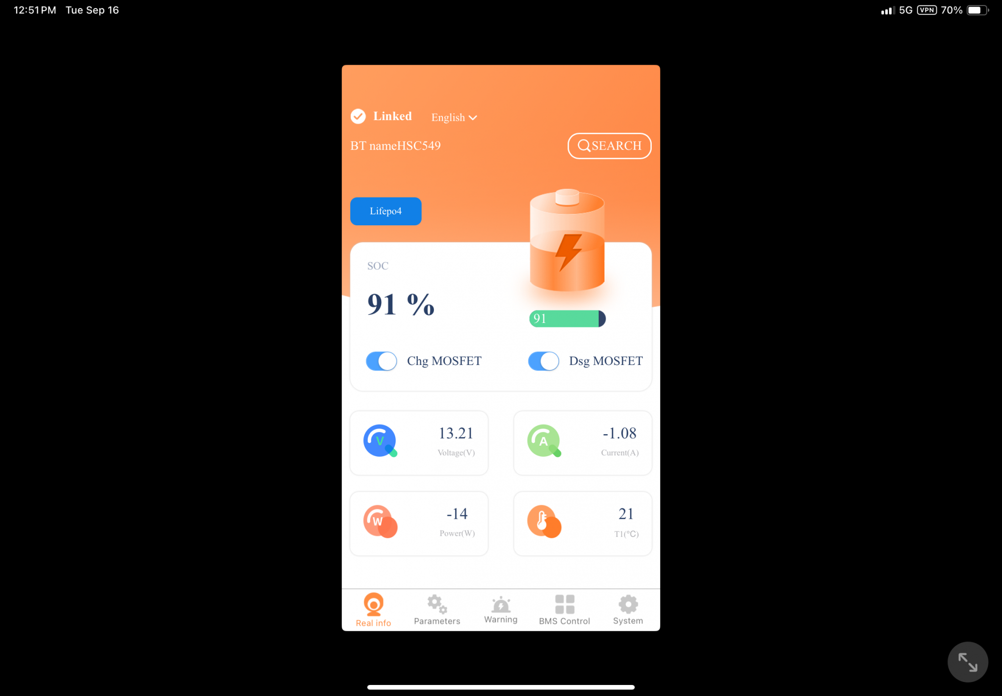

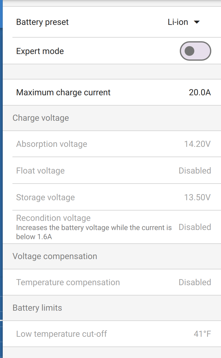

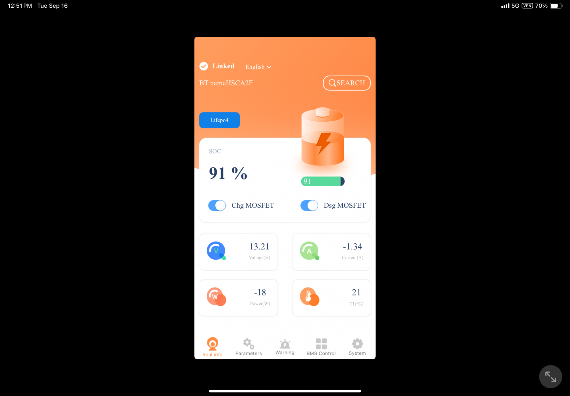

I got out to check the batteries today, and I captured the charger info as well…and I feel better today seeing the battery voltages and SOC’ s.
first, charger reports…I turned off power to go to the fuel dock and pump out, and then turned the power off again to check something else…so ypu see a few short charges most recently. But you see a few longer duration charge cycles as well.
here are the charger settings for Li-ion…
and here are the battery statuses: Both batteries had exact same voltage, but SOC was off by 1%.
neither battery “disconnected” the Charge MOSFET.
I can probably live with this for my limited power needs.
Greg
That 1% difference may be due to cell balancing. The second battery was still balancing the cells.
Nice. It’s possible one battery had a greater cell imbalance initially and needed a couple of charge cycles to get the cells closer. Maybe that was the cause of a higher level of protection preventing it from discharging before.

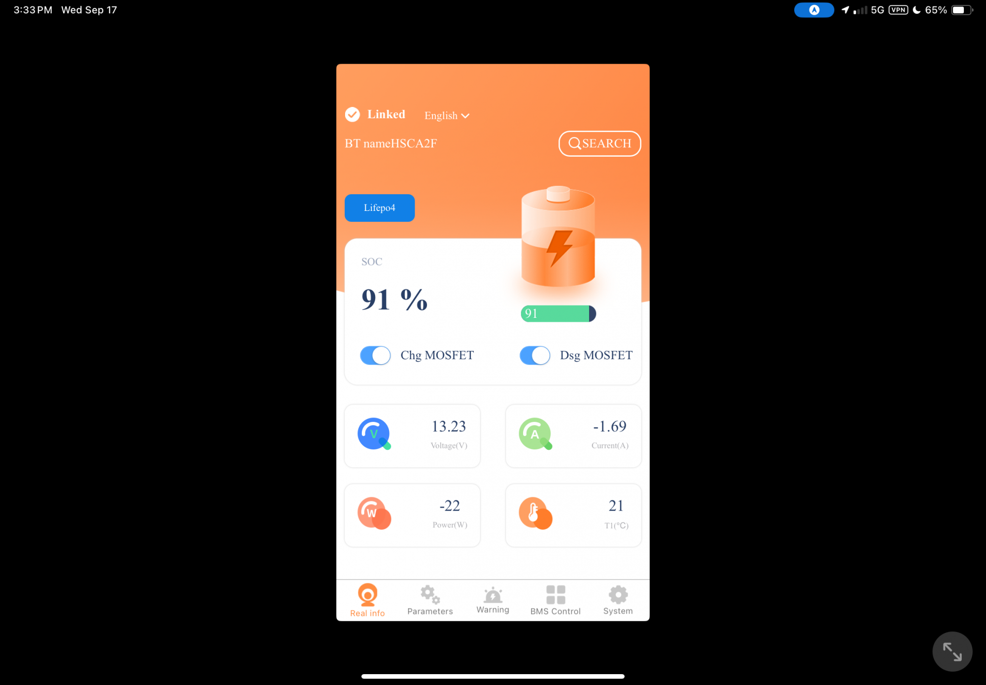

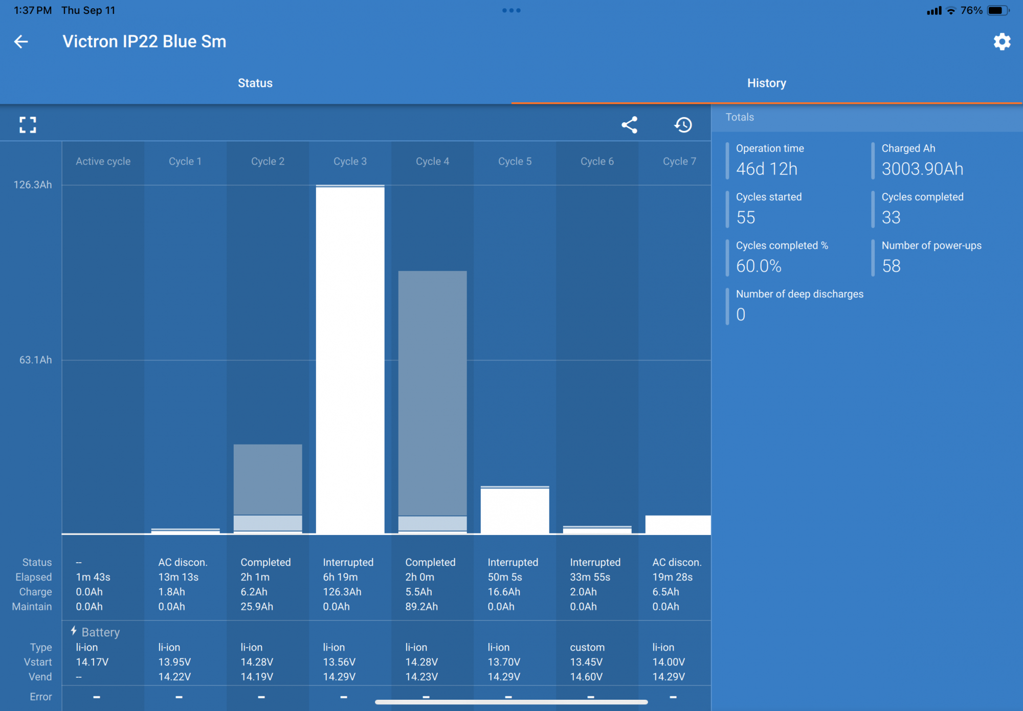

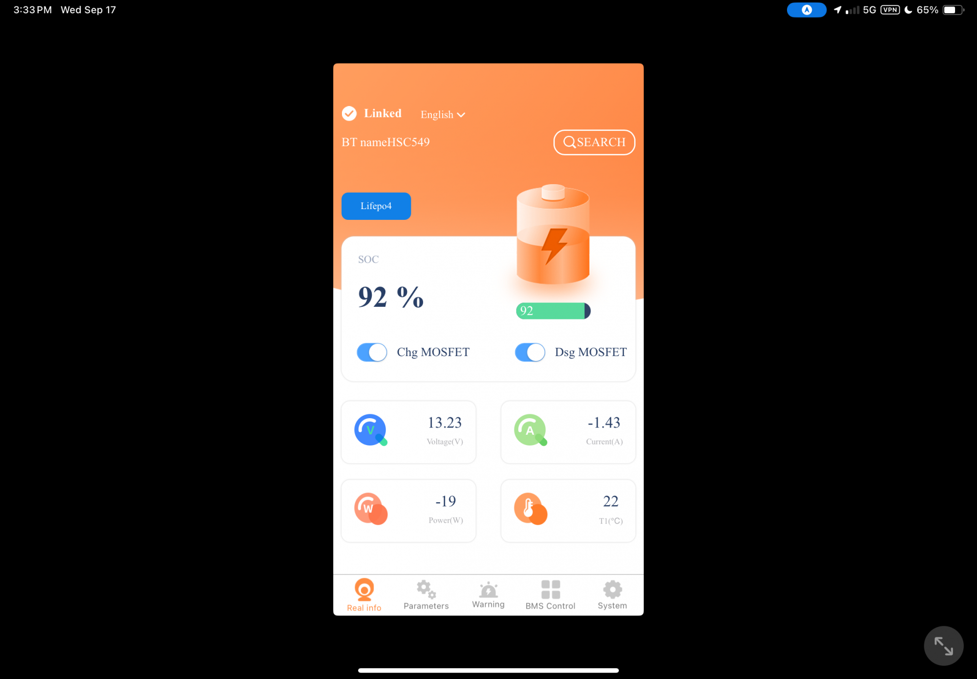

Jan 7, 2011
6,014
Oday 322 East Chicago, IN

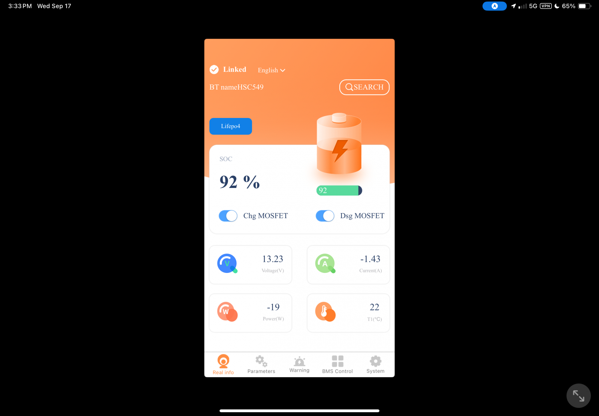

I have been monitoring my new LFP batteries for a few months now. 2) 100 Ah LIFEPo4 smart batteries, My only real issue is that the 2 batteries generally don’t have the same SOC, except maybe after charging them independently at 14.6 volts (per mfg recommendation).
But despite the SOC issue, the batteries work well and typically share the house load just fine, and almost always have the same voltage . After a sail…
And today after sailing 3.5 hours…
I have yet to have any concerns about heat or fire with these batteries.
