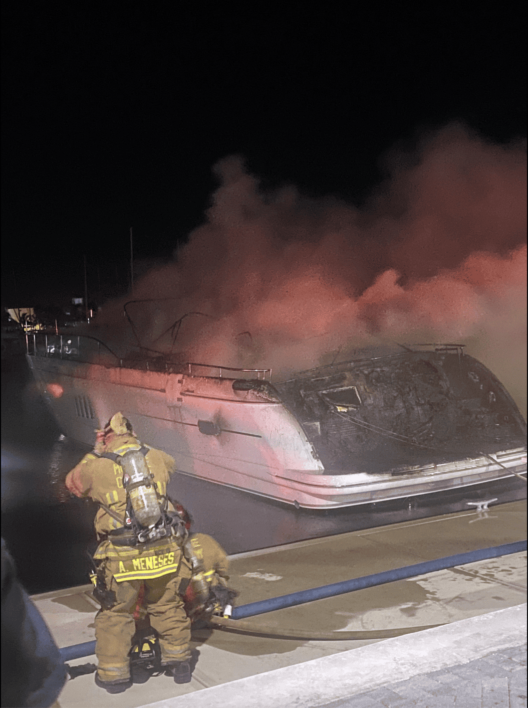

How about the NTSB report ? https://www.boatinternational.com/yachts/news/visionf-82-yacht-fire-miami-flagship-battery-explosion
Flooded lead acid batteries can explode (I've seen the aftermath), but they don't burn internally. The vented hydrogen though, can ignite if ignition protected equipment is not used and the batteries are not properly vented. Yes, there will be acid everywhere... The question is not whether Lithium (lifepo4) is safe, not safe or safer than Flooded/AGM, just that they have different installation considerations, which are reflected in published marine electrical standards and in manufacturer's installation instructions.

A quick read of the first case found this statement. "The agency found that Flagship's inoperable battery management systems led to a practice of manually charging the batteries with a portable charger, which compromised their safe monitoring. "
With no BMS, there is no control, and manual charging is never prudent. Stupid is, as stupid does. When you bypass all of the safety gear and end up with an unsafe condition, that really is no big surprise. FLA will have the same problem if you have unregulated current going to a fully charged battery.
The container ship fires are not from LFP batteries. Most cars use other chemistries which is very susceptible to fire in order to have greater energy density.

I guess it’s fair to say that was caused by the batteries, but in case anyone just sees the link and doesn’t read the article, this is a pretty key caveat - “The agency found that Flagship's inoperable battery management systems led to a practice of manually charging the batteries with a portable charger, which compromised their safe monitoring.”
