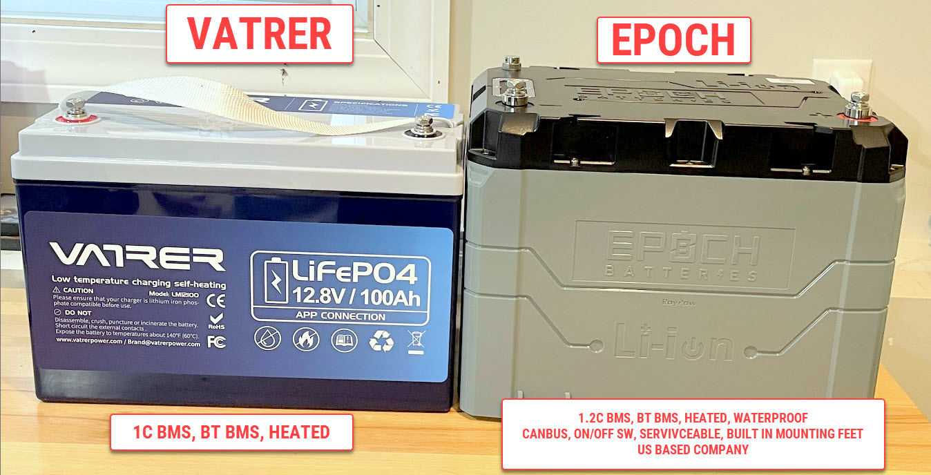

Mid to high quality marine lifepo4 batteries can be procured from Victron, BattleBorn, SOK and Epoch. SOK have a built-in fire extinguisher. SOK and Epoch have CAN-BUS (Victron) communication to regulate the charge voltage and current, which avoids inadvertent BMS disconnects (if you have a Victron ecosystem onboard).
