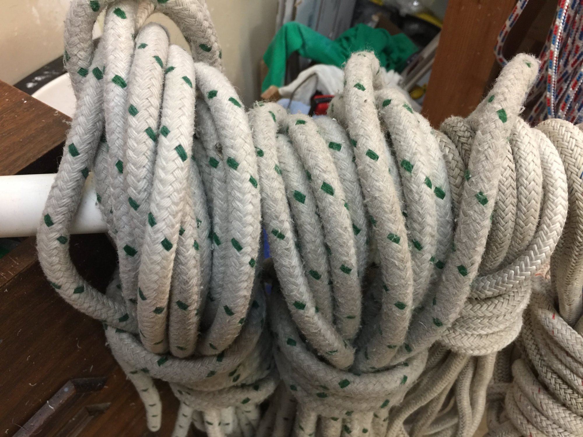

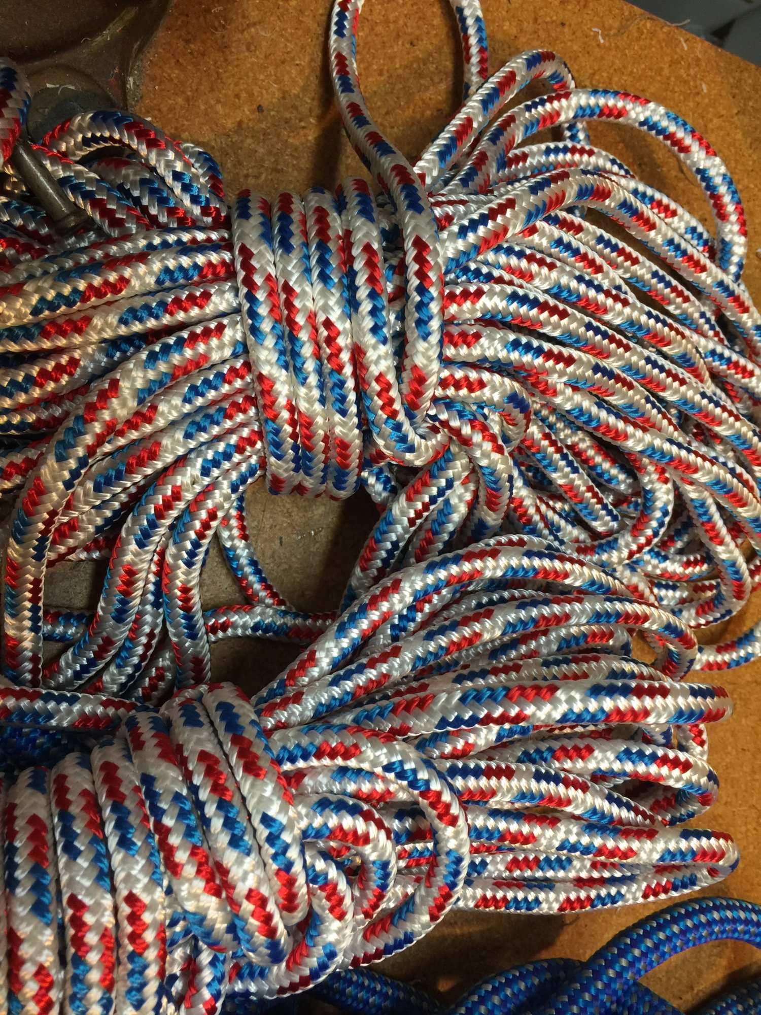

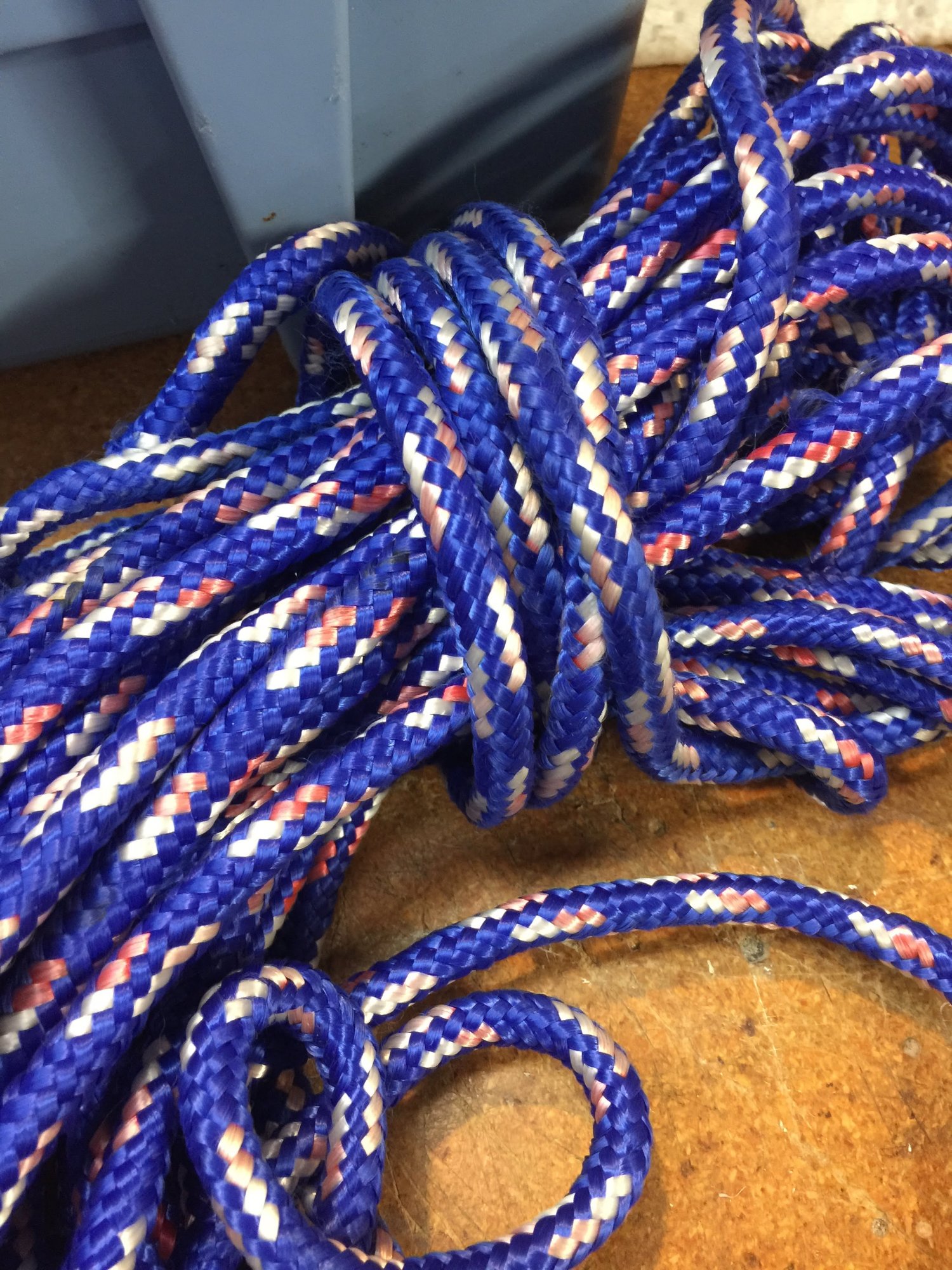

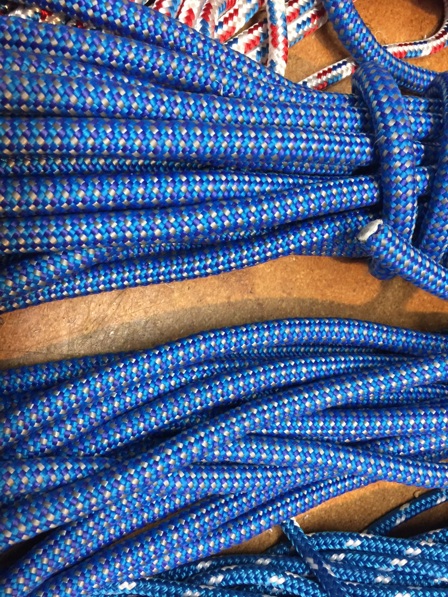

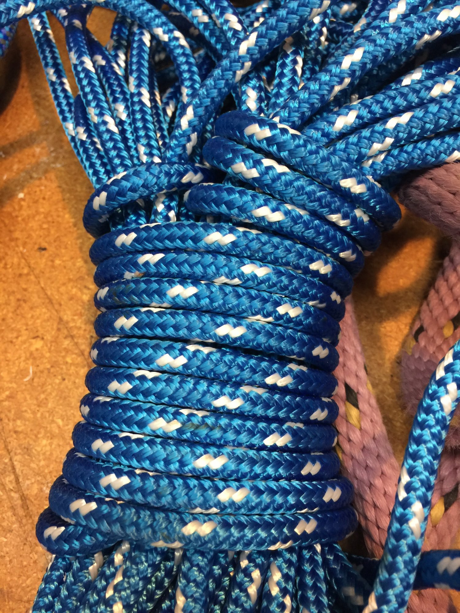

I purchased a 27' sailboat and there were a number of lines on the boat other than mooring type lines.
A rigger looked at the jib and main halyards when I was having the bottom painted and stated the lines were to small to risk having someone use them to go up the mast. He said I needed 5mm or larger lines. I have sailed the boat using the halyards, so they were adequate for raising sails at least. This has me questioning the quality of the other lines on the boat.
Is there some way to look at the lines or cut into an end to see if there is a certain type of core or braided line inside the outer covering to determine if the lines are junk or worth using?
See the photos attached.
Any thoughts are appreciated.

Hi Rick
You mention that the rigger suggested 5 mm or larger halyards.
Are you actually using a line smaller than that? If so how on earth do you handle it?
The lines in the photos look fine to me , although I can only guess the diameter.
As for me, when I feel the lines turn to dust in my hands, I dice them and get new ones.

That purple line looks questionable to me almost looks like a hardware store line. Yea cut 4" off and check core if there's not another brade of rope under there move to garage as a handy tie stuff up rope in back truck or something other than boat
From here, those look good. Here's a video to help determine the materials used in their construction.
Hey, that guy's wearin' a pinky ring!
Likes: dLj
14,183
On quality rope, such as that from Yale, NER, and Samson the color and the tracer pattern is unique. This helps to identify the rope which helps to know a rope is suitable for its intended purpose.
Generally, line that is chafed or worn looking needs to be replaced as well as line that gets stiff and hard. It also depends on the lines function. Old lines often make good fender whips or tie down lines where the loads are not that great and failure does not risk the boat or anyone getting hurt. The rope's strength is in the core of the rope, not the cover. so a little wear like on the white line w/green tracer is nothing to shy away from. However if the wear is concentrated in one area or the line is no longer even, i.e., you can see bulges or voids, the line should be tossed in the trash that would be evidence of core damage.
8mm line is about 5/16" which is small for hoisting someone up the mast, unless the line is dyneema which is incredibly strong. The other issue with halyards being used to hoist someone up a mast is how well it will hold knots. Dyneema fails in this category.
Some of your lines look to be of uncertain provenance. Images 2323 and 2325 look like hardware store line. The colors are too bright and shiny. The line in image 2325 looks particularly suspicious. Compare the weaving of the cover to the other ropes, the threads are not all that tightly woven. There are many loose individual strands. The better quality lines, like the white with green tracers have a cover woven with thicker tighter yarns. Another clue for cheap line is the inability to melt the ends. However this is also true of high tech dyneema lines.
