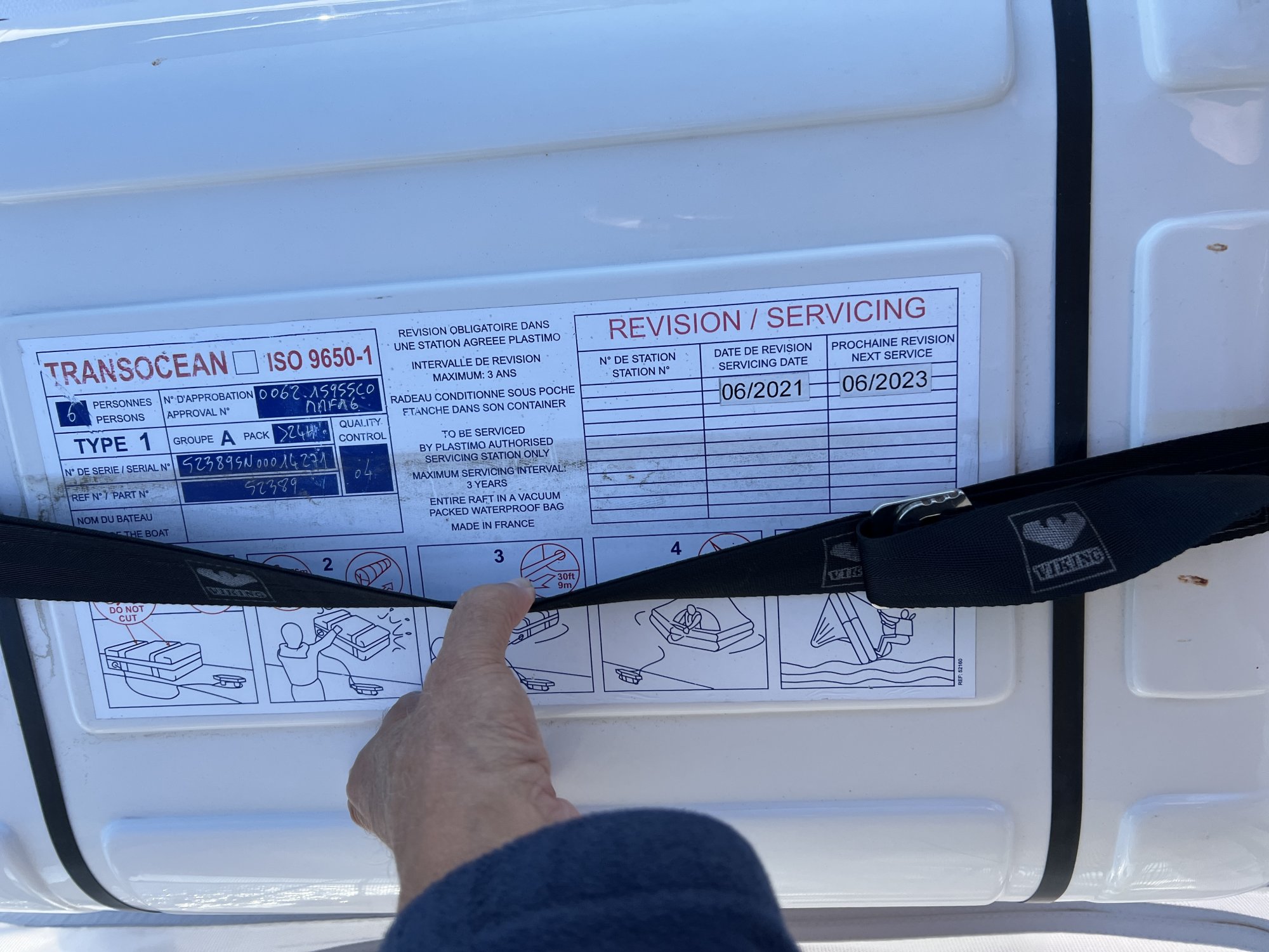

I use a Viking Solas A 4 man life raft. Solas A is the rating for more than 200 miles offshore. It's the highest rating. Supposedly carries enough supplies of food and water for the 4 people for at least 48 hours. I'd rather not find out how close they calculate that...
As my boat had originally a life raft location right in front of my mast (I had to modify it for the Viking but it was almost perfect), I also went for the self-deploying option. Which means if my life raft goes under water, it self-deploys. It seems to know the difference between breaking waves over the boat and being submersed. No idea how that works, but I've certainly tested it! (Well, not being fully submerged, I guess, although one storm I went through Id sure like to know how it didn't self-deploy!)
I can also deploy it manually. I think mounting on the stern is a better place, but I couldn't easily do that and my boat had the location already set up for it. I a previous off shore boat, I had the life raft mounted on the aft pulpit - cut the connection, drops in ocean. It would harder to manually deploy from my foredeck - they are heavy - but it wouldn't be excessively difficult.
I did not feel a soft cover would be the way to go given how heavy they are and my boat layout. I think some of those decisions depend on your boat layout.
The Viking Solas A raft is what most of the GGR sailors carried - I figured they know more than me about them - hence why I choose the Viking.

I looked at this life raft before choosing the Viking. Note it does not list SOLAS A or B rating. It just says 24 hour rating. Since, when I was looking, the Viking stated SOLAS A rating, and it was less expensive than the Plastimo - I went with the Viking. Pricing may well depend upon where you are locates. I was comparing pricing delivered to my boat. I also contacted the companies I looked at and asked for a complete list of what was contained. That way I could build my ditch bag knowing what was inside. I agree with Mark - just build your own ditch bag....

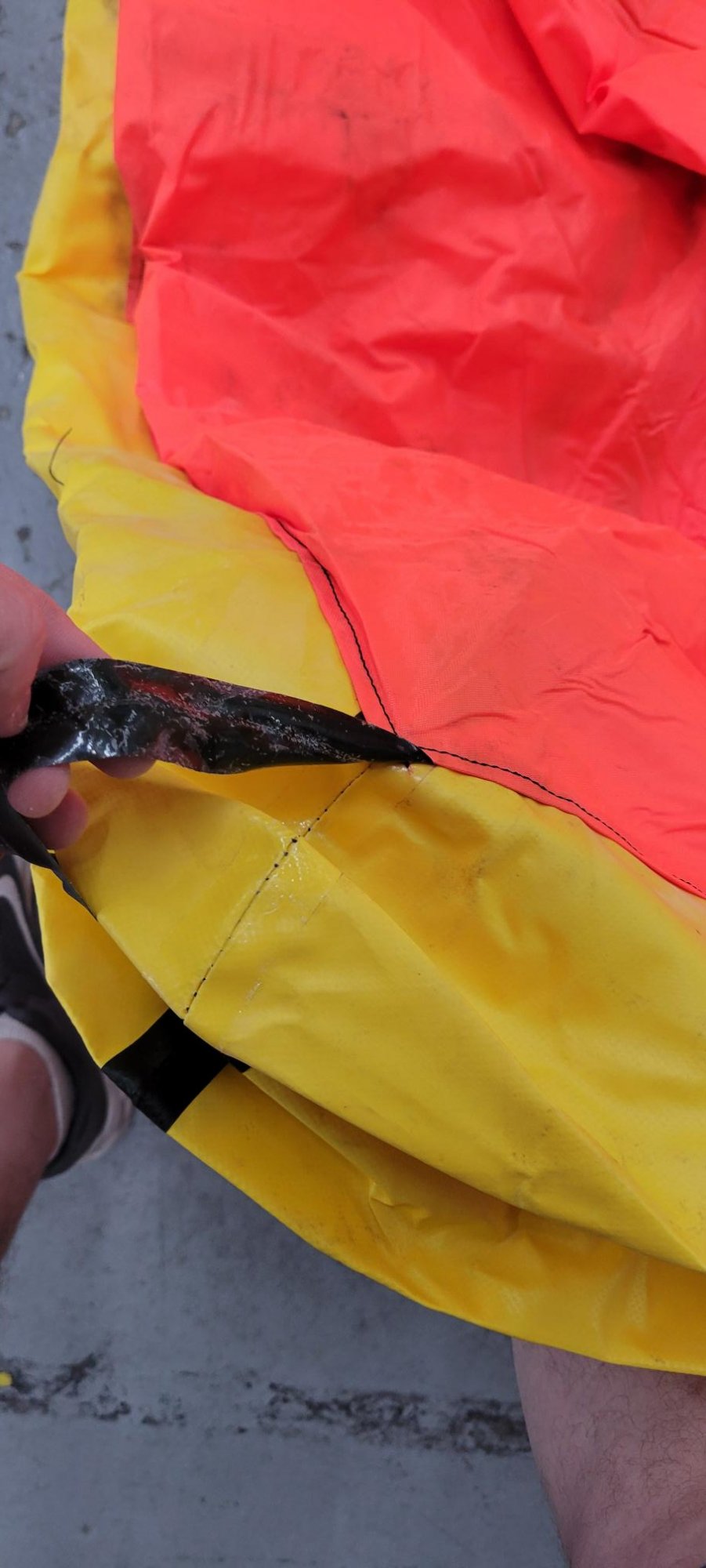

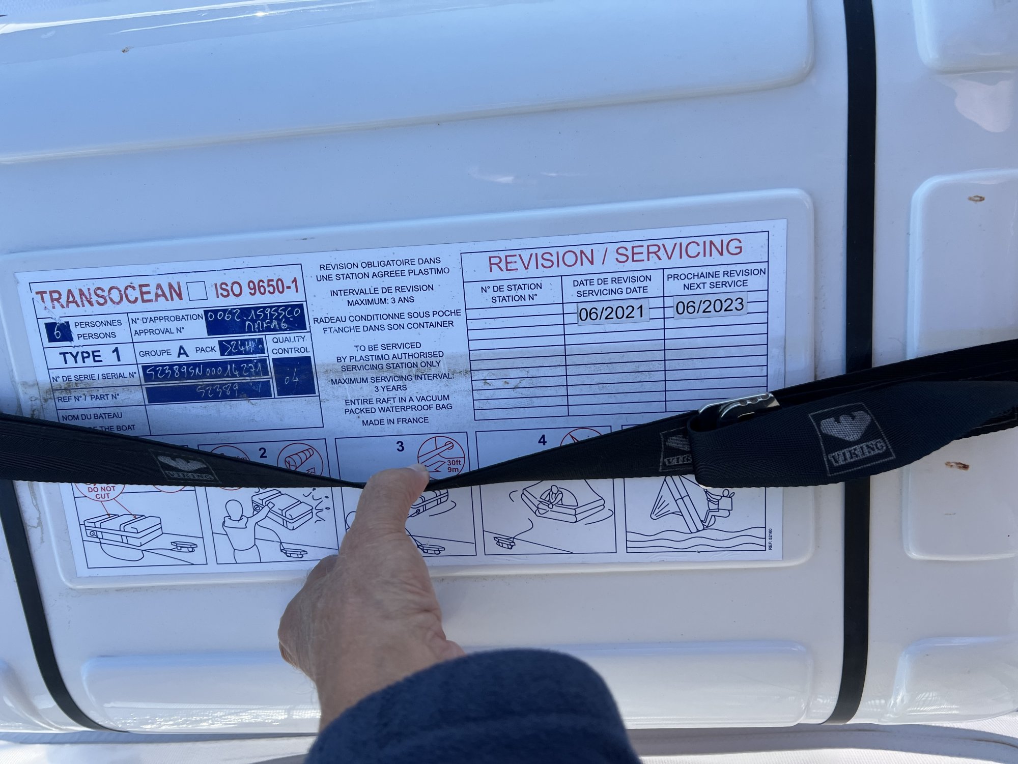

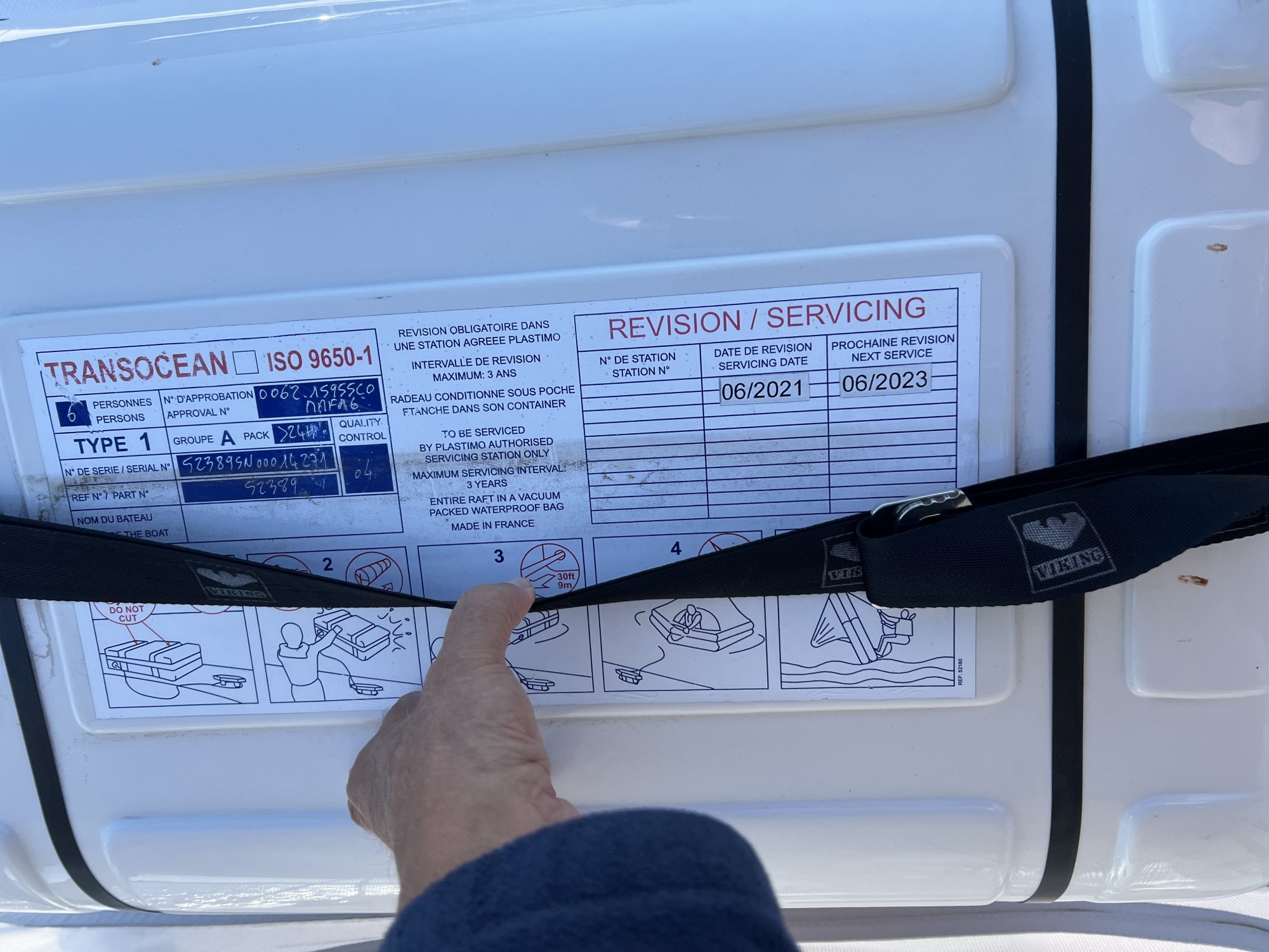

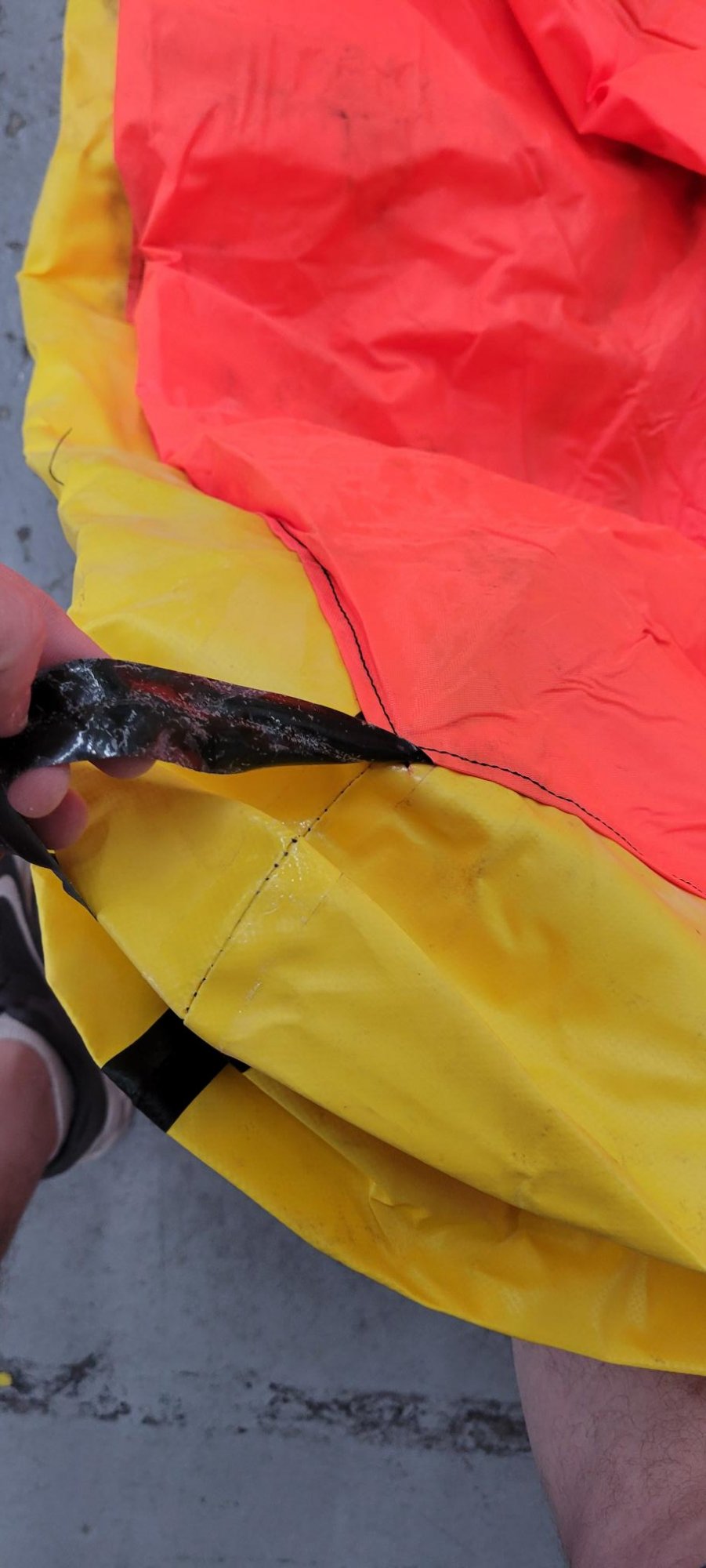

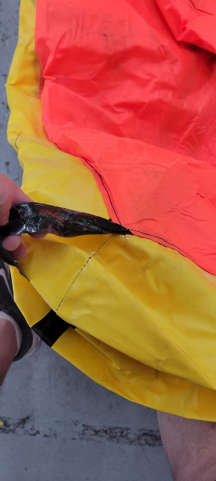

My Plastimo life raft which was placed in initial service in 2016/2017 was due for its second inspection in 2023. I waited until ‘24 and the servicing vendor (Life Raft & Survival Equipment Inc. of RI) told me the seams were coming apart and it wasn’t worth re-gluing. Mark’s comment about welded seams rang true as something to look for.
Likes: GeneraiT001
That kinda sucks. You'd like to get 20 yrs for the money (with regular maintenance).
That really sucks. I have to recertify mine but am going to wait until next year most likely as it's too late in the season now. I'm wanting to go with it and watch the entire repacking. I believe most places will let you do that. I'm sure hoping mine is still in fine shape.
