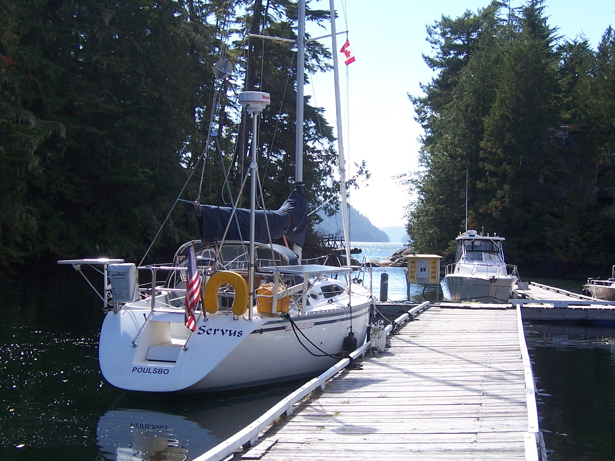

One thought, looking forward to installing a pair of solar panels, would be to have two stanchions made, one for port and the other for starboard, but without the taper like the OEM models. Place them just forward of the pushpit then run a 1" SS tube from the stanchion to the pushpit to hang a swing-up solar panel on each side. Mentioned straight-tube stanchions so one can attach a typical standard 1" fitting for the horizontal tube. Panels will have to be high enough to give access to the stern cleat.
Note: We don't have the horizontal tube but wish I had. Used some plastic wood instead as a temporary setup back in 2006 and it's still there, so I guess that's another option. Really helps being on the hook and not having to run the engine to charge the batteries. In fact, on a rainy day the 130W panels put out enough to keep up with the electrical demand.
