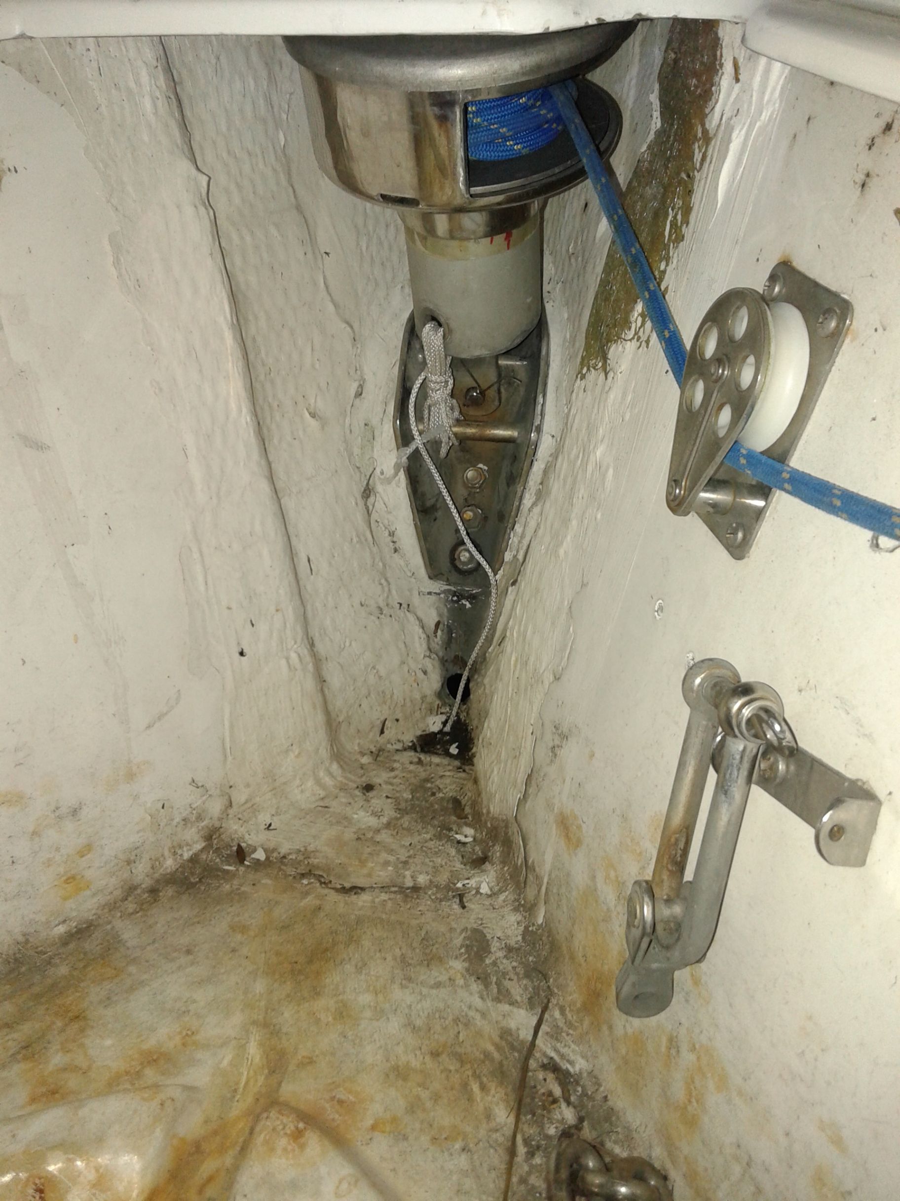

Hi,
I am a new member from Hungary and would like to greet all of you out there. I recently got a 1992 Hunter 35.5 Legend. I found her in the Nederland and now assembling on Lake Balaton and ran into a problem.

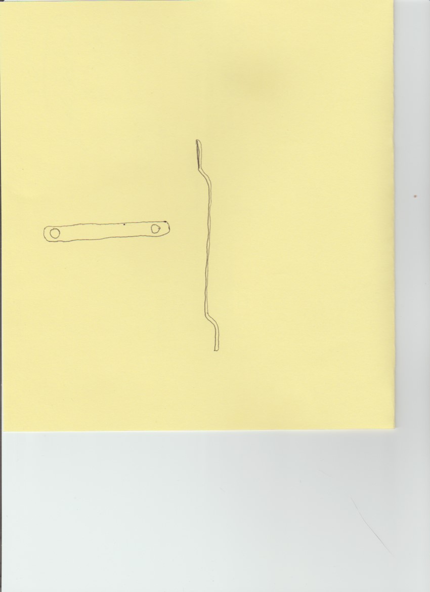

When hoisted the headsale the furling rod in the center of the drum as attached do not stay in position therefore provisionally we tied a rope to avoid moving. However, it does not seem to function properly. We found later on top of the pack of chains a piece shown on the right and maybe this is the piece should be attached. However, the pin which presently holds the furler is 10 mm in diameter and the hole on the piece is smaller, so it is unlikely they will fit together. Other problem is, that the mast has no rake in it and it may be connected to the problem described above. I understand mast rake in Hunters is controlled by only the length of the furling system and if it is shorter it pulls the must forward.
Can you help me please?

check the download section for your furler manual, Hood SeaFurl. the furler is unstalled over your forestay. the line you show only does two things; prevents rotation of the furling drum outer and limits its upward movement. rotation would potentially foul the furling line, and halting the base allows jib luff tension adjustment. the shackle pin looks to long, your lead to the drum looks better as tied currently.

It looks like your missing more than just the pin, the furler should be attached with a toggle that has a slight bend at either end. One end is attached to the same pin that hold the forestay and the other end goes inside the drum where you have your line attached now. It is held in place by another short clevis pin and a split pin. The piece that you show on the right will work I believe, the larger end with the pin will go around the steel shaft under the stay shackle and the small end with the appropriate pin through the drum. You should be able to rake the mast aft with stays. Do you have a back stay adjuster on the boat.

Thanks for your reply. Yes we have a backstay adjuster going to the top for mast bending. There are very few Hunters here (mostly hungarian makes and Bavarias, Benes and Jeanneaus) and riggers do not really know Hunter boats. The manual only gives a picture without any details or explanation. It says: furling attached to stemhead fitting. Unfortunately I was not present when the boat was prepared for transportation. Can you send a picture or drawing regarding what you are suggesting to help the rigger man? Thanks again.
Many thanks. It appears that furling drum rotation on my Hunter can be stopped by upplying one or the other suggestions. The mast rake issue is still not clear to me. If I tighten the backstay adjuster it puts too much bend in the mast top without producing any rake. However, if I tighten it further, it makes more mast top bend and no rake and the mid section start bending forward which is obviously should be avoided. Is it necessary for a legend 35.5 to have any mast rake or it is fine when the mast have none? Perhaps someone heving the same boat might be able to answer based on his experiance. Or if it is necessary he might tell me how he made it work.
