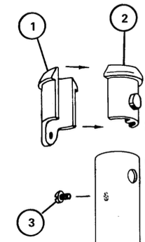

John, When you remove the "spacers" being talked about, the furler tube will actually be totally released from the furler drum and bottom bearing assembly. Typically, the furler tube will then lower until it hits the turnbuckle, and the drum and bottom bearing assembly can be lifted (slides easily over top of the furler tube) as high as you want....
Ahhhh...... after reading this several times.... I think it's coming back to me now....
Realize, it's been a long time. Thinking about it some more, I had a real problem removing the Tack Socket. The part (Number 2 in the drawing) would NOT come out! It was like a millimeter shy of being able to but it just would not clear the tube. I had to go up the mast and take the Top Bearings out in order to raise the foil up far enough in order to access what ever it was in the drum area.
Sometimes (often?) what should be just a ten minute job on a boat turns into a multi-hour ordeal.

yeah John, it is a close fit, but it will once #1 in the drawing is out. Tilting the drum over could be problematic in confined spaces like you have, sometimes the BFH needs to be pulled out of the toolbag.

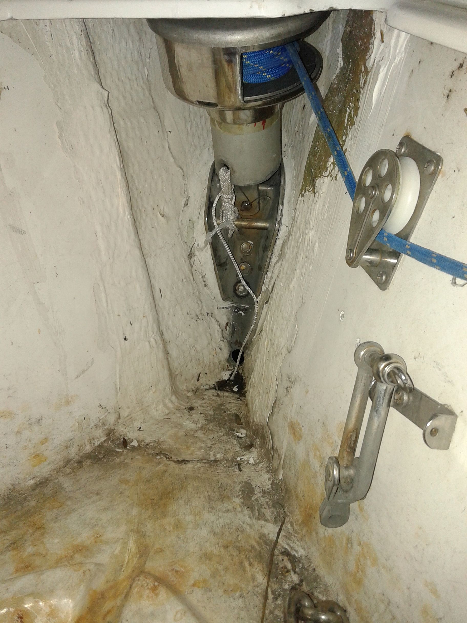

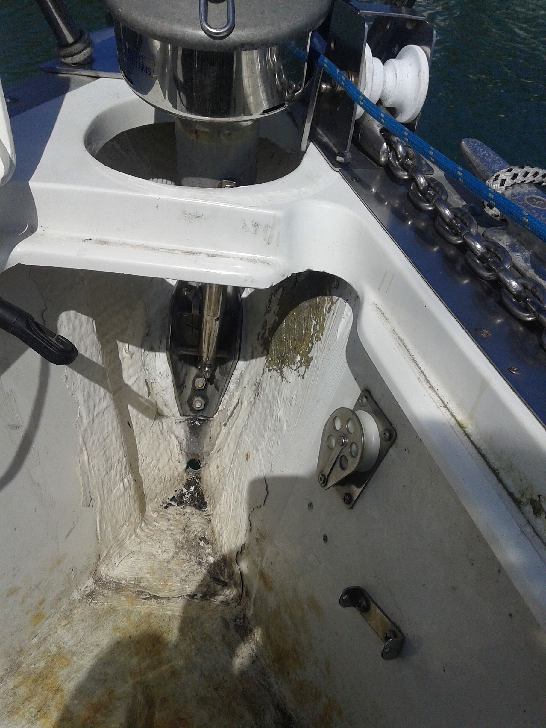

We finally finished the project. We have about 9 in mast rake (fine tuning to commence), fixed the drum-turning issue and in the mean time the drum got above deck level which is in my view a much better arrangement. Thank you all.
