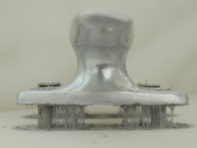

O'Day 28 flange leak into the starboard quarter berth area. Occasional drip for years now too much and needs attention. Pull all three bolts, lift flange and Life Caulk the outline of the flange, plus the bolts or is there a smarter technique?

Take a look at this thread entitled "stanchion sealant" and in particular post #2 by Maine Sail and second thread by Compass Marine on rebedding deck hardware. According to the last thread you need a caulk that's very elastic and will take the movement that stachions take. LifeCaulk and 4200 are reportedly good caulks but do not have the elasticity of butyl. Others in the forum might have other recommendations.
