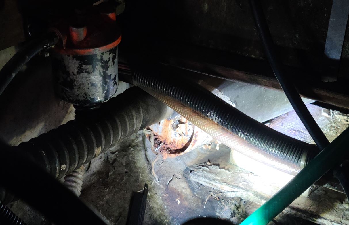

I looked at the muffler for a a drain plug and found the muffler in a pretty bad state of rusting.
From what I understand, if an engine is at or near the waterline the exhaust needs a 'water-lift' type muffler.
The muffler in the picture, which is the original type I think, doesn't give me the impression it's a water-lift type.
I thought that the exhaust hose needed to be looped about 2 feet above the water line. The highest point in my setup is below the cockpit sole. I don't think that's 2 feet above the water line.
And the thru-hull is below the waterline, which is strange to me.
All this, a non water-lift muffler, short loop, and thru-hull below the waterline gives me the impression this setup is just asking for water to back up through the system.
RoyS
Jun 3, 2012
1,742
Get rid of that ASAP. Doubtful that is a wet exhaust marine muffler. I have been wrestling with a similar issue in this forum after recently getting water back into my engine from the exhaust. My exhaust is like yours with a below the waterline exit and a hose loop that is about 9" above the waterline. More to follow when I am more certain about what to do with the entire exhaust design on the Cherubini H33.
RoyS
Jun 3, 2012
1,742
Here is a waterlift muffler that is about the same size as yours. It is made of fiberglass. Centex 1500042.
