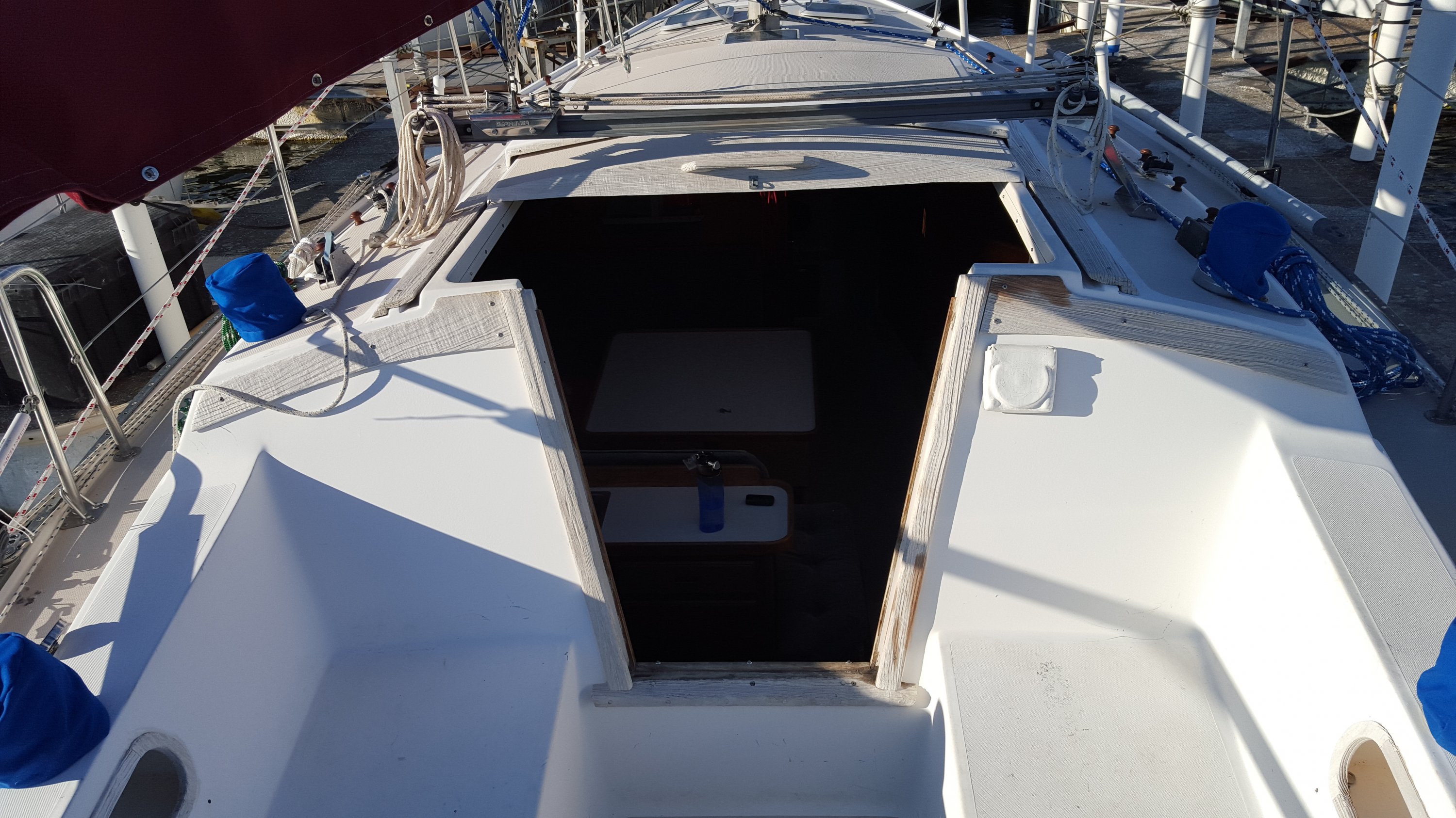

On Sirius 21. No winch with standing block at mast

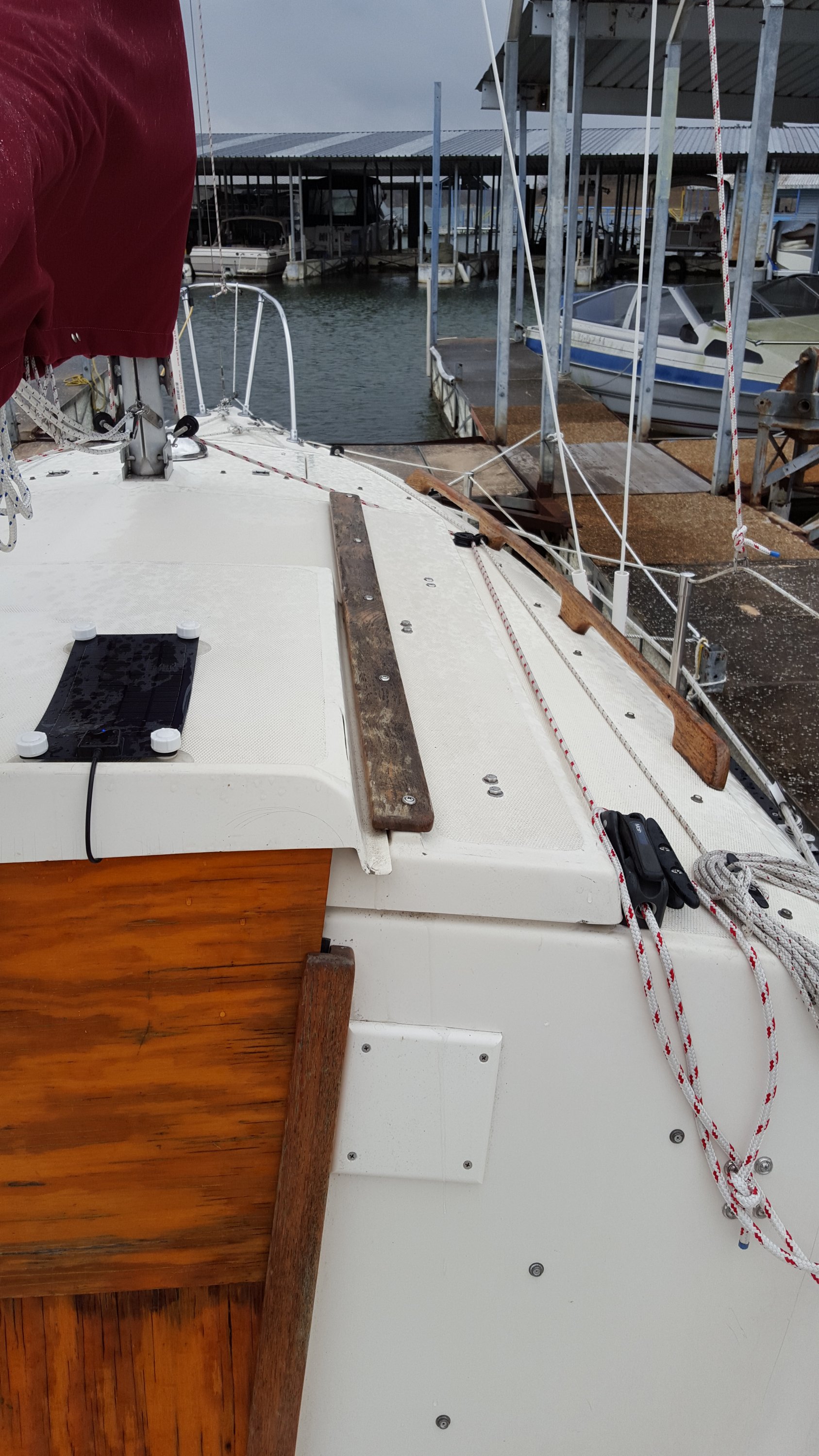

Winch on C-30 with clutch in front of it.

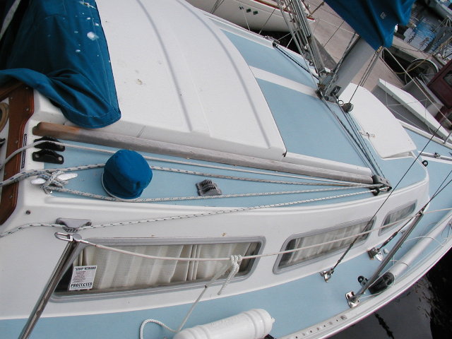

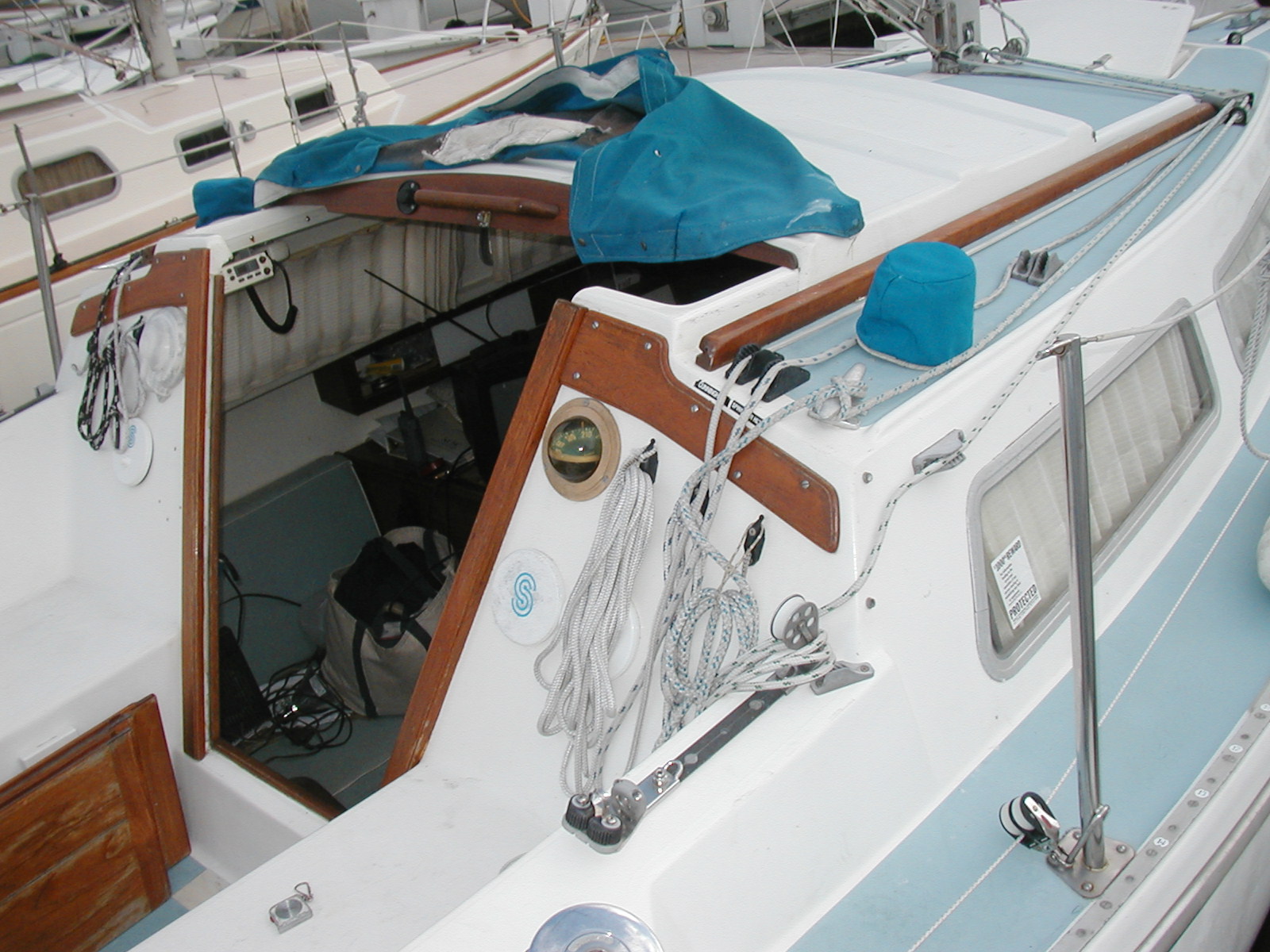

Here's some old pics from my boat about 15 years ago and is similar to the factory set up from the 70's.... there's new winches, cleats and hardware now... but if you're on a budget I would set it up like this... yes, you can add a stand up block at the mast. an organizer then back to the winch.. If you're just going to set up the mainsail halyard it is customary to lead it to the starboard side... the headsail halyards would go down the port side. My suggestion is to mount the winch as far aft as you can .... the cleat or clutch will be a foot or so in front. In the picture the winch is a bit too far forward.. When I re organized I move the winch aft and installed clutches.... My suggestion for a halyard winch, depending on you budget is a size 14 to 18... Self tailing if you can afford it... two speeds are rare now in the small sizes... so if you need more power invest in a 10" palm grip winch handle.
