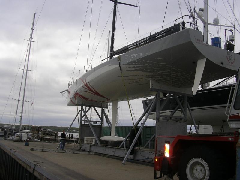

I like the Dragon on the bottom of Beau Ceste, nice bottom paint. I didn't get a good shot of the traveler but a nice shot of the open transom. Need a few more zeros in my IRA to buy that one.
