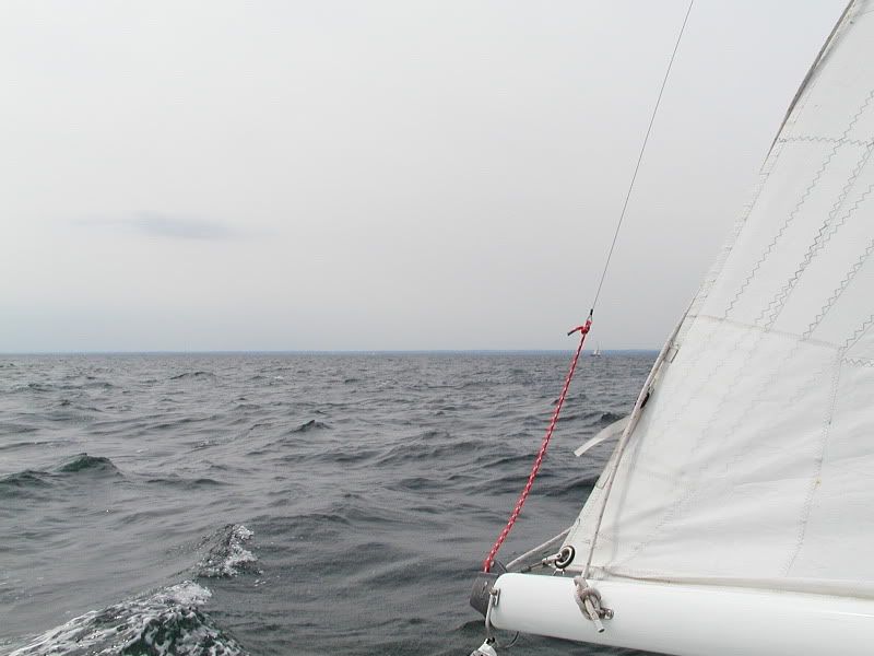

I thought that this is how the reefing should be layed out, however, upon putting in a reef this past week I felt that there was way too much belly in the sail and no real way to remove it. This is because the tension is straight down rather then back, so I obviously have something screwed up. The bail that the reefing line terminates in seems to be too far forward, but the bail on the opposite side is even further foward and is obviously for the second reef.
Needing to move the outhaul to the reef cringle seems to defeat the purpose of it being easy. Perhaps the cringles on the new main are further aft than on the original one and I need to move the bails aft.
Thoughts?

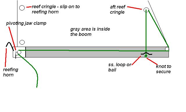

I believe that you have found the problem in that the reefing cringles are in different places on sails. I don't even use the internal boom reefing and prefer to run the lines on the outside of the boom and can install all hardware to fit the sail. Not as sexy but is just as simple and you can achieve a better set in my opinion. I believe you will find this more true with aftermarket sails which may have a shelf built in.
http://www.victoriayachts.com/vicsite/jifyreef.html
Simple example above.
23,518
Let's make this esay and do-able
Just move the ss bail or loop on the port side of the boom aft to a point 45 degrees aft of the reef point cringle when it's up. Looks to be about halfway back to the end of the boom, maybe a tad more.
You're Done.

Put another eyestrap 5 or 6 inches further back, and use the current one for the second reef. There's just not enough backward tension when the end of the line is vertical like that.. My buddy's IP 31 has exactly the same set up and it doesn't work for diddly... no tension on the foot. I said something to him about it but not sure if he took me seriously.

I have the same system as kenyon built my mast/boom and IF your running the reef line through the reef point and back to the pulley it gives you 2:1 BUT still requires luffing the main to get the sail flat
I also run the line down to a block by the VANG which allows a MUCH better pull on the line while allowing you to stay close to the locking cam
As Joe points out the only issue can be the location of bail

I have exactly the same system and it works great. However, I had the clew cringles on my new sails installed 4" above the reef line. The sails that came with the boat had been modified to raise the cringles about 6". This may be essential to getting the system to work well. If you can't have the cringles moved, relocating the eyestrap aft will help.
Speaking of the eyestrap, it should be located near the boom track and the line run under the boom and around so the eyestrap is relieved of some of the strain.
Unless you are racing, it's pointless not to fully ease the sail when taking up on the reef pendant. Don't forget the topping lift. Over topping the boom will make it much easier to flatten the sail.
Having the reef pendants just come out of the boom won't give you enough power with this system. I have a long shackle for the lower boom vang attachement and a block shackled to each side of it. The pendants go through these blocks, turning blocks on deck, and then back to rope clutches on the cabin top. This lets me pull standing in the cockpit where I can get plenty of flattening power. I also have a winch handy that I have occasionally used in very strong winds for the first reef.
Remove the silly lever cam cleats on the gooseneck fitting. You can also just remove the springs. They just make letting out the reef a pain. This system only works well with pendants led back to the cockpit so there is no point in having the cams on the gooseneck.
If your gooseneck is the older style without the cover plates to keep the pendants from popping off, be sure to get them from RigRite. They are essential.
I wouldn't convert my boat or yours to an all external system. It's nice to not have all that gear on the side of the boom and not having to haul pendants from the cabin top or forward is a safety factor. I still have my main halyard at the mast an use the gooseneck reefing hooks though. I don't believe in halyards led to the cockpit for singlehanding but that's another subject.

It could well be that he has used the second reef ss bail point for his first reef.

Thanks for all the replies. Just to clarify a few points. My boat has the reefing lines led aft, so can I use the cabin top winch to tension the line. The cheek blocks the PO installed are pretty wimpy though and were poorly mounted. On was distorted and literally falling off the mast. I did the use the correct bail for the 1st reef, it is just apparently too far forward for the new sail. I didn't run the line under the boom to relieve strain on the bail, but that sounds like a great idea.
