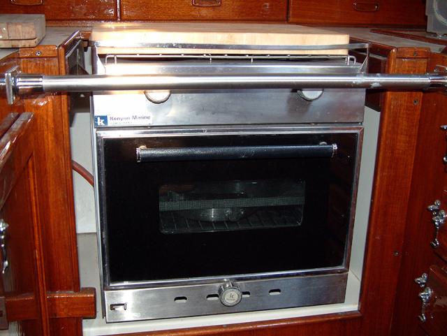

Hi all,

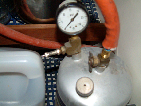

I have a 1983 37c with a kenyon kerosene stove and oven. I need some help in getting it operating again - it has an external tank - is there an easy way to tell how much kerosene is in it - suspect I may have to use a "dipstick" of some sort. I tried to pump it to get some pressure in the external tank but the pump did not seem to work - is it essential to have kerosene in the tank to pump in some pressure? Any place to get a replacement pump - it threads on a fitting that looks identical to a bike tube valve - got an old manual from kenyon today but they did not have anything on their external tank.

Congrats on perservering with your kerosene stove. I have same boat, same year and same stove. Personally I love having a kerosene stove and cabin heater, but most here on the forum would not agree with me. The peace of mind of not having any explosive fuels on board is enough for me.
You do need to have some level of kerosene in the tank or it will take forever to pressurize it. Imagine pumping up a car tire with that pump versus pumping up a bicycle tire...
The only way I have ever found to get the leve of the tank is to use a dipstick (piece of 1/4" wood dowel in my case). remember that the dipstick will go in at an angle (on my tank anyway) so there is less kerosene than is indicated. If the tank is nearly empty, you might consider removing it and giving it a good cleaning. Kerosene and diesel tanks get pretty grungy over time.
The tank should be pumped up to between 10 & 15 PSI (need a working pressure gauge). The whole trick to these stoves is to religiously preheat them. Fill the the cup below the burner with alcohol, methanol, etc. A small used dishsoap bottle or similar works well as a dispenser. Light the alcohol and wait for it to burn out completely. Try to keep drafts away, as this will affect the preheating. As soon as the alcohol flame is out, turn the burner knob all the way to the left (anticlockwise). This will bring the "pricker" up into the burner nozzle orifice and ensure it is not blocked with soot, etc. Then immediately turn the knob 1/2 way to the right (clockwise) while applying your lighter or match to the burner. It should light right away and burn with a hot blue flame. If the flame is yellow and sooty, the burner was not preheated enough and you have to shutdown, wait for it to cool enough to safely refill the alcohol cup and start over. I have used a butane torch to preheat the burner underway, when it was too rough to keep alcohol burning in the cup. The trick with the torch is that it always takes longer than you think to get the burner up to temperature.

can you use a regular bicycle pump for a "schraeder valve" to pressurize the external tank
Hi,
thanks for the very useful advice - love my boat - does yours have a taylor kerosene heater as well?? Ultimately need to get that going as well - question I have is for the kenyon external tank - the hand pump I have doesn't seem to be working well - the valve attachment on the tank appears to be like a achrader valve on a bicycle tube - most bicycle pumps today "clamp"on to these valves versus screwing on - since I have been unable to find a replacement pump from kenyon what do you think about trying a bicycle pump>? My tank does have the pressure gauge.

I sold my Kenyon recently. It sat in the garage for eight years. I could have gone and tested the bicycle pump theory. It should work well though. Any good floor pump will have a gauge as well. You can check that the tank gauge is working. You are correct, the pump head will clamp on, not screw on. That should not present a problem.
1,091
Bicycle pump - yes!
Jim, a bicycle pump or any other type of pump that will connect to a schraeder valve will work and you don't need much pressure - a pump that will make 20 PSI should do.

The bike pump with the clamp works just fine. I bought a big blue foot model from Can Tire and it requires fewer pumps. ( I kept it on the counter and didn't use my foot.

Thanks for the advice - a bike pump with a schraeder valve capability works great - pumps the pressure up in the external tank with 3 or 4 pumps. Using synthetic kerosene - no smoke- burns very clean. One burner working great - heated up with alcohol in pan below the burner. The other burner gets heated and almost kicks into a blue flame but it is blue green with yellow and then doesn't ever go all blue. Appears to be working but I am not getting quite hot enough - will try again heating with alcohol and then with a torch and see what happens.

The alcohol stoves have a single post which bolts to the stove top and through which the alcohol is fed. The kerosene one has a Y shaped post and the burner is much harder to take apart. I bought my boat (1982) with a kerosene stove but found the invoices etc. on board indicating the original owner had opted for kerosene and the dealer had swapped them out.
