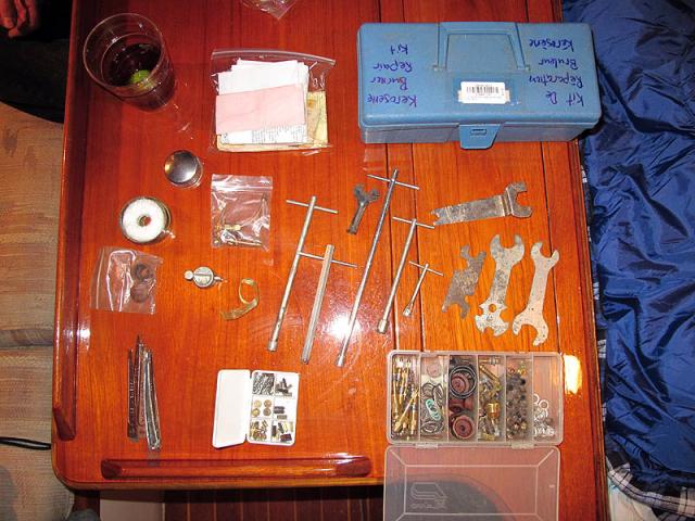

I tough I would share the my joy with you guys :), I found a box full of repair parts for my patria burners, all of it for 20$, looks like my kenyon stove will be in working order for the next 50 years or so.

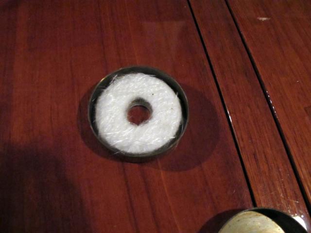

Also Jim, in the box there was a circular wick, I believe it's made to fit exactly in the burner's cup, I have not tried it yet, but I'm sure it solve the problem of fuel spilling all over the place when the conditions are rough.
If some people are interested, I have the instruction sheet on how to put the burner toogheter, I could post them. Also, in one of the papers that was in the box, they mention that newer packing are made of copper instead of asbestos, maybe someone could have some machined...
